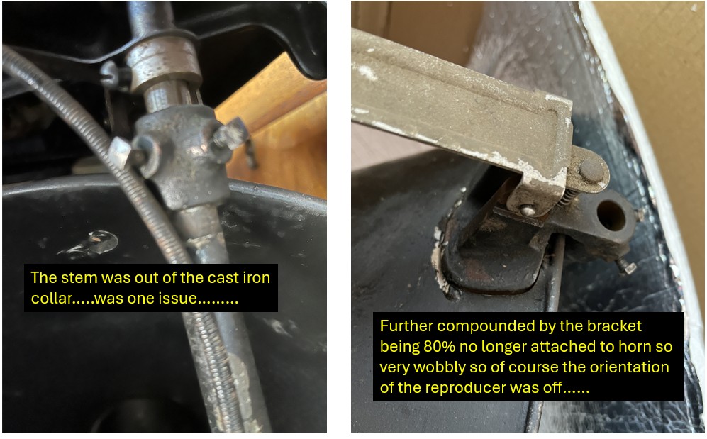

The weather finally cooled down enough to work in the garage again. I removed the horn from the machine and in addition to the horn stem being out of the collar the collar itself was only about 20% still attached the outside of the horn and very wobbly so of course my reproducer was not going to end up being in the right orientation. So, root cause of my issue is now understood:
I got lucky and found a replacement horn assembly on eBay that had good gold plating and the Duncan wire on it so simply bought it and installed it and everything is perfect again. It was about the same price as a new propane tank, flux and silver solder (very expensive these days). At some point I may pursue repairing the original horn.

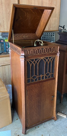

A happy ending and a nice C-250 that can move to the inside of the house soon:
C-250 Phono.jpeg (51.56 KiB) Viewed 1822 times
Thanks to those who offered advice on this topic. -Dan-
