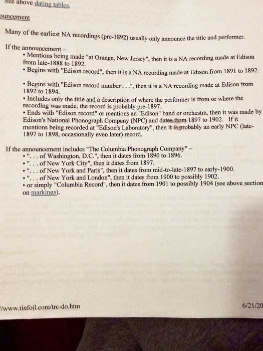

Greetings. Most of my brown wax cylinders did not come in cases (or at least not their original cases), making the Columbias, at least, hard to date. I understand that you can determine a date range for Columbias based on the located cited in the opening announcement; for instance, George P. kindly posted, in response to another query of mine, that Columbia started using "New York and Paris" in their announcements in 1898, though I don't know how long they continued to do so. When did they just use "New York"? I also have at least one or two that say "Washington," which I assume are the earliest, but I don't know the date range for those, either. Can anyone educate me?

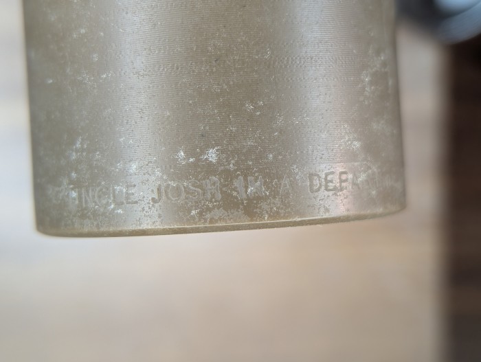

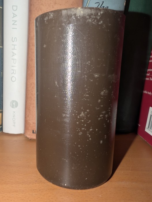

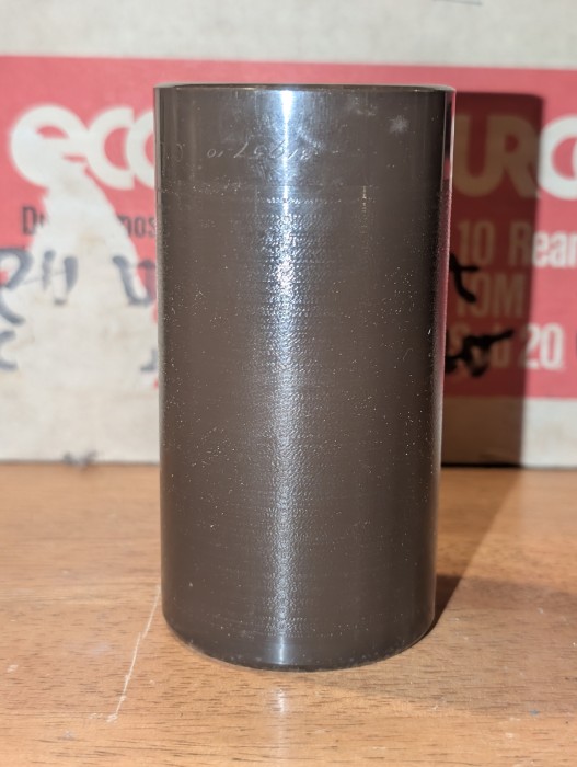

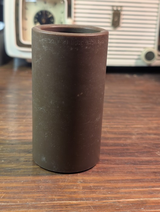

Now, on to my main questions for this post. While most of my brown wax cylinders look more or less like the one in the first picture (which slight variations of shape and greater variations of color), a relatively small number of my them look different in that they have the title inscribed on the cylinder itself, as you can see in the second and third pictures. I assume these are Columbias, as I have black wax Columbia cylinders that look very similar to these; and I assume they're late brown wax for that same reason. Are both assumptions correct? If so, what years would these be from, approximately?

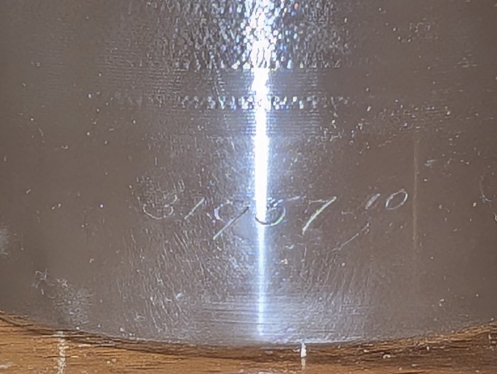

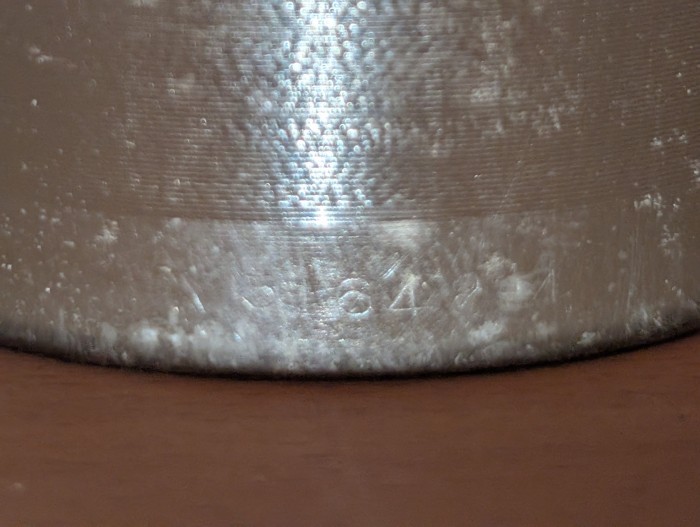

A couple of people have messaged me asking if I could post pictures of a couple of the dark brown cylinders I mentioned in point #2 of the original post. Here they are. The first is numbered 31957, which is dated (by one source) 1902. The second is numbered 31648, dated 1901 by the same source. Curiously, both have superscript numbers after the catalog number -- for 31957, as you can see, it's 10, and for 31648 it's 7. Would this be a designation that this was the 7th or 10th cylinder to be recorded off the master? I should note that neither of these has a song title engraved at the rim.

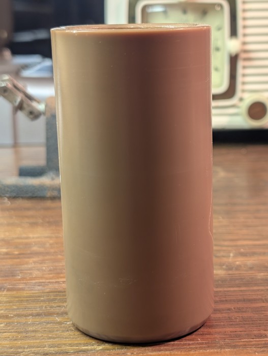

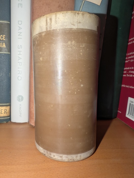

Finally, I have quite a few brown cylinders that look like the one in the last picture -- note the white stripes at both ends. What are these? I don't believe they're home-recorded blanks.

In response to another PM, both of the dark brown cylinders pictured above are Columbias.

If I recall correctly, the cylinders with titles in the dead wax were the first molded cylinders sold by Columbia, around 1901/2. They were recorded at a higher speed (@144 rpm?); the wax was superheated, for a harder surface.

Also, I should note that the brown cylinder with the whitish ends is a Columbia. I believe that others I have that look similar are Edisons.
Finally, a correction: My pre-Paris Columbia cylinder announcements say "...the Columbia Phonograph Company of New York City," not "...of New York." Anyone have any idea when those would date from? (I believe they added Paris in 1898.) And when did they drop the cities and just say "Columbia Records"?

Re: Later brown wax cylinders?
I've searched for articles on this subject, but have come up empty; if anyone has any links to share, I would appreciate it.
Thanks, Rich! Very helpful, indeed.
