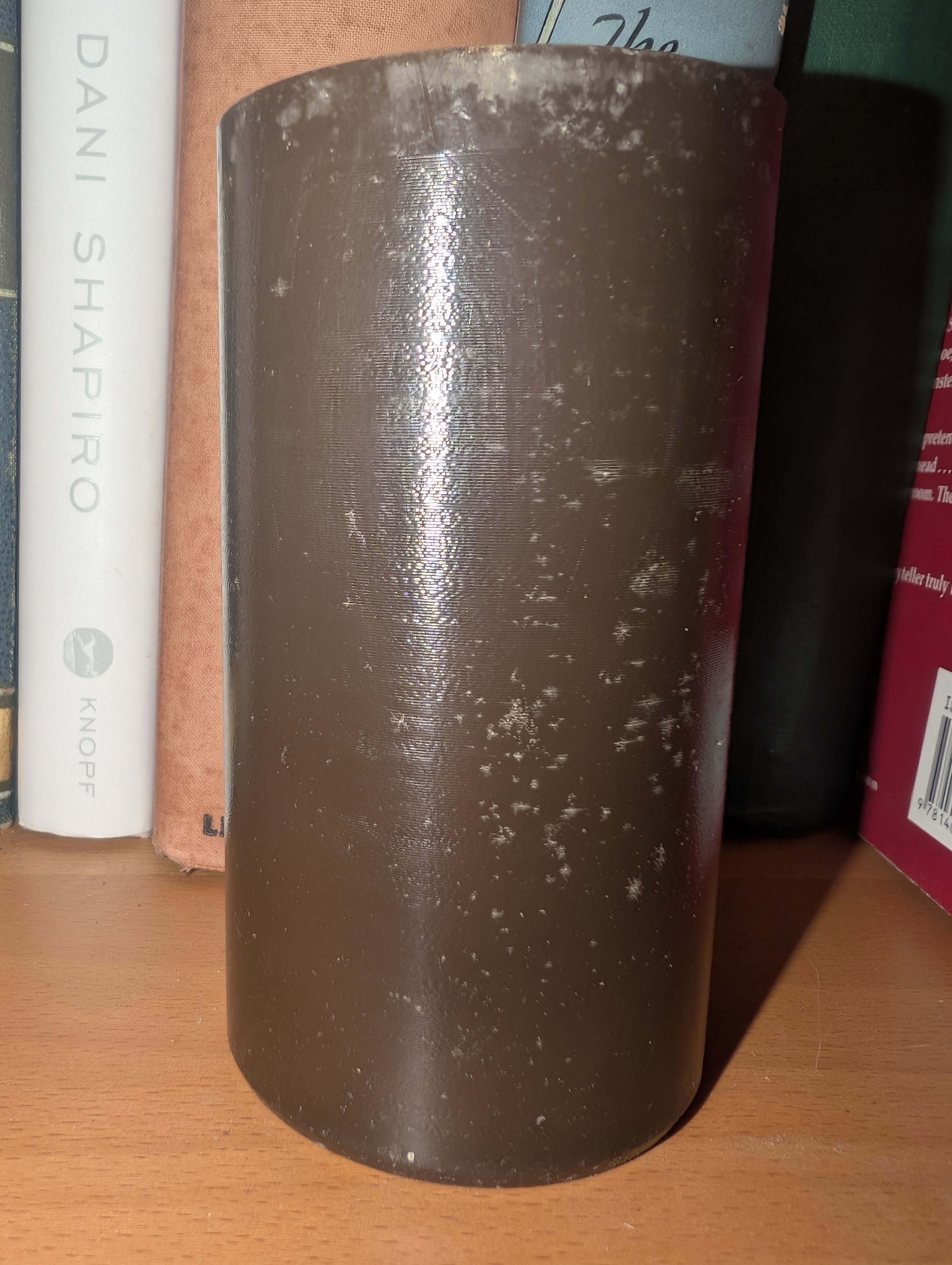

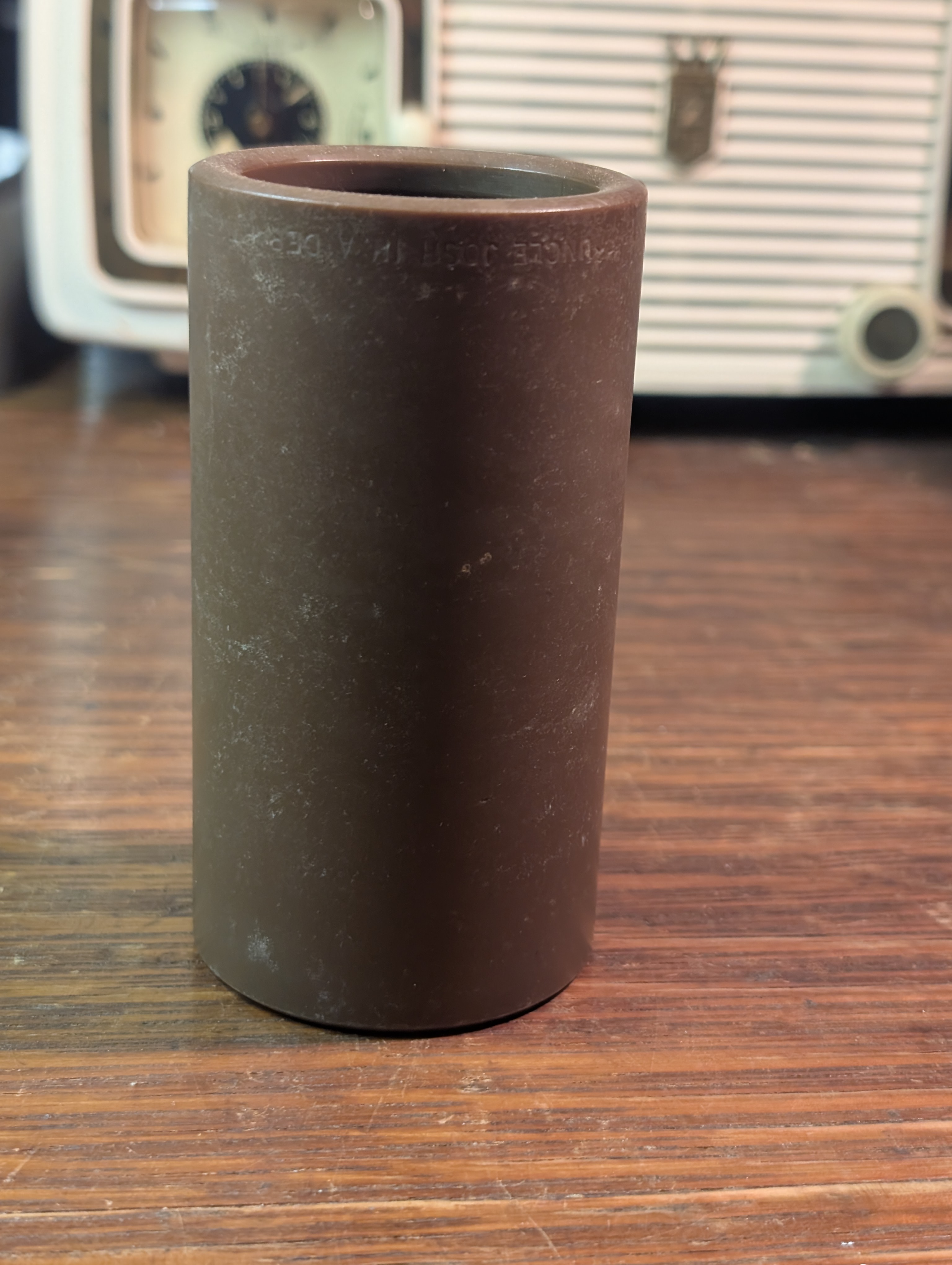

Now, on to my main questions for this post. While most of my brown wax cylinders look more or less like the one in the first picture (which slight variations of shape and greater variations of color), a relatively small number of my them look different in that they have the title inscribed on the cylinder itself, as you can see in the second and third pictures. I assume these are Columbias, as I have black wax Columbia cylinders that look very similar to these; and I assume they're late brown wax for that same reason. Are both assumptions correct? If so, what years would these be from, approximately?

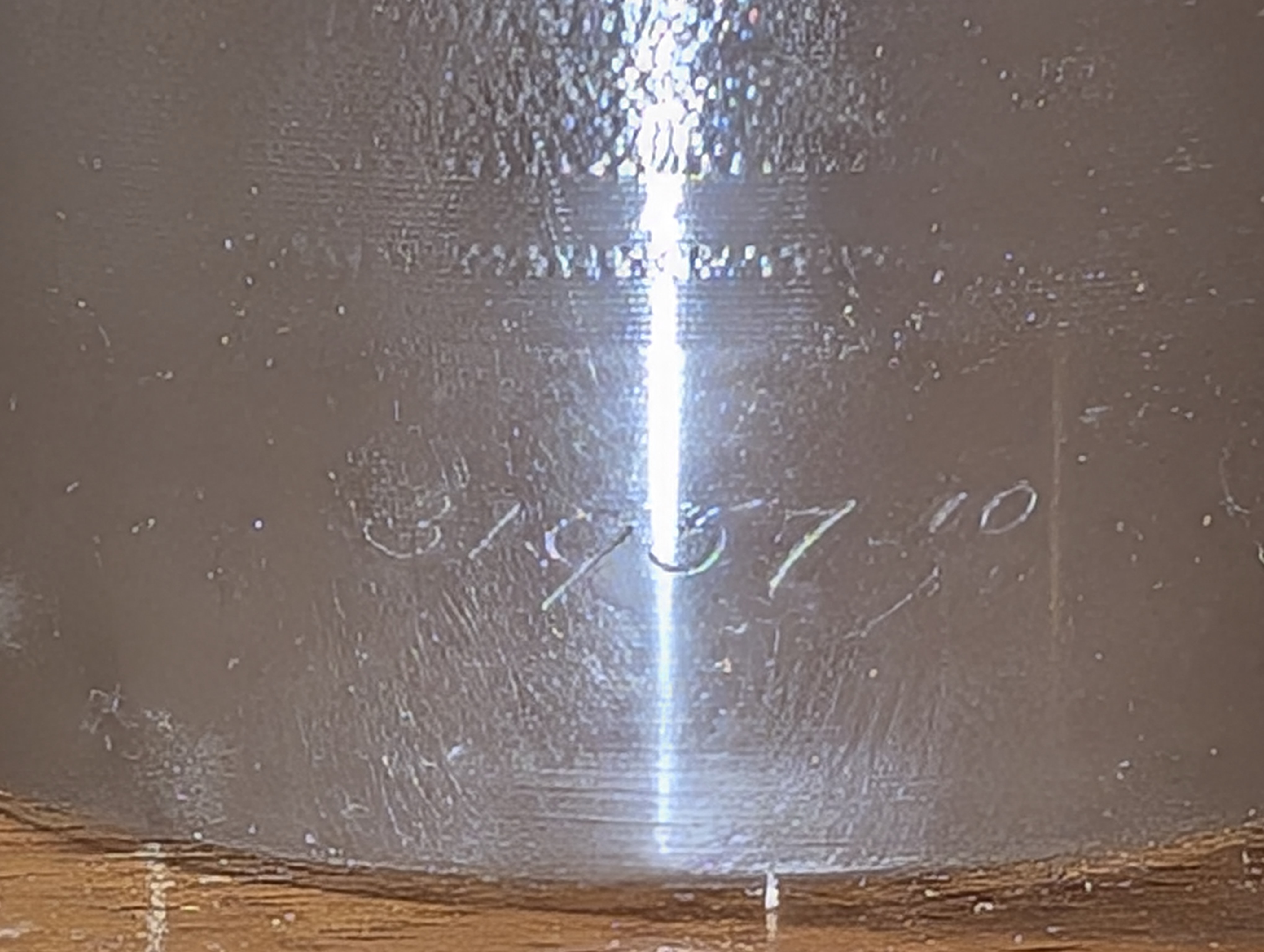

A couple of people have messaged me asking if I could post pictures of a couple of the dark brown cylinders I mentioned in point #2 of the original post. Here they are. The first is numbered 31957, which is dated (by one source) 1902. The second is numbered 31648, dated 1901 by the same source. Curiously, both have superscript numbers after the catalog number -- for 31957, as you can see, it's 10, and for 31648 it's 7. Would this be a designation that this was the 7th or 10th cylinder to be recorded off the master? I should note that neither of these has a song title engraved at the rim.

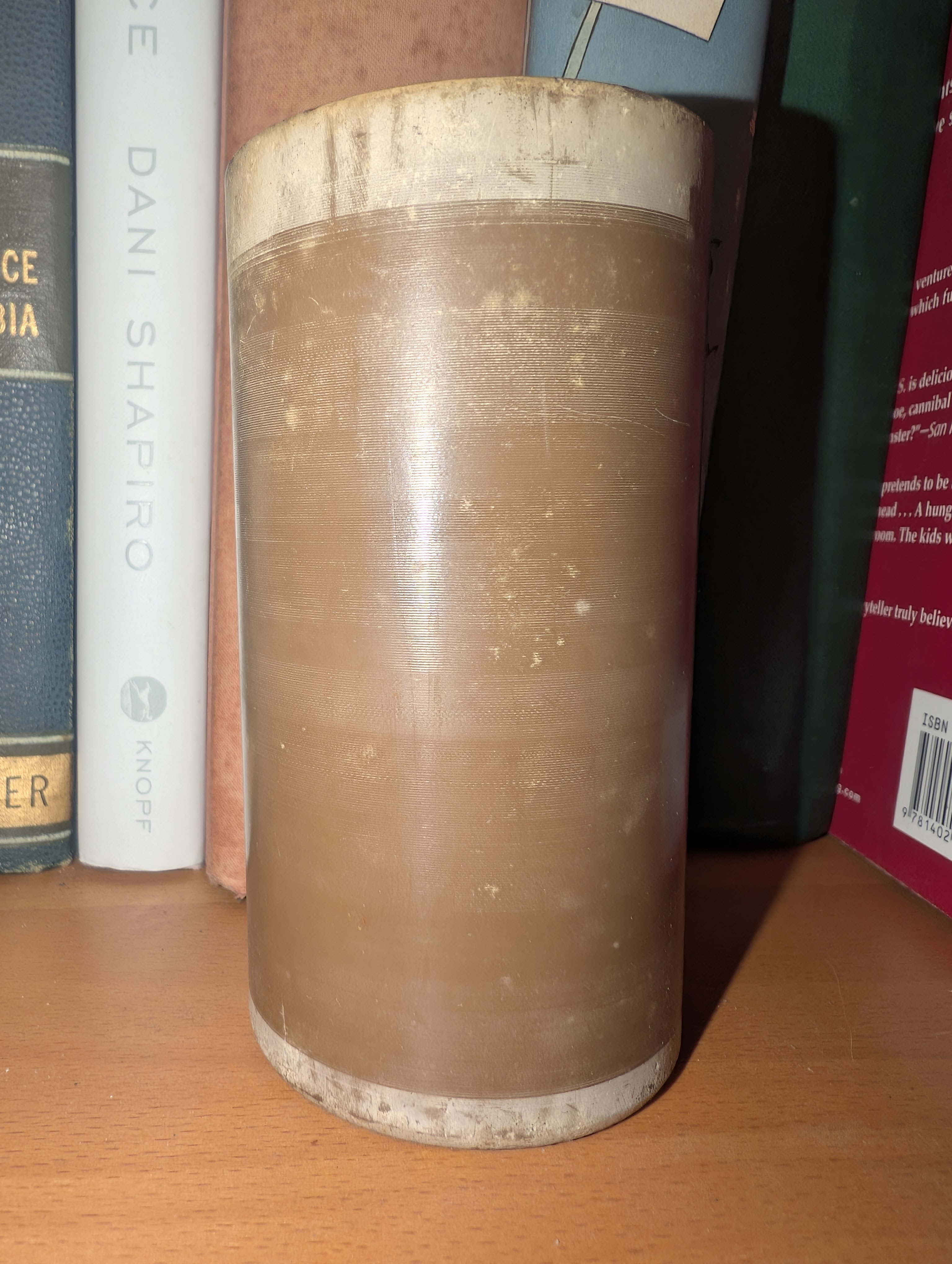

Finally, I have quite a few brown cylinders that look like the one in the last picture -- note the white stripes at both ends. What are these? I don't believe they're home-recorded blanks.

If I recall correctly, the cylinders with titles in the dead wax were the first molded cylinders sold by Columbia, around 1901/2. They were recorded at a higher speed (@144 rpm?); the wax was superheated, for a harder surface.

Also, I should note that the brown cylinder with the whitish ends is a Columbia. I believe that others I have that look similar are Edisons.
