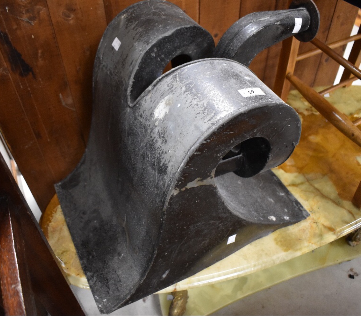

It certainly looks HMV. It might have been helpful if the auctioneer had put the dimensions.

It seems like HMV 157 model horn.

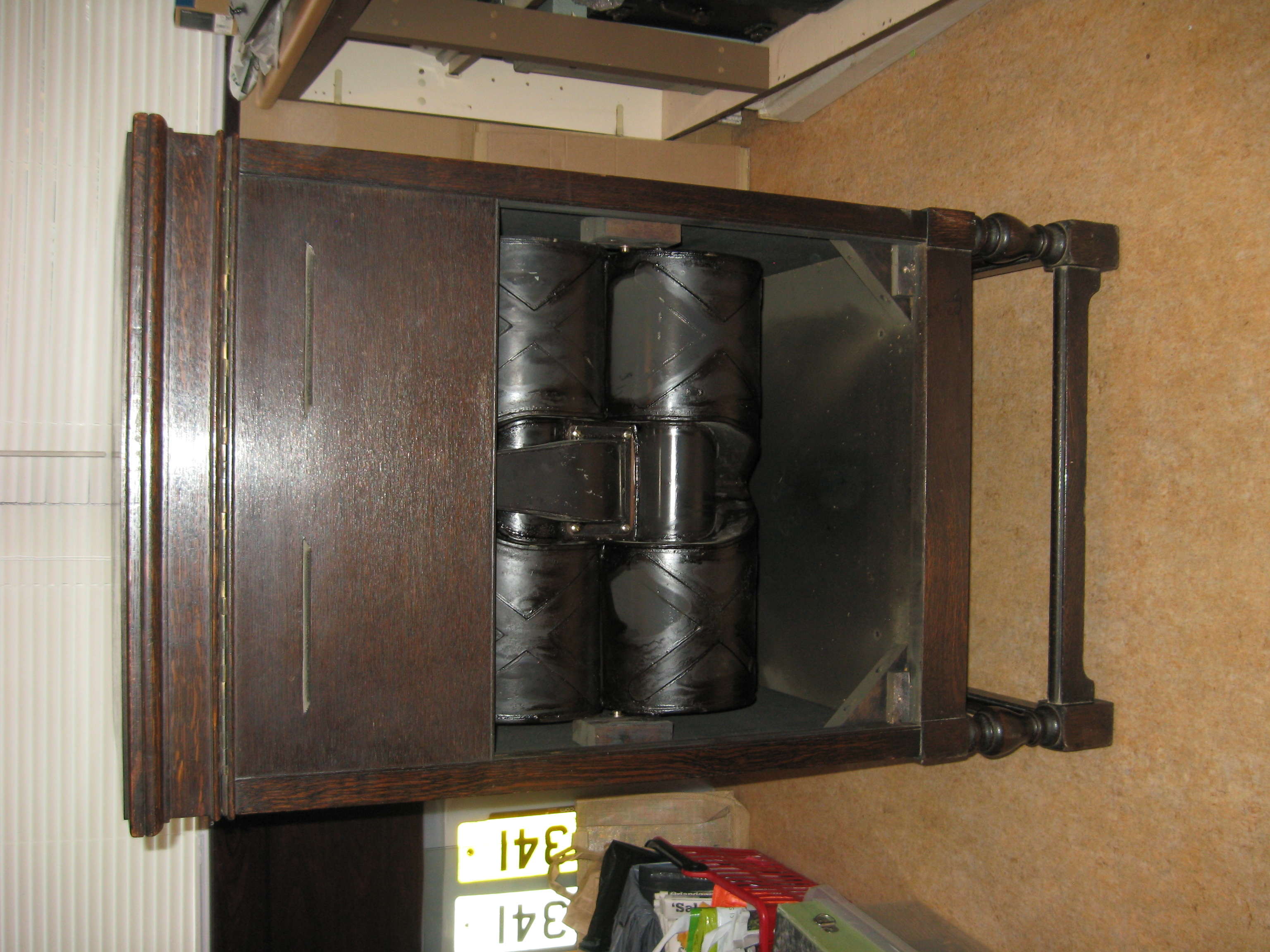

It is indeed the bifurcated horn from an HMV157. The rear of the full Re-Entrant horn in my HMV193 looks like this :

These days worth more in scrap metal value than as an original gramophone part! (the 157 horn)

If i had one of those surplus horns I'd build a gramophone around it. Their sound is very beautiful.

[quote=jamiegramo post_id=364736 time=1762431788 user_id=1043
[/quote]
This horn of hmv157 is a lot smaller than vv 8-8, 9 and 35's, but they look very similar. Hmv157's horn opening is 390x500mm=1,950cm2, vv8-8,9,35 horn opening is 3498.25cm2.
