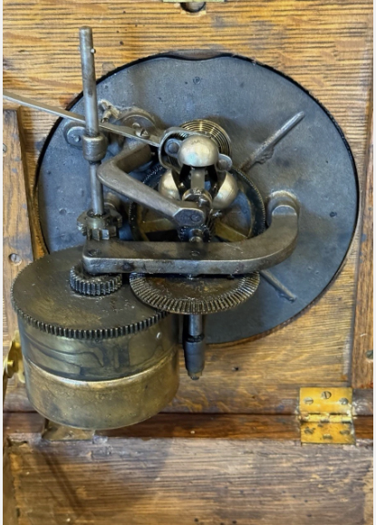

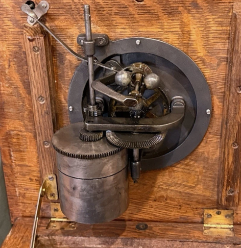

I could easily be wrong, but I believe that the difference is that with the additional spring barrel, the D motor simply has a longer support bracket to accomodate the extra width of springs.
EDIT: As I predicted, I was easily wrong... I looked at some on-line images and it appears that the D & M motors are indeed very different. At least when comparing a "fancy case" M to a later styled Victor D. (Later styled as in resembling a Victor V)
