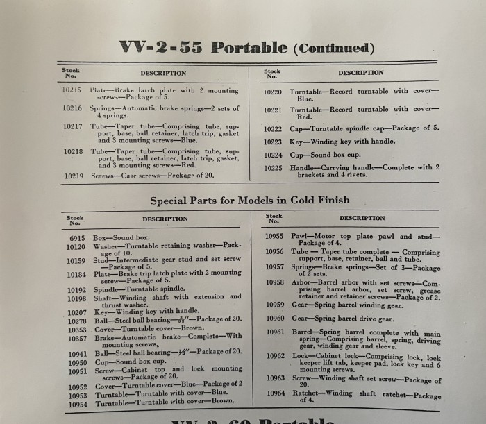

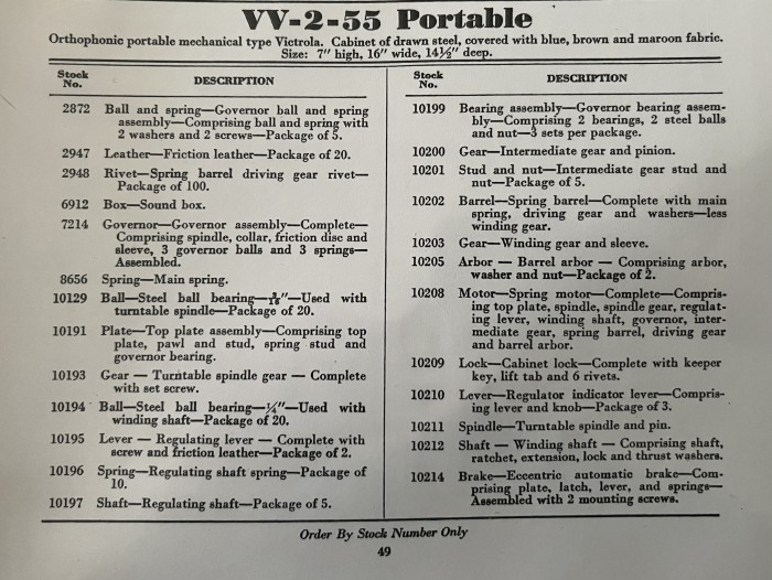

Life gets in the way sometimes but it is always comforting to have something to look forward to.
Here is the 2-55 parts listing. Notice that the complete spring barrel assembly was available as well as the spring and rivets separately.
This may not be a comprehensive list. When the RCA published this it included only the parts they still had available at that time. Other Victor model parts listings when this appeared (early 1930’s) had severely truncated listings.
Mark
