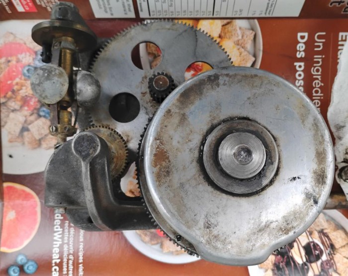

I have not had much time to look at this issue at all. But today, I did.
I tried a different technique for cleaning the motor before removing the spring drum/barrel, well ... at least a technique I have not seen discussed here.
I took the motor to my mechanic whom I had to visit anyway and asked if he could put it in his parts cleaner.
He did not think that this was a good idea, but he did propose something else, spraying the motor with brake fluid from a small pump equipped plastic bottle and blowing the fluid and dissolved 1920s grease and dirt off with an air hose.
He had one of his junior mechanics do it. It took very little brake fluid and very little time, about 5 minutes.
The motor is not entirely clean only because I said it was good enough for my purposes at the point we stopped--this was being done for free and was interrupting his work on someone's car. The young mechanic would have continued if I had asked.

However, I am not concerned in the least about this particular motor. It would require an enormous amount of work to restore it to good working condition--bushings for the spindle (and perhaps elsewhere) and probably plating and re-machining of the spindle shaft (and perhaps others). The motor has a lot of slop with wild platter wobble, and it makes horrible screeching noises.
I do not have time at present for slow careful work with this motor. Dismantling the motor and removing and servicing the drum is only a practice run for repairing the spring in my good VV2-55, something I do not want to mess up.
