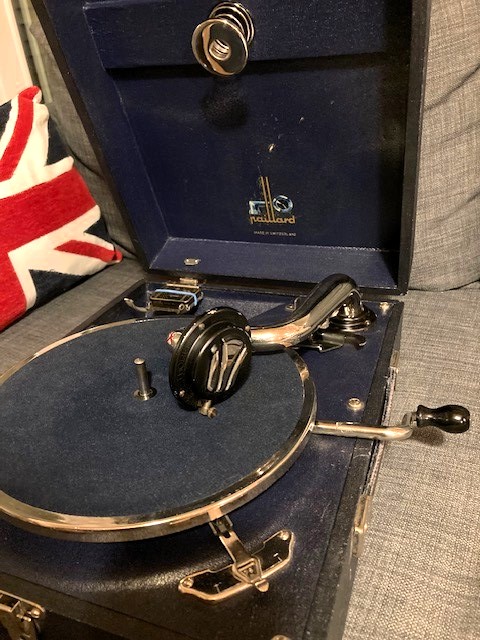

Another light machine with nicely balanced and not too loud sound is the Paillard 301 or 302. It is definetely bigger in dimensions than the Columbia 100, but even lighter. It is a more sophisticated construction than it seems, and well executed, solid, without any pot metal. The metal part of its horn is rather short and the sound is lead through a bent cardboard piece, but as this does not read too good, it works really well.
The original soundbox of the 301 (Maestrophonic No.18) should be avoided, as it is rather quiet and I did not see one having good sound. Its needle pivots have a bearing in rubber or early plastic, and as this might have worked properly when new, it is now hardened and swollen and restrains the movement of the needle bar.
I have a Thorens 100 soundbox on my machine(s), which makes a good combination with well-balanced sound. It is a little less loud and maybe not as full as the Columbia 100.

- Paillard 301 with Thorens 100 soundbox
- Paillard 301 1.jpg (88.93 KiB) Viewed 4887 times
- Paillard 301 2.jpg (105.1 KiB) Viewed 4887 times
