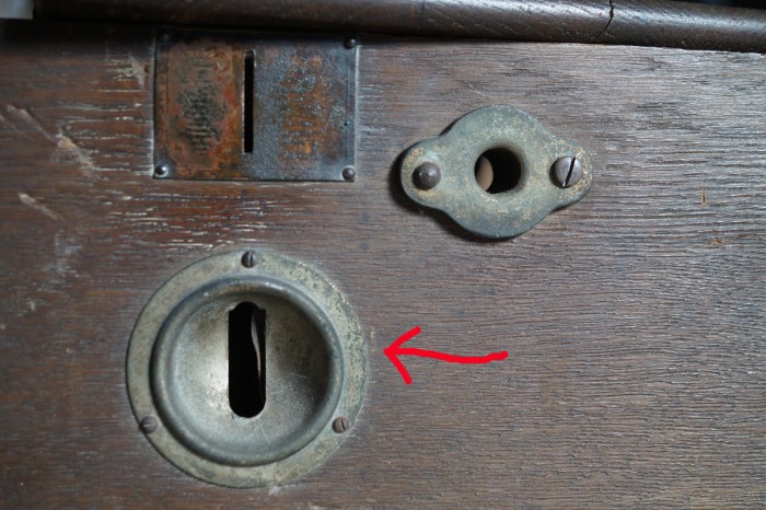

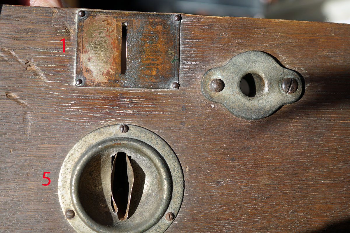

So, having had a look at the 'inner works' design and compared, there do seem to be some interesting differences. I wonder if this means that my machine is earlier / later than the 'top coin loading' ones or just a different design ? This needs to be looked at in more detail - a bit like finding an alien space-craft and attempting reverse engineering ha ha !
Any-way, here is my second 'What is this' question:
As shown in the following photograph, my coin op has a circular part below the usual coin slot.
It doesn't seem to be another coin slot though (too large an opening ?) - so what is it I wonder ? Maybe a 'token' instead of coins ?
Thank you once again for any help / ideas with this.

This looks like a bowl niche that likely would have a protruding lever to make the coin pass through the mechanism, something you move with a finger after inserting the coin.

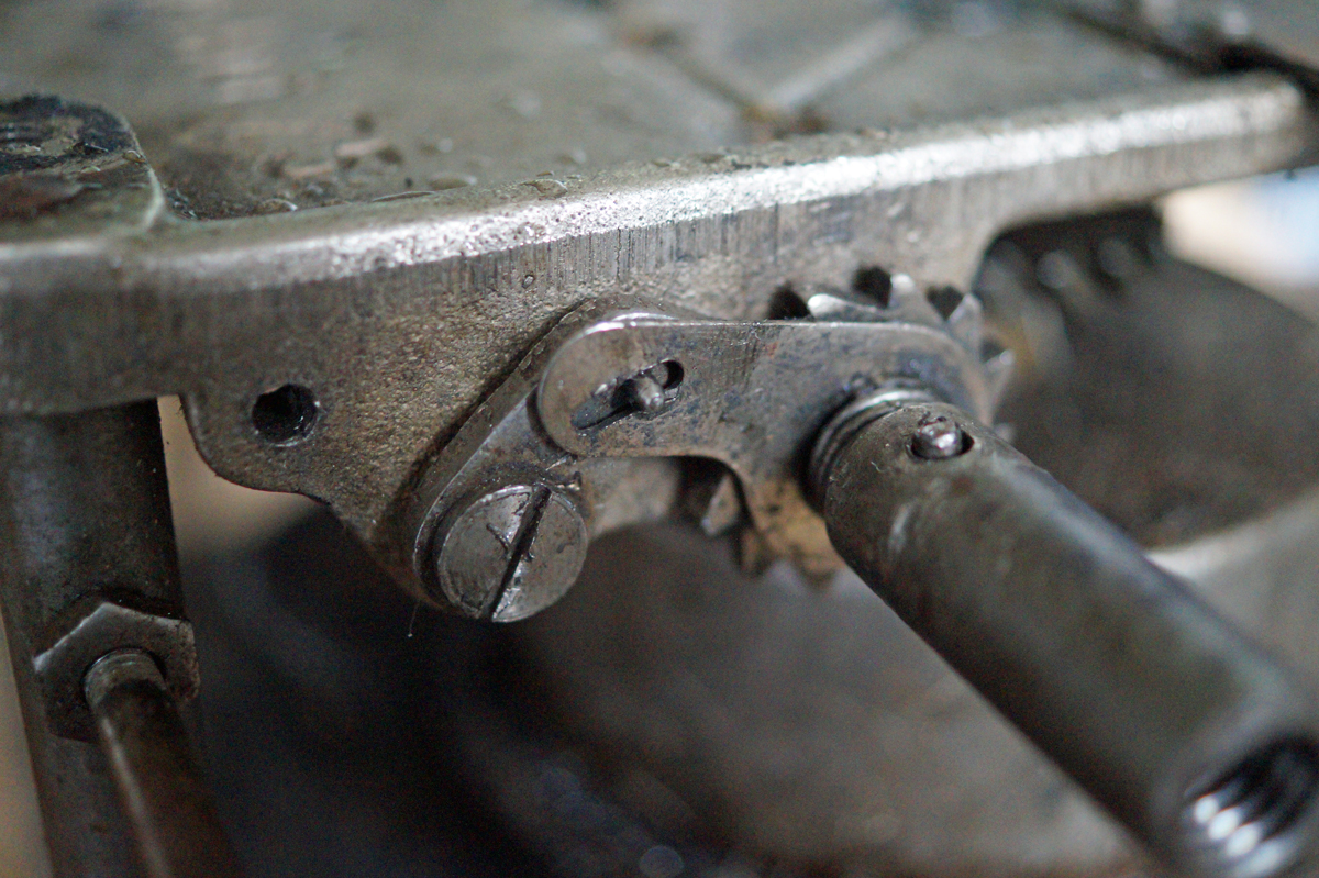

Also, if no-one has told before, the ratchet and pawl retaining mechanism looks like the Garrard system, and that would explain the pin:

Inigo wrote: Wed Feb 11, 2026 12:16 am This looks like a bowl niche that likely would have a protruding lever to make the coin pass through the mechanism, something you move with a finger after inserting the coin.
Thank you, Inigo! That is the device that I was referring to in my previous comment, but that I could not find the proper words to describe...
...it could be for a device that lifts the pawl away from the ratchet wheel during winding, then pushes the pawl down against the ratchet wheel when the crank begins to reverse. (This would allow the winding process to be silent) Honestly, it's a bit difficult to describe that style.

I can now see clearly how the ratchet works.

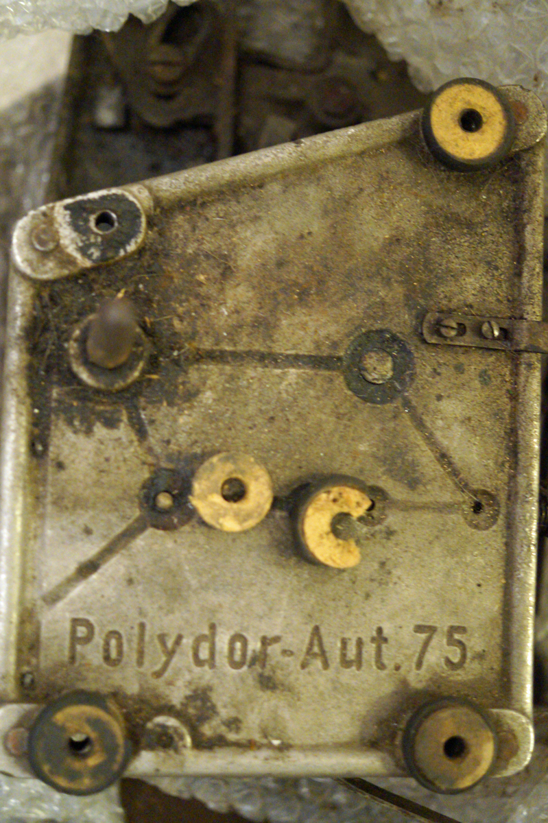

Also, although the motor is clearly marked 'Polydor-Aut. 75' (photograph 'below') if it could be a Garrard system / design then maybe there are many similar Garrard motors I can find with the same size 'parts' ? I could therefore restore this area using parts (cog etc) from these motors maybe ? Like maybe a Grarrard 10 or 1a ? I wonder .............. I have a spare Garrard 1a and others maybe.
I will investigate this then.
Thanks again Inigo and Jerry !

Well I had a look at one of my spare Gerrard 1a motors this morning and the 'non' return parts' looked like they were very similar.
The very good news is that all it involved was removing the parts from the Garrard and re-fitting them on to the coin op motor.
The parts (cog etc) seemed to fit perfectly - all they need is a good grease / oil later so they move more freely. (Photograph 'below').
Many thanks indeed to Inigo for mentioning how similar the parts were to a Garrard and 'putting this idea into my head'.
Oh, I see what you mean about the 'protruding lever' suggestion.
I need to see photographic examples though to fully understand and investigate further as to how exactly this (maybe unusual) gramophone works to 'piece things together'.

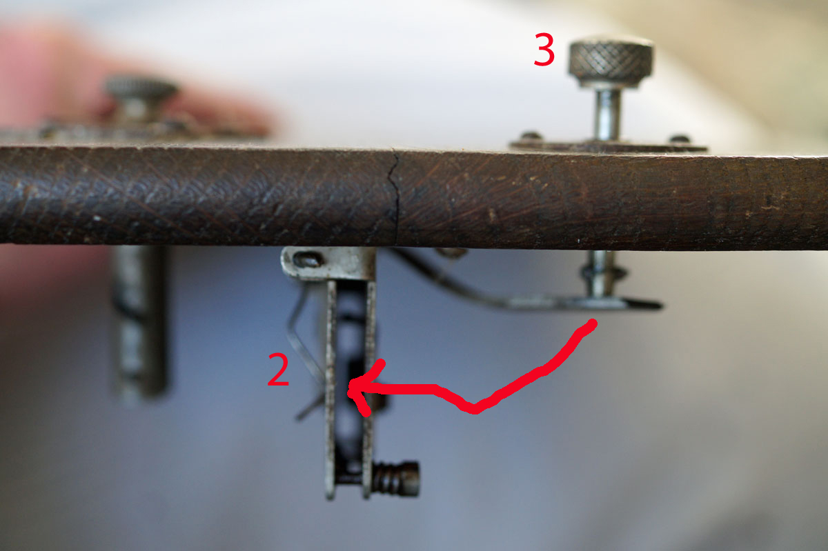

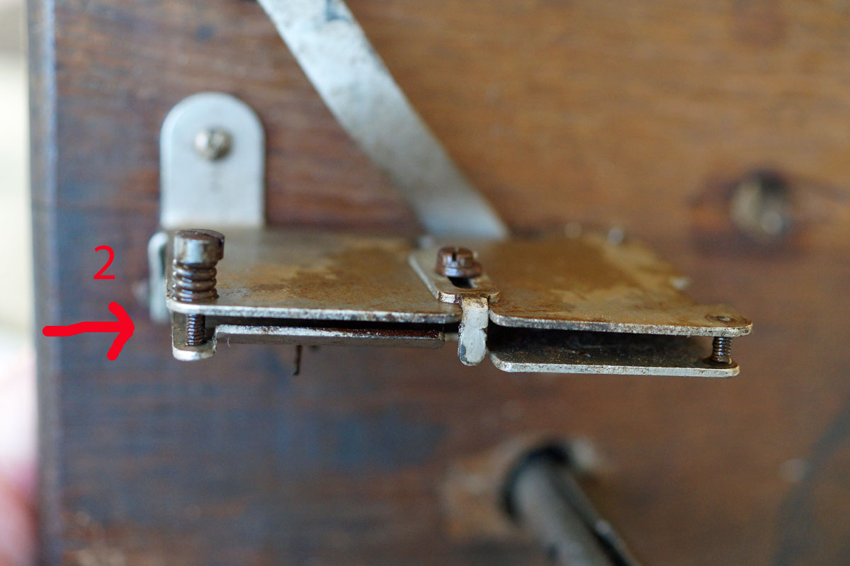

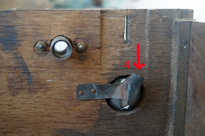

I had another look at the machine this morning and have a new theory about the 'protruding lever theory'.
I think it may be a simple method to return incorrect coins - coins which are not 10 pfennig ?
I wonder if it worked something like this (photographs 'below'):
1. Coin goes in here externally.
2. Coin enters here internally. This part widens when the coin is inserted and when part '3' is pressed down. (I don't know what part '3' overall purpose is by doing this).
There are two 'drop points' - the first one drops to part '4' (which returns the coin via a chute to part '5') and the second drops to activate the gramophone.
Maybe this then ? ...................................
