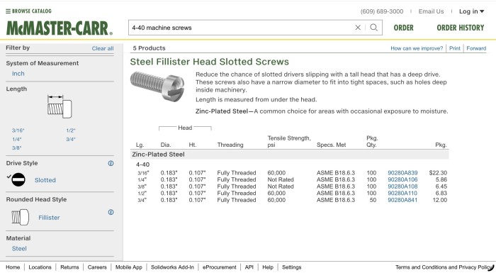

Don't get hung up on NC or NF. A 4-40 is a 4-40, is a 4-40... In fact, all 4-40 threads should be classified as NC. The standard fine pitch variety would be 4-48, and would be marked NF. I would really hesitate to purchase taps or screws from a source that advertises 4-40NF threads.
As to seeing some screws identified only by "#8 x 1.5", that would be the proper nomenclature for a wood screw, or a very poorly described machine screw. Actually, that kind of machine screw decription from Amazon, or a Chinese seller, would not surprise me in the least.

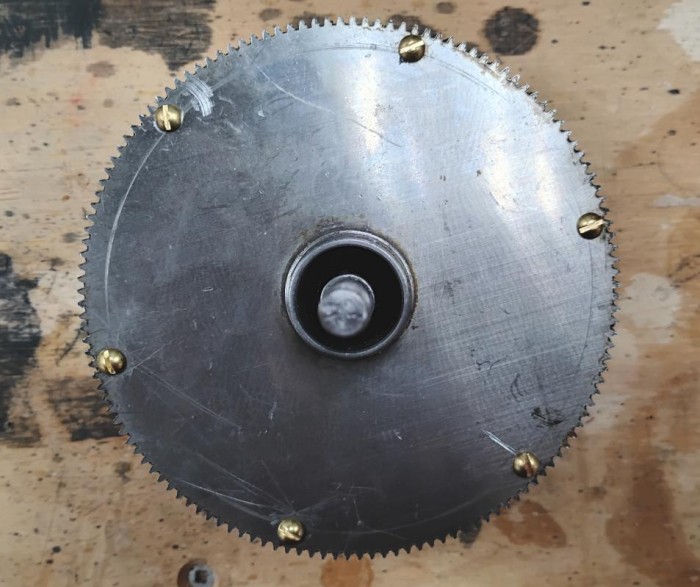

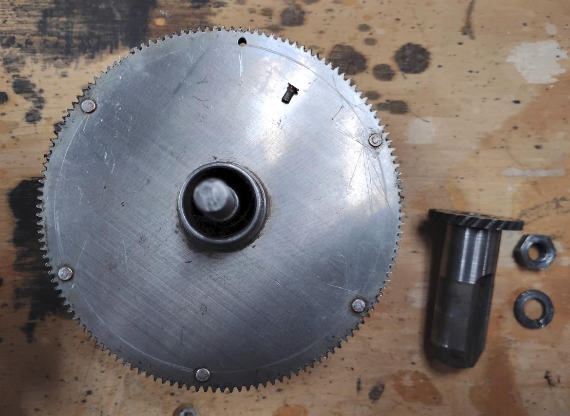

Well .... I have inched another short distance forward with this project. Thank you everyone!
I drilled out the rivets in opposing pairs from the drum side of the unit. The rivets did not go entirely through the metal of the drum, and there was a center-punched-like dimple in the bottom of the rivets which helped with centering the drill bit. Mostly very little of the rivets was drilled out before they spun and were pushed part way out.
Once a pair was drilled out, I tapped the pair of holes from the gear side of the side of the unit. I then put 4-40 slot head brass screws into the tapped holes from the gear side--this will be reversed later as the metal of the drum is very much thinner and softer than that of the gear plate. I then moved on to the next opposing pair.
I did not need cutting fluid or oil for tapping. There was enough residual grease left in the holes after the rivets were out.
I choose brass screws 1) because that was what was readily available in a round or pan slot head configuration and 2) because if anything is going to strip or become damaged by cross threading, it will be the brass before the steel, and brass is easily drilled out.
"Casualties?" you might well ask. Well, I did snap a 3/32" drill bit in the drill press. This was very surprising because it was in a drill press, the drill press was turning very slowly, and very little pressure was being applied. However, the bit was from what is probably my oldest index, and it has been used extensively with more wobbly handheld electric drills which tend to fatigue smaller bits. Luckily I have more bits.

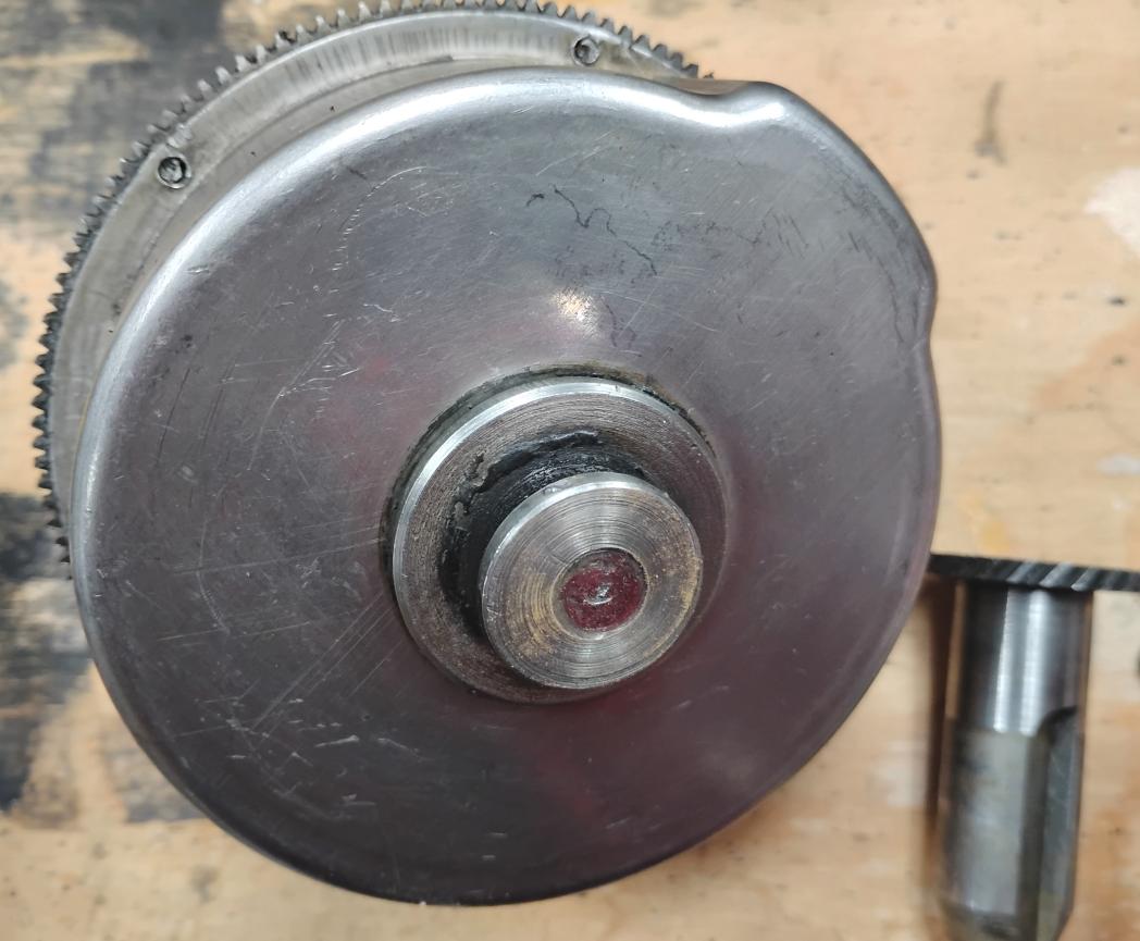

Patterns of wear in the VV2-55 motor are interesting. The gears all look to be in very good condition. Where there is visible damage is on shafts, sleeves, and bearings. Everything seems quite sloppy and there is a lot of scoring despite there being a lot of dirty waxy grease. Some bearings look quite out of round. It must have something to do with torque on the bearings and shafts.
Lah Ca
Posts: 1408
Re: VV2-55 Spring Question
Post by Lah Ca »
This will be of limited interest to expeienced members.
But those without extensive experience may benefit from seeing and having a reference as to which way the spring is wound into the drum.
My understanding so far....
The spring drum of the VV2-55 has central shaft, inserted from the bottom of the drum. The shatt is threaded at its top. and a nut and lock washer attatches to this threaded end to fasten the drum to the motor chasis once the drum is fully assembled. The gear plate, which enganges with the platter spindle in the assembled motor, goes over the drum's central shaft and is attached to the drum. Then a keyed sleeve, with a gear press fit to its top, goes over the central shaft and down through the gear plate. The keyed slot in the outside of the sleeve seems to match with a bend in the central end of the spring coil. The bend in the spring probably stays in the keyed slot because the spring being wound around the sleeve would press it into place and hold it there. The gear at to the top of the sleeve engages with the worm gear of the winding mechanism when the motor is assembled.
