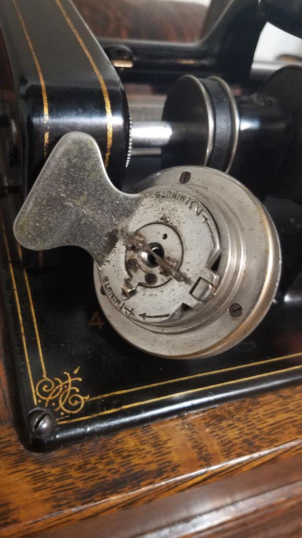

Hi- I'll have to disagree with Chuck on this-- The Standard Model F came from the factory as a 2 and 4 minute machine and was equipped with a special carriage, an "S" reproducer (like a "K" but larger diaphragm), and a cygnet horn- The "S" fits into the smaller carriage eye and has the rotating turntable to choose either the two or four minute stylus. My "F" is my go to machine. The "S" reproducer has very good volume and plays well.
