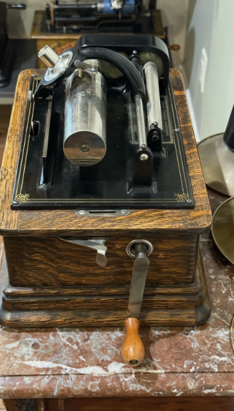

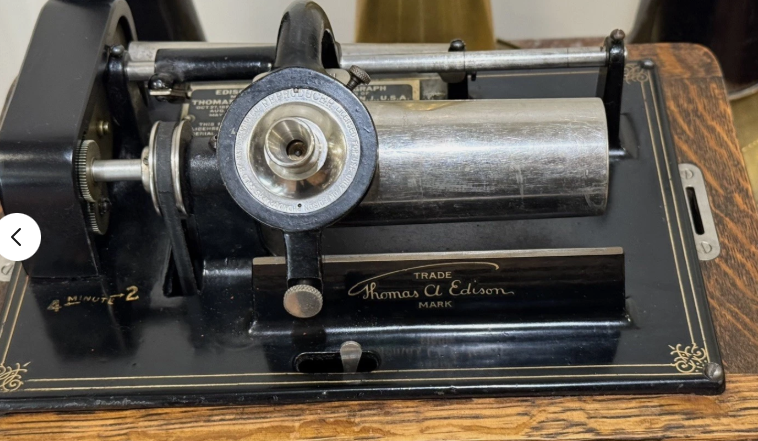

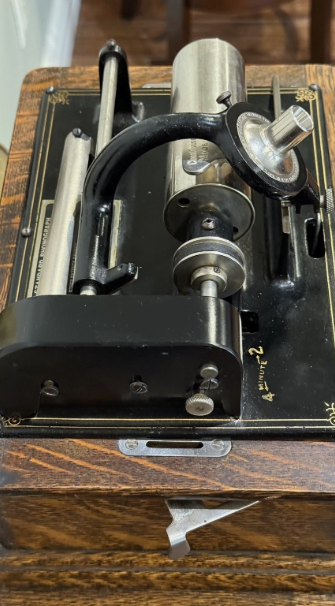

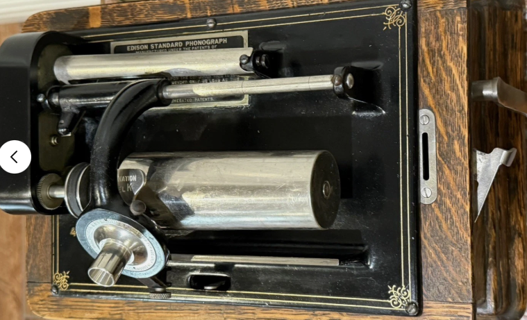

Re: Looking for advice: Fair price for an Edison Standard with Model K reproducer?
Insomnia has kept me up, and it’s getting quite late. Here are a few shots of the machine for your expert eyes; I'm not sure if I can spot any pot metal disease here. What do you think?Aristophane wrote: Mon Feb 16, 2026 4:52 pmThank you Doug for these valuable insights. The Fireside Model A indeed seems like the ideal choice, even if it is proving more difficult to track down in top condition.FellowCollector wrote: Mon Feb 16, 2026 4:38 pm If you're looking for a 2/4 minute Edison cylinder phonograph with a 2/4 minute K reproducer I would highly recommend an Edison Fireside model A versus an Edison Standard. The Fireside model A was an extremely well designed, wonderful playing cylinder phonograph and it has no problems with the seized mandrel (due to the swollen pot metal mandrel shaft bearing) as is often found with Edison Standard models C through F that have not had the bearing replaced or repaired. The Fireside A is often found with its factory released model K reproducer also. Expect to pay an honest price for a good condition Edison Fireside model A with K reproducer but you'll thank yourself for the investment later.
Doug
I had actually spotted an Edison Standard Model D (with the 2/4 minute equipment and the K reproducer Georges mentioned) on a US auction site. However, your warning regarding the mandrel shaft bearing is crucial. I was unaware that Edison models specifically suffered from this issue, but it sadly echoes our experience with Pathé phonographs.
A large number of our French models were decimated by the "pot metal disease" (zamac). It is a scourge we are all too familiar with: the metal oxidizes, swells, and eventually seizes or shatters the mechanisms. Knowing that the Fireside avoids this design flaw in the mandrel bearing is a strong argument that justifies the extra investment.
I am now hesitating to purchase the Standard mentioned above; do all Standards suffer from this problem?
The auctions end tomorrow during the day, but it is already late in Paris. As they say, la nuit porte conseil.
- FellowCollector
- Posts: 2128
- Joined: Tue Jul 07, 2009 7:22 pm
Hello Jean, The Edison Standard model D that you pictured looks very nice. And all you would need to do is assure that the mandrel rotates very freely. If the mandrel does rotate on the mandrel shaft very freely then I'd say you're good with this one. Not all Edison Standard models C through F were afflicted with the swollen pot metal bearing - but many of these models were. The gear cover on the one in the pictures does not appear to be original. Original Edison Standard D (through F) gear covers had twin gold striping. This one is either reproduction or may be an original that has been repainted and left without stripes. Hard to tell from the picture. Good luck!
