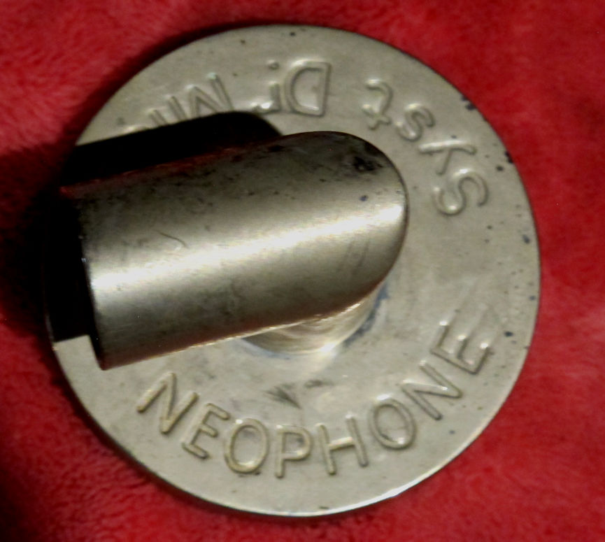

It is little consolation but I attach 3 more photographs 'below' showing the 'chuck' (being round). the sound-box reverse side and how the sound-box would have been displayed in the box originally (the red, plush material was previously up-side down and hidden from me previously.
Thanks for the photos, they show that the adapters belong to the soundbox. A nice set to survive.
It is interesting that the advertisement provided by Sidewinder says that Neolite records can be played with either sapphire or needle. I wouldn’t play Pathé vertical cut records with a needle.
Thanks Jamiegramo for confirming that. They do 'click' into the back nicely.

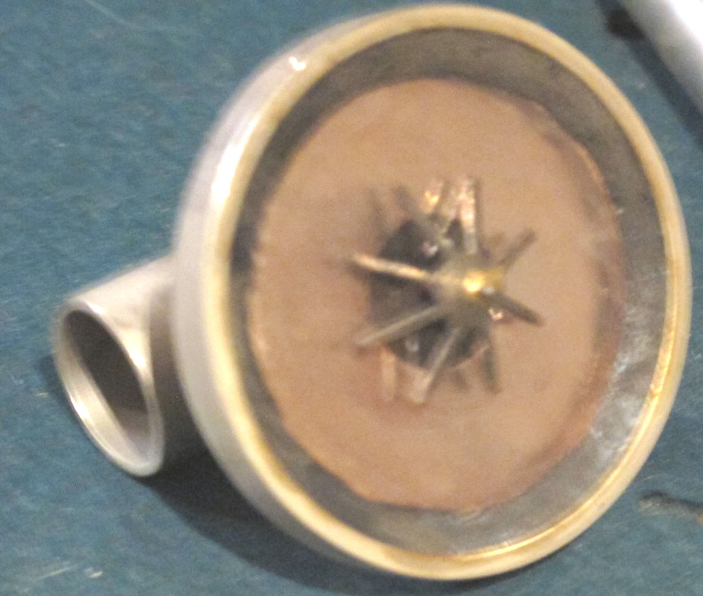

Here a picture of the first style sapphire type reproducer
poodling around
Posts: 2497
Re: Neolite / Neophone Sound-Box
Post by poodling around »
Sidewinder wrote: Thu Feb 26, 2026 2:13 pm Here a picture of the first style sapphire type reproducer
Very interesting to see this.
Incidentally, there is a patent for this reproducer as well if you click on the link in my previous comment (above) which you might like to see.
