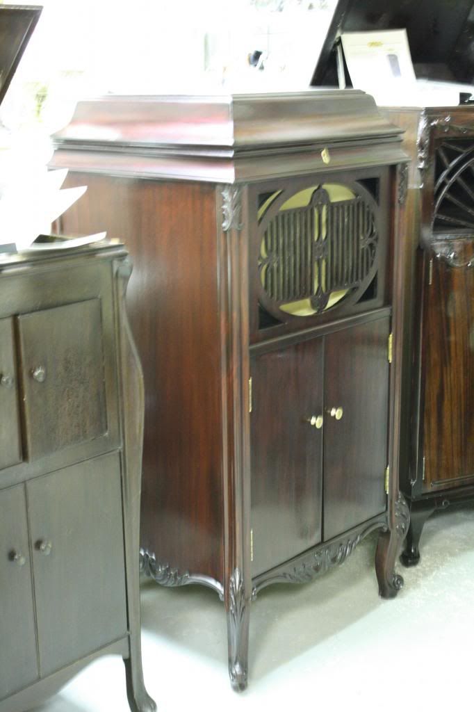

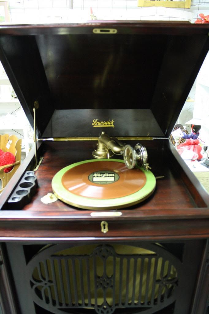

Here's a Brunswick I recently finished with the above satin method, but it could pass for semi gloss.
