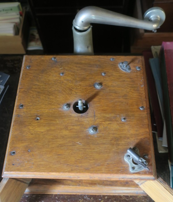

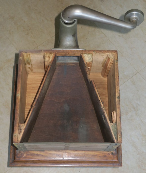

Yes, this is the 'Cinch' as marketed outside the UK with an HMV badge. In France it was the 'Amphion Bis', in India it was the 'Pearl'. I am attaching some snapshots of a Pearl, showing the small roundhead screws in the motor-board that went into the plywood sides of the horn, and needed to be removed, along with the eight main screws, for the motor board to be removed. Inevitably, over the years and doubtless some unskilled removals of the board, the holes in the plywood have burst out and those four small screws no longer have any hold! Why were they thought necessary in the first place? I don't know, but this was the first of the 'motor-in-horn' models to appear on the UK market (shortly before the HMV Model 1 etc), so it may just be that it was thought advisable to secure the horn to the board but was subsequently found to be unnecessary.

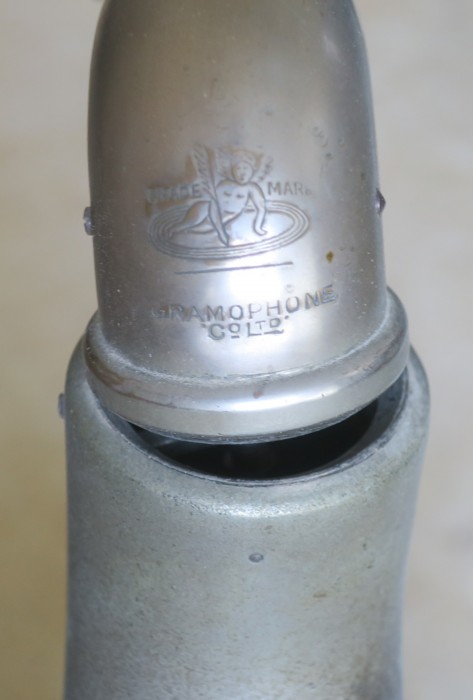

I also attach a photo of the Angel trade-mark stamped on the back of the tone-arm, showing quite definitely that this is a Gramophone Company hornless machine without a gooseneck! Early examples, like this, from 1910, have metal grille (possibly fitted upside down in this case); later on, this was replaced by wood louvres. This applies to the Cinch and the HMV versions.

This Cinch seems to have also an inclined bottom horn board. Mine was completely missing.
