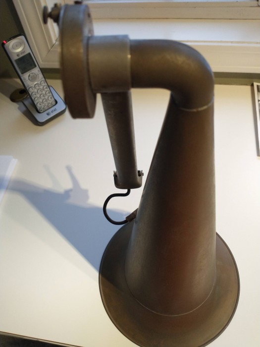

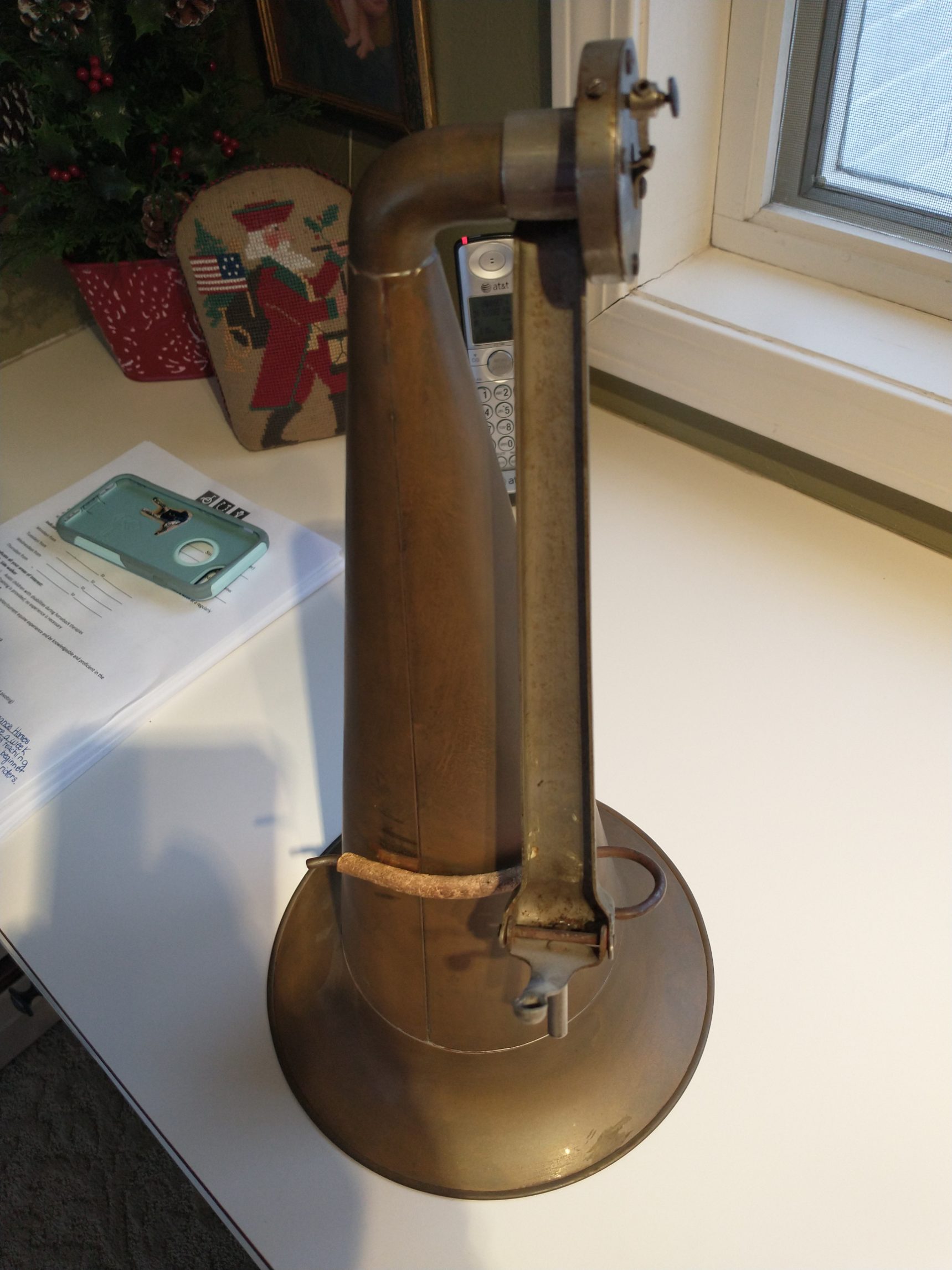

I also have an early A. My brass horn and elbow is of the slip on type, no knurled thumb screw. I also have the more centered placement of the travel arm support. What I DO NOT have, and have never actually seen in person is the travel arm that is elliptical and solid, and not pressed metal with the hollow underside.
I am told that technically that is what my machine should have?
Best,
Jeff
Wisconsin
gramophone78
Posts: 3946
Location: Western Canada
Re: When was the first Zonophone actually made?
Post by gramophone78 »

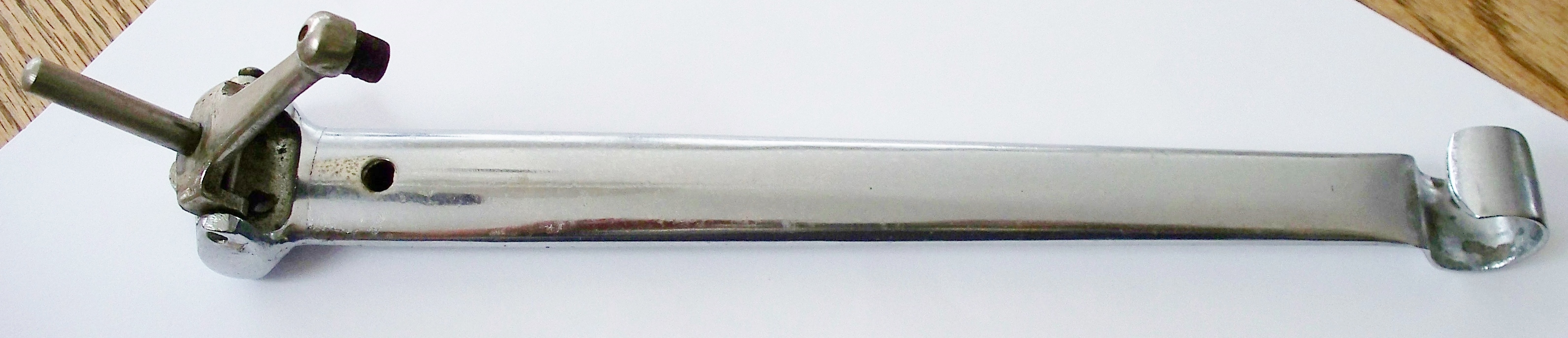

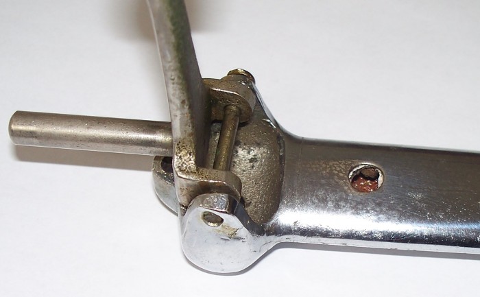

vic-b wrote: Sat Jan 01, 2022 4:54 pm I also have an early A. My brass horn and elbow is of the slip on type, no knurled thumb screw. I also have the more centered placement of the travel arm support. What I DO NOT have, and have never actually seen in person is the travel arm that is elliptical and solid, and not pressed metal with the hollow underside.
Best,
Jeff
Wisconsin
The elliptical arm you mention is actually hollow and is two piece bi-metal (steel tubing and cast brass head for the yolk) constructed. It is believed to be the first type of production arm. Again, possibly as a cost saving measure, an arm like yours was introduced within a short time.
Your Type A appears to have a serial number in the 4000+ range. So, the elliptical arm may have been replaced with the simpler style arm by this period ?....hard to say without more machines examined. My Type C has no serial number to use as a reference.
