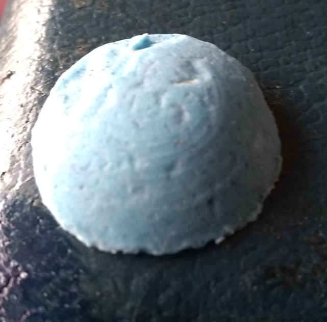

Mine are not quite as nice. I assumed that mine had become squashed and worn flat. They are as hard as rock now and quite brittle looking. They are bluish but with a grey chalky patina, and the edges are a bit cauliflowered.
If the feet ever extended out over the rexine it was probably less than 1/16". The best of my existing feet measures about ⅝" at its widest point.

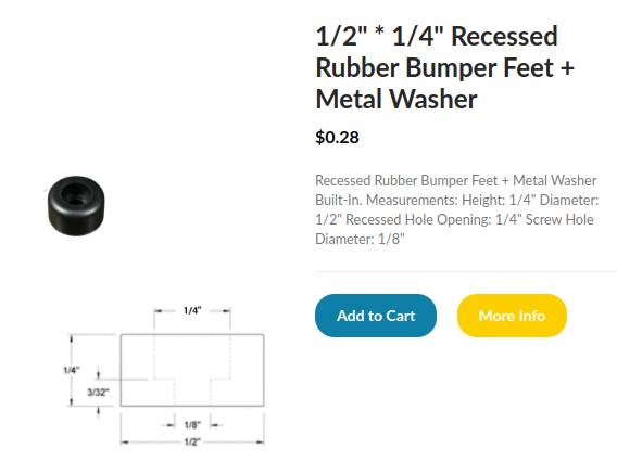

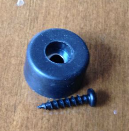

½" x ¼" is a common size for screw-on feet. These might work with a ½" metal or rubber washer beneath them.
https://www.rubberfeetwarehouse.com/col ... ubber-feet
2022-10-14 15.22.33 www.rubberfeetwarehouse.com b3db0ef27203.png (42.62 KiB) Viewed 1118 times
Online
Posts: 5816
Re: HMV 102C Case Feet
If you use screw on feet the screw heads will be visible unless you fill the recesses with sealant.

These blue bumper feet, now found only as ghostly images and dead links, would be very cool. They are ½" tall and ⅞" in diameter and could probably be milled down to fit while leaving a flange to cover the rexine at the edges of the hole.

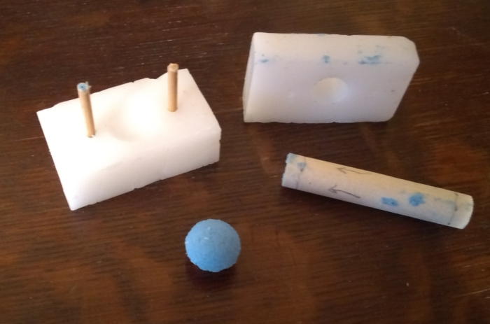

This is my first and botched attempt at fabricating a OoGoo foot for my HMV 102.
The mould is made using paraffin wax. It is -6 C here and my workshop is unheated. It was a bit challenging cutting the paraffin as it was quite brittle.
What went wrong?
1.
I used an inappropriate silicone. All tutorials say that clear Silicone I (100% silicone) is absolutely necessary. I could not find this in stores near me. I used something that said it was Pure Silicone. It was also white. It sort of worked but not all that well. It had a very slow curing time, and the result is a bit too crumbly.
Also with a white base, it was hard to get a darker colour density.
I used acrylic paint. Some tutorials say you cannot use acrylic paint, only enamel. Others say it is OK. Others say to use food colouring. The acrylic paint, if it was a problem, was the least of my problems here.
2.
Also in my haste and uncertainty, I put the top of the mould on upside down. The top is made from the first cut I took off the paraffin block. Its base and sides are roughly square with each other. Its top which is the factory end of the block is not. Putting the top on upside down resulted in the shank of the foot being out of alignment/centre.
Conclusion
Anyway ... this serves well enough for a proof of concept exercise. Next time ....

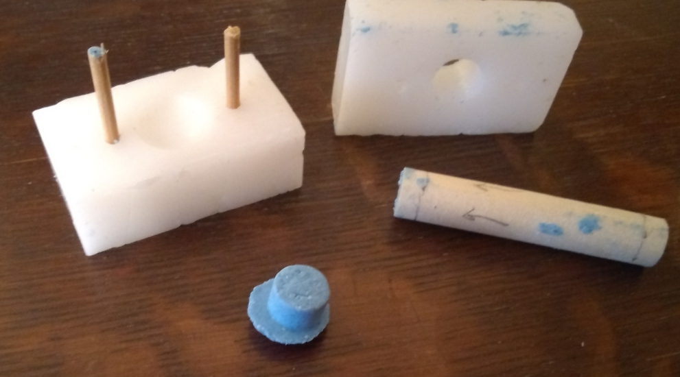

I shaved the prototype foot down to compensate for the shank being off centre, so the finish is a bit rough.
I need to get the consistency and colour better.
I also need to redo the bottom of the mould so that side of the foot is steeper, the top is flatter (less domed), and the flange edge over the rexine is smaller.
