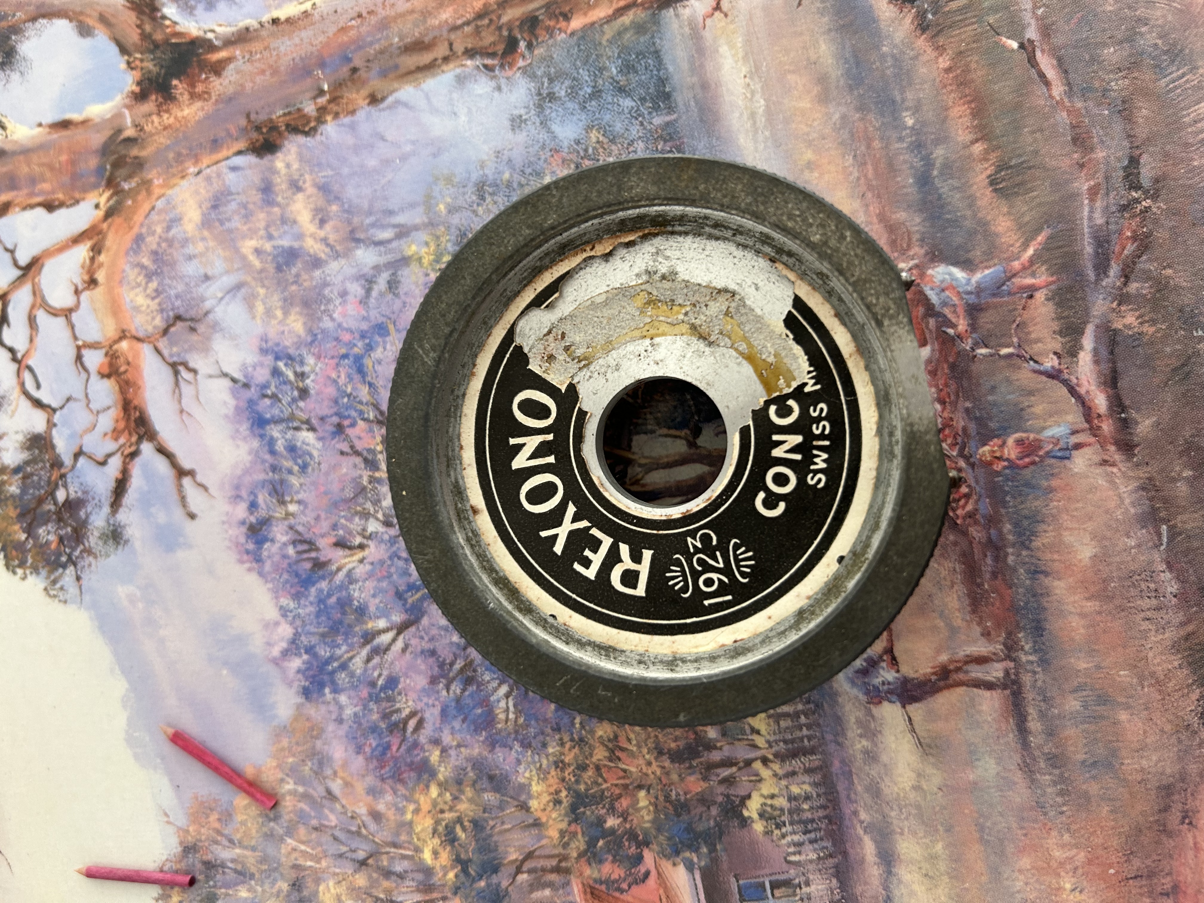

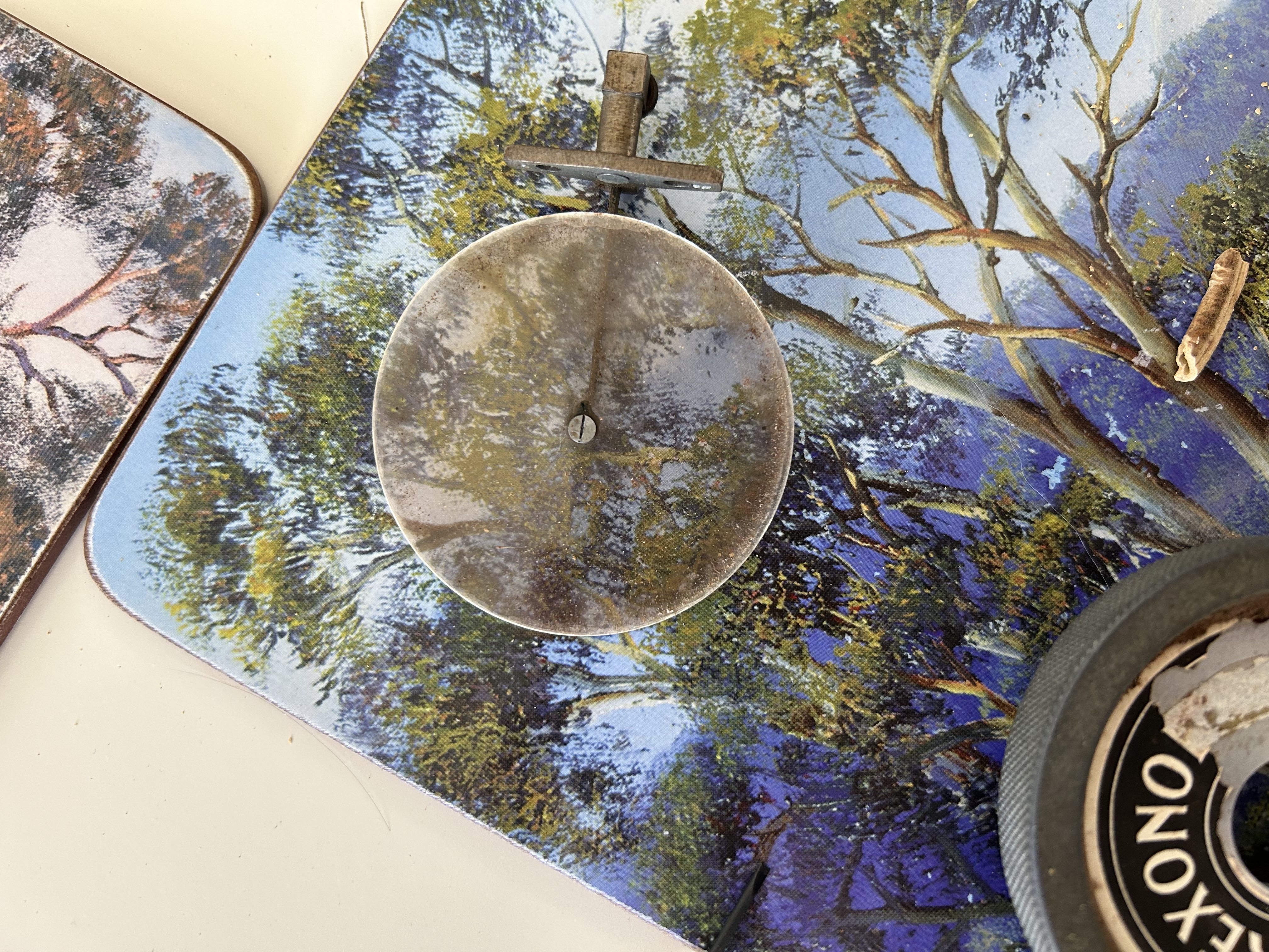

Thanks for the advice! The needle bar/diaphragm screw was too tight for me to comfortably unscrew it, so I’ve left it all attached for the moment. After removing the outer gasket and the two screws holding the needle bar in place, I was able to very carefully extract the diaphragm and needle bar together. The diaphragm was not stuck to the inner gasket at all, and so it came away easily.
The inner diaphragm came out without too much trouble as well. I somehow managed to preserve 100% of the remaining paper label inside the box, so I’m rather pleased with myself so far.
The inside of the box certainly isn’t immaculate, but it’s not too bad. Should I clean it up at all? I’d rather not have to, as the label inside is quite delicate, and surely the gaskets will still seal in spite of a little bit of grime.
Also, is there an art to measuring the gasket material, or can I just put it in and cut it to length?
I’ve attached a couple of pictures of the soundbox’s present state anyway, so you can have a look for yourselves.
Thanks again,
William
Thanks again,
William
