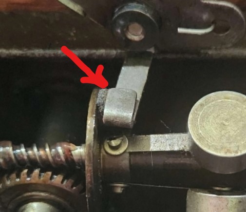

The governor's foot looks rather dry --
Screenshot 2024-10-05 100235.jpg (40.7 KiB) Viewed 938 times
Try putting a few drops of oil on the pad. Also, possibly a little more grease on the governor's worm gear. Maybe a drop of oil on the turntable spindle.

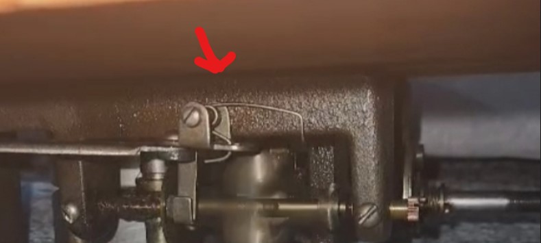

Some motors, especially those installed in the "off brand" models weren't the quietest in the world. I noticed that the motor, itself, seems flush with the motorboard --
You might try installing some felt isolaters or gaskets -- about ¼ - ⅓ inch thick -- between the motor board and the motor, itself to minimize the noise transfer to the cabinet. Very soft rubber gaskets would probably also work.

OrthoFan wrote: Sat Oct 05, 2024 1:14 pm The governor's foot looks rather dry --
OrthoFan
Hi ! I can see the governor's spring leaves bent downwards under the burden of weights. I am sure they must be contributing to the noise as well. Please ensure that all screws on the governor are tight.
