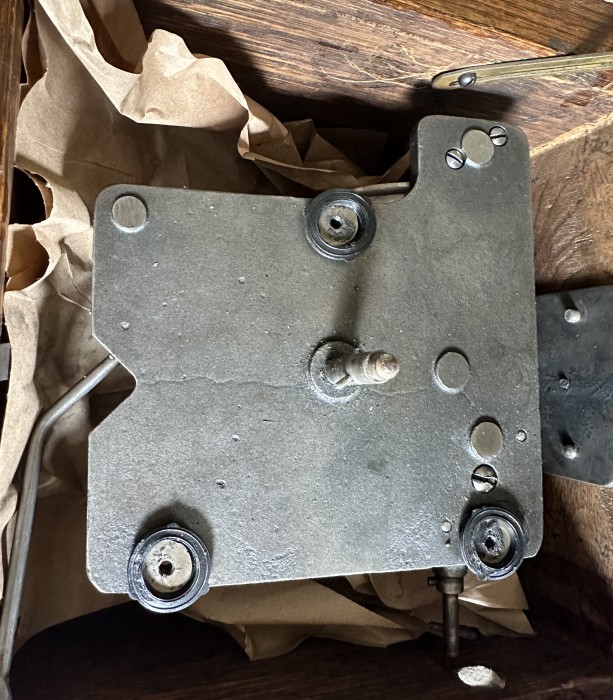

Re: A Vic III New To Me
See attached…
Someone has definitely been here, and more recently than I would have liked. I wonder what those rubber washers are from…
- Posts: 6382
Those are garden hose gasket washers. Not a horrible solution actually, but not quite right either.Dischoard wrote: Tue Jul 23, 2024 12:56 pm Someone has definitely been here, and more recently than I would have liked. I wonder what those rubber washers are from…
Yes, I believe they are and the little nubs on the side are to keep them in place when they're in the receiver. They don't look all that old.
