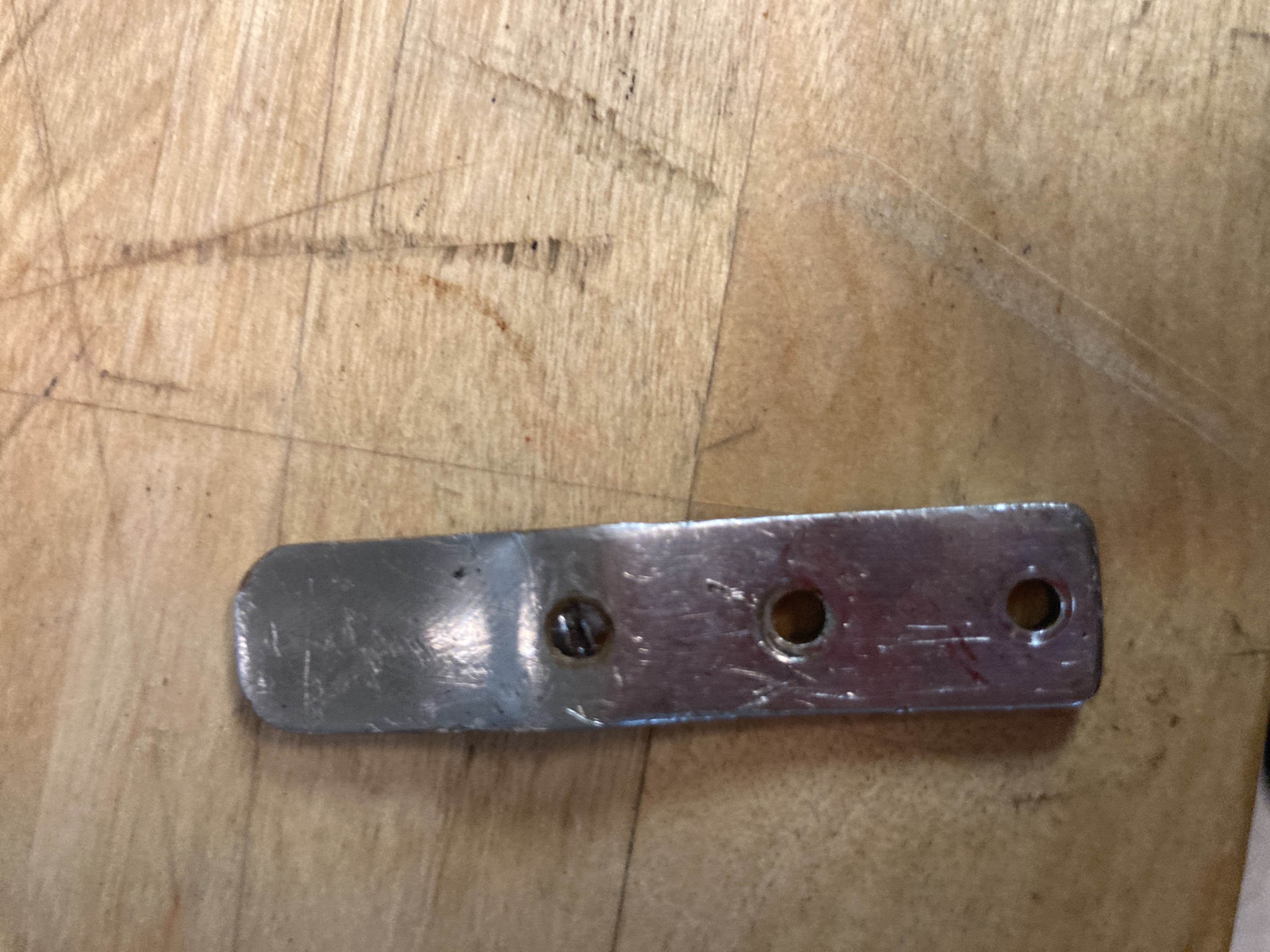

I’m really tired and frustrated. I’m really beginning to think this machine isn’t for me or I also have a bad feedscrew. All I need to do is calm down and come back to it later. This machine REALLY hates me. I had a hunch this was exactly gonna happen. But the the plate that goes on top of the spring the adjustment screw is rusted and stubborn to turn and is gonna get stripped if I attempt. Sigh. Why does this always happen to me!

I’m gonna let me take my time and calm down. Let the plate soak in wd40. But I got a feeling the screw might be too damaged to turn.

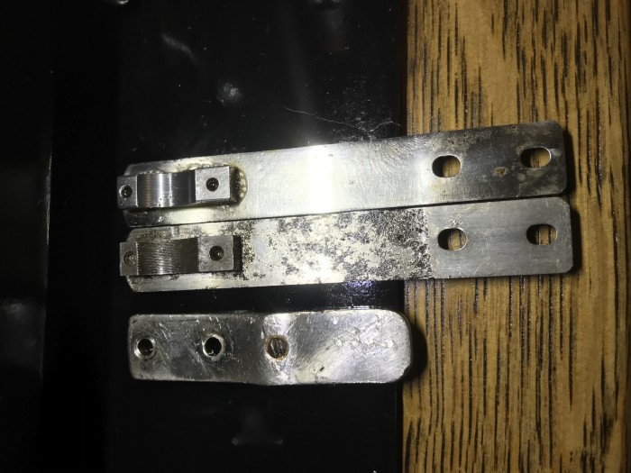

Yeah I think I got a dubious halfnut/plate. It appears this one has some rust on it. And you can see the stripped screw adjustment. I have No idea how difficult it is to replace a feed screw for one of these 2/4 converted machines. Anyway if you see a problem TELL me!

Posts: 6882
Re: Triumph problem #2 tracking.
Your new ½ nut looks excellent, but very dirty. By comparison, the old ½ nut appears very worn.
