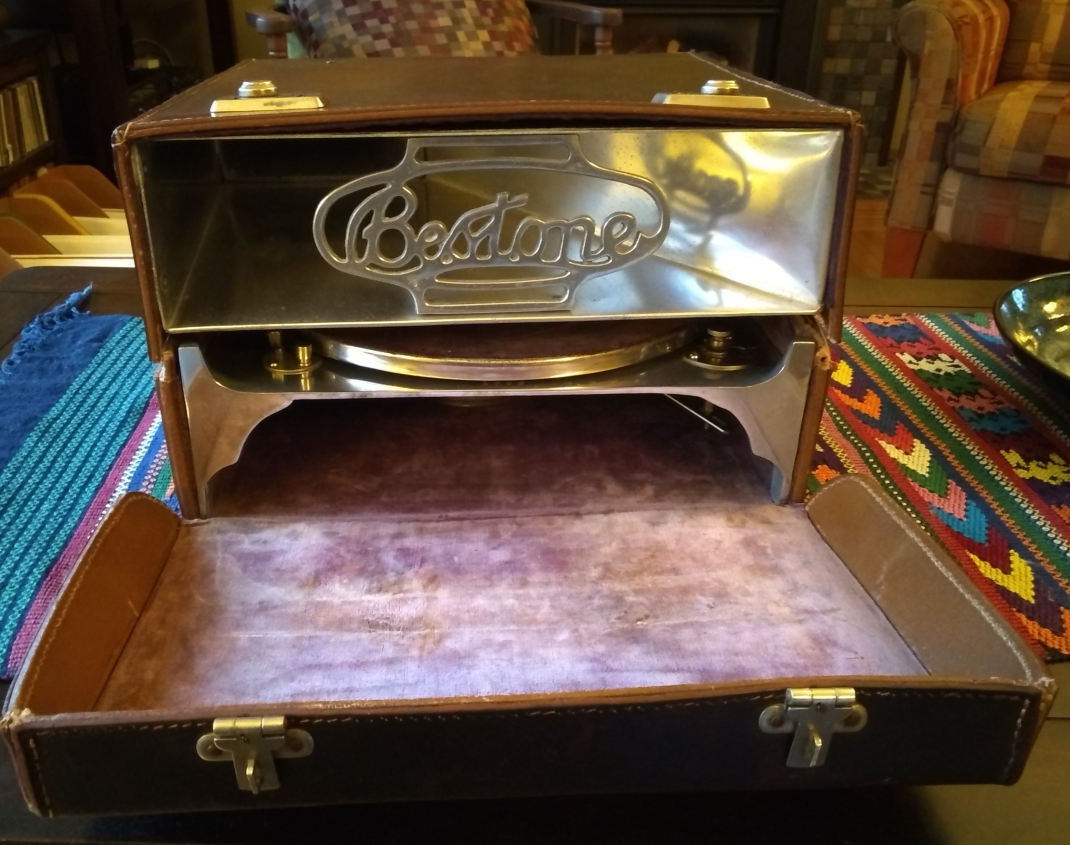

Started on the Roberts Bestone
- Posts: 4680
Re: Started on the Roberts Bestone
As you said, the effect of the cleaned purple velvet is magnificent...
Lah Ca
- Posts: 1409
LOL. Thanks.Inigo wrote: Mon Feb 12, 2024 11:13 pm My God! It is starting to look so beautiful that you'll have to touch it with white antique librarian gloves on your hands...!!!![]()
Thank you.An Balores wrote: Tue Feb 13, 2024 5:46 am Nice to see the attention to detail. It will be well worth all the effort you have expended on this machine to restore it.
The camera does not really do the original colour justice. The machine would have been visually stunning when new.Inigo wrote: Tue Feb 13, 2024 1:03 pm As you said, the effect of the cleaned purple velvet is magnificent...
Lah Ca
- Posts: 1409

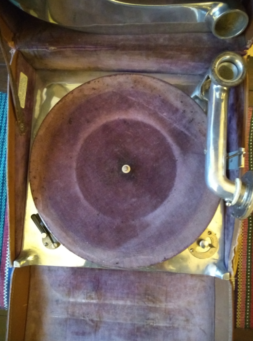

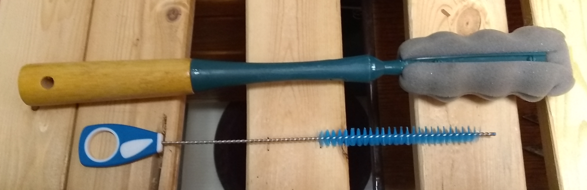

Cheap, useful tools for polishing the inside of the horn and the name-plate/grill.
The sponge brush was particularly useful, at first for washing and rinsing and secondly for polishing. It was possible to wrap a microfibre cloth around and then secure it with small narrow zap straps. The (drink) straw cleaning brush was useful for loosening debris, cleaning the open areas of the name plate, and then for a bit of polishing as a bit of rag could be secured around it, too.

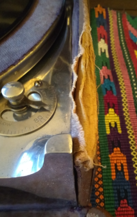

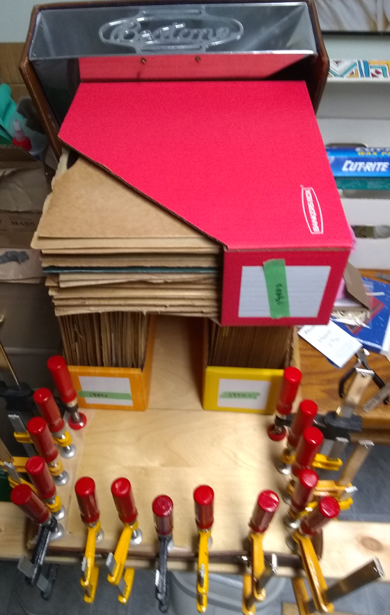

I did a trial reassembly, inserting the aluminium frame/motor-board back into the case in order to assess the effectiveness of my warp removal.
I found that I need to get the top/lid a lot flatter if I do not want it to rip itself free of the case eventually. The (now considerably reduced) concave warp in the lid still does not allow the latches to line up properly when the aluminium frame is in the case. Force is required. Force puts stress on the damaged leather hinge.
More work is required. I dampened the inside of the lid again, laid down layers of paper towel to absorb excess water and distribute humidity more evenly, covered all with wax paper, and inserted a board cut to the shape of the case bottom and lid. Then I placed the old bed slats strategically and clamped it all down. I also placed boxes of 78s in the case. We shall how this goes.

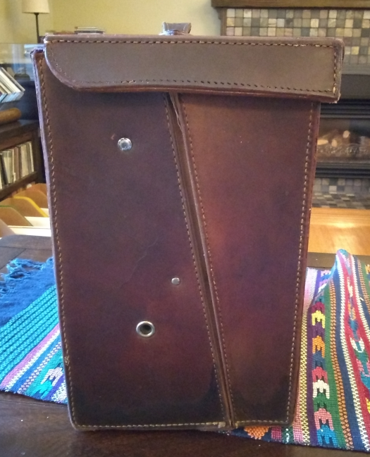

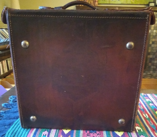

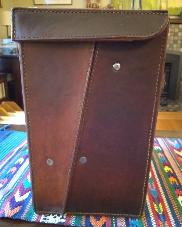

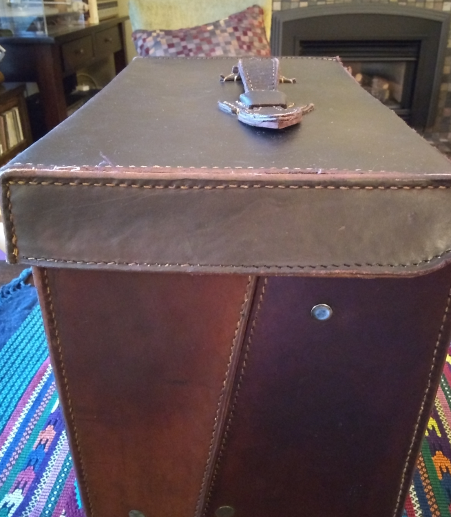

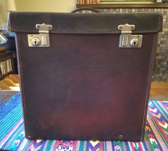

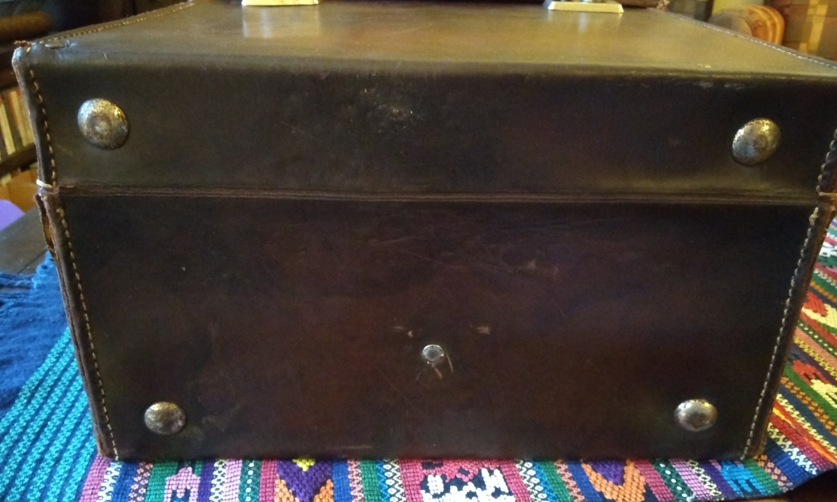

Getting Close to Done
The Case
The case will need continued work with neetsfoot oil and straightening--a little at a time.
Lonsdale leather sells a product for treating/finishing the rough edges of leather, so I will probably go buy some.
Tweaks and tweaks over time.
You can see the Chicago screws that I used to replace the bifrucated rivets in the pictures below. I used the black ones but took steel wool to the tops of them to make them look old and abused. I had to drill things out just a little to get them to fit. They work very well.
The Case

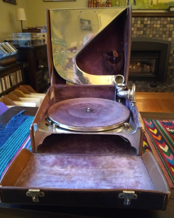

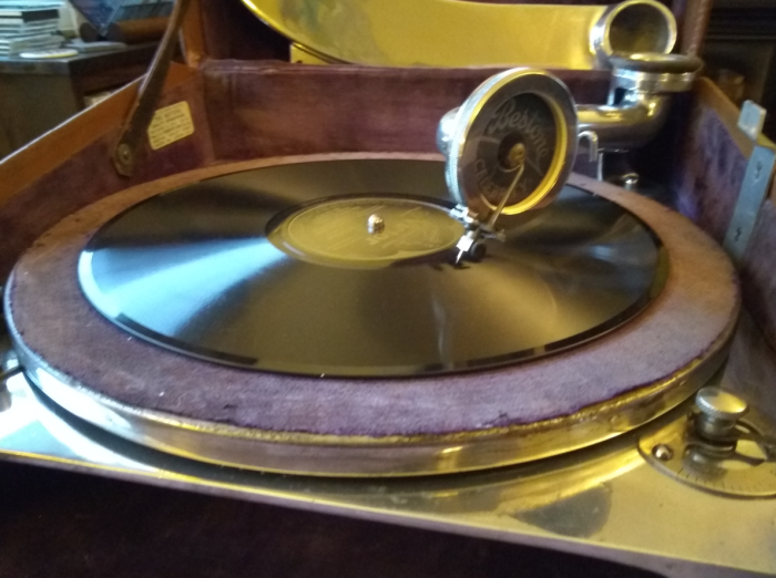

The Machine
The photo below is staged. I cannot wind the motor up when it is in the case--no crank, yet.

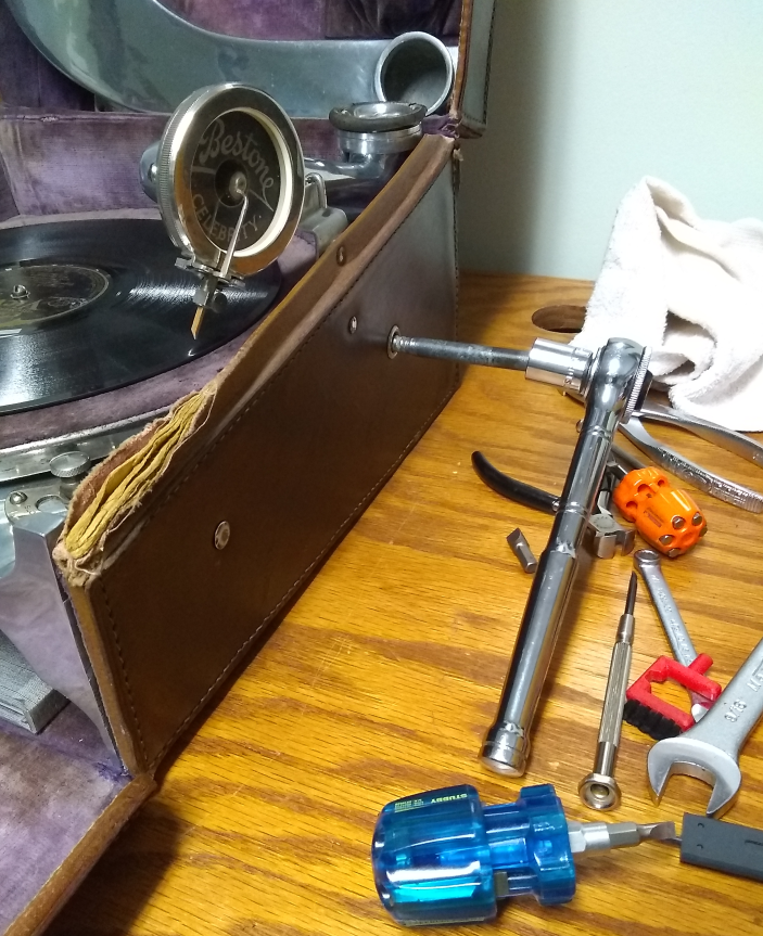

As an accursed generalist, I am reasonably competent at many things but truly skilled at few.
In the not even competent area, there is metal work. It has never been my forte, and I have done very little metal fabrication since Jr. High School shop classes. I have some tools, but they are mostly crude things, not useful for any fine work.
So I have discovered that making a crank is harder than I had anticipated--concepts are simple--the work is not without a decent vice or a rod bending jig and of course skill. I tried making a prototype crank out of 3/8ths rod that I have plenty of, too large yes, but not for practice. The results were not encouraging. But with repeated practice, I did get better at cutting the fork in the end of the rod more accurately.
A couple of people locally, including my mechanic, have offered to help if I make a 40 min drive to the nearest place I can find 3' lengths of 5/15ths rod in stock. And I think I will soon have a crank that can be modified--I am increasingly confident that I will be able to adapt it. I will keep practising cutting slots in my other rod stock. I will only get one chance the crank .
Being impatient, I turned my drill press into a lathe and milled down the threaded shaft on a 3/8ths lag bolt to 5/16ths and then cut a slot and shaped the end.
I can wind the machine up now using a ratcheted socket driver--not a good long term solution but OK for the moment.
The motor runs fairly quietly under a load, and the tic, tic, tic noise is either gone or inaudible. It runs stably at 78 RPM without much wow and flutter. The spring is quiet both winding and playing, but it is a very small spring, and in the machine's current condition it struggles to play 12" records, particularly electrically recorded ones. The motor really does need a complete overhaul and tune up.
While winding the machine one time, my non-return spring repair gave way dramatically. I had to take everything apart to fix it (again) and then reassemble it all. I can do it in my sleep now.
