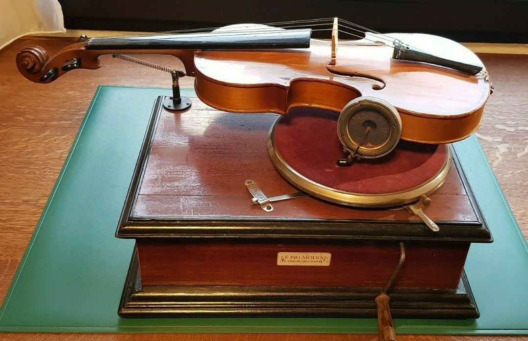

https://www.ebay.de/itm/185229154600?ha ... SwwHZhxx~i
LE PALMODIAN was an idea to utilize a violin as a "soundbox"
So why would one think that this machine is fake?

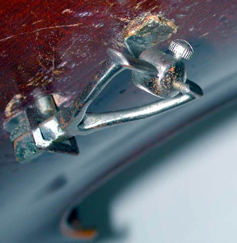

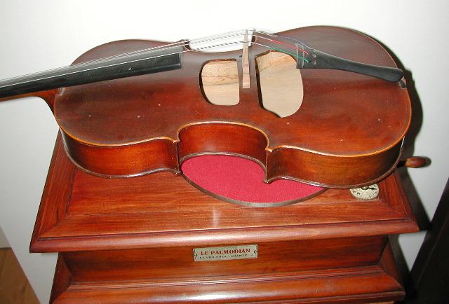

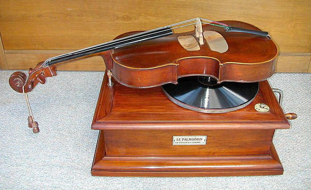

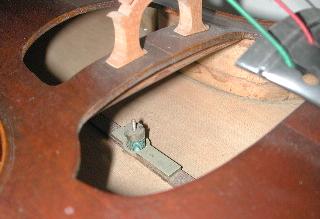

The real Palmodian did not have a reproducer / soundbox attached to the side of the violin. The stylus was underneath, attached to a surprisingly complex mount which was patented. That mount was adjustable from the inside to change the tension of the connector between the stylus arm and the body of the violin.
The violin did not have standard 'f' holes as on a normal violin, as shown in the eBay picture. It had two large central openings.
I attach pictures of the original Palmodian that I owned in the past. It was an amazing machine, I regret letting it go. The sound was surprisingly good, especially when I played a large Pathé disc with a violin solo. It was mind-blowing.

the fake one (of which there seem to be many around) with a reproducer drilled into the side of a violin is about as logical as sticking a reproducer onto a Lumiere Diaphragm!
The whole point is that the violin is the reproducer

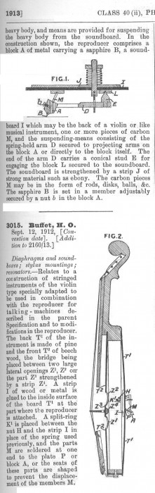

Here is an extract explaining the patented design of the stylus holder assembly. It was a lot more complicated than just mounting a sapphire to the underside of a violin (as Ray Phillips did for his replica Palmodians), or a standard reproducer to the side of a violin (as in the eBay listing).
This should enlarge if you click on it.

I did a little look-around in “The Talking Machine Monthly” available at the World Radio History website and found this eye-opening nugget on page 14 of the May 1913 issue available for download from https://worldradiohistory.com/Talking_Machine_World.htm :
“A carbon microphone”? Really? I can’t help feeling that perhaps the author was not entirely clear on how the thing worked. I find that fairly early use of a microphone fascinating! Can anyone add more info?
TinfoilPhono
Posts: 2069
Location: SF Bay Area, Calif.
Re: Palmodian Fake?
Post by TinfoilPhono »
If you refer back to the article I posted a couple of posts above this, the first paragraph talks about (and illustrates) a piece of carbon being mounted between the stylus holder and the violin back. Exactly how that was supposed to improve the sound is unclear. I think the author of the article just posted was confused about that carbon insulator versus a carbon microphone. Obviously there was nothing electronic involved. I seriously doubt if carbon worked any differently than wood or metal in the original application.
