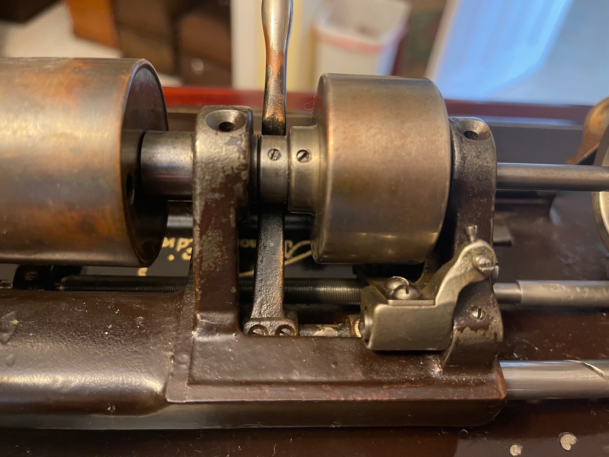

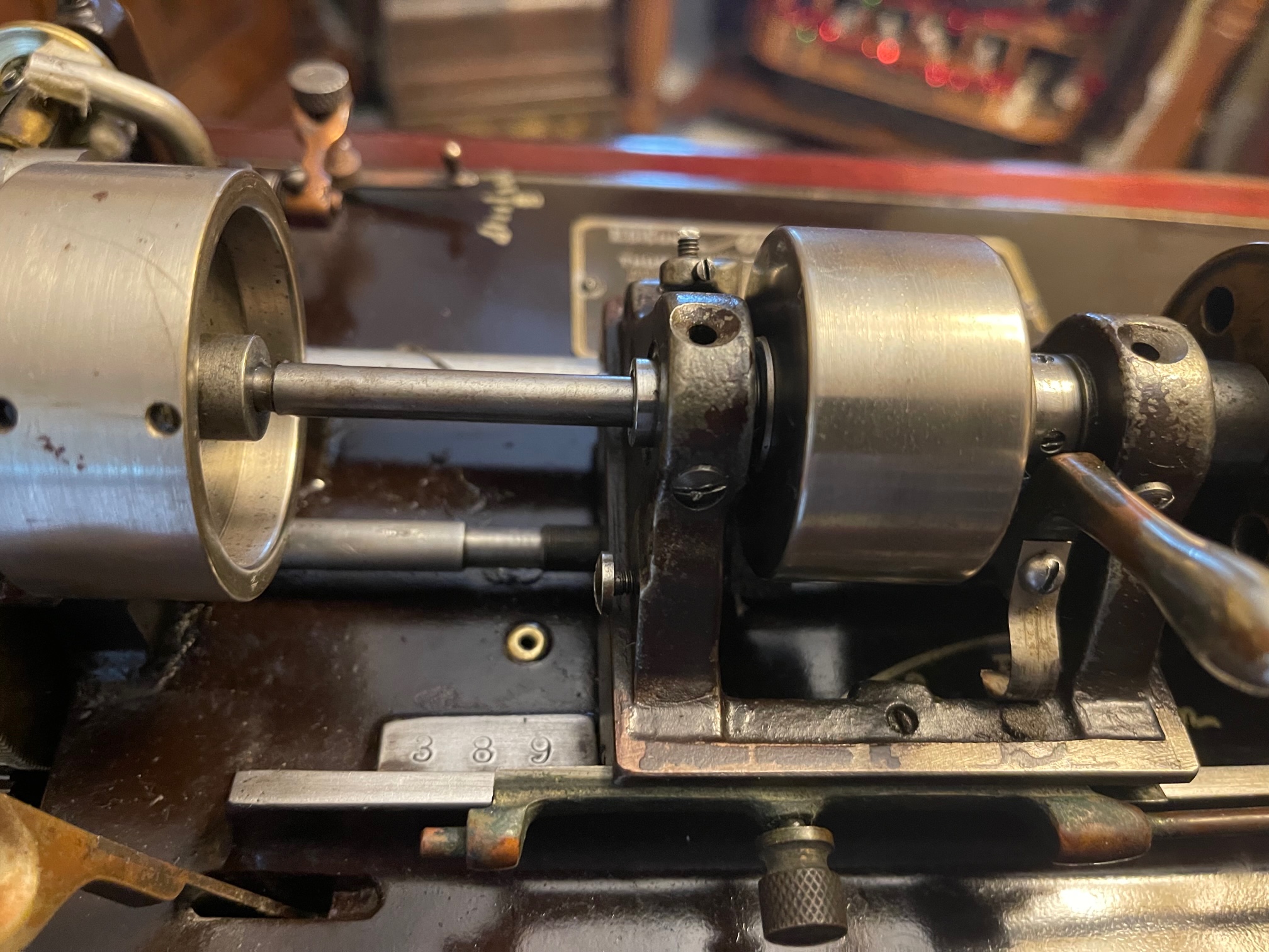

This Edison Opera, SN. 339, has a problem I've never encountered before. It works just fine until it gets about 85% of the way through a cylinder, and then stops traveling. A little pressure on the half-nut, or on the engagement lever, will allow it to finish the cylinder.
With the machine off, and the engagement lever down, it will still allow the half-nut to move over the feed screw in this range; once it gets further along it "locks on" the way it should.
My first instinct was to increase the pressure on the half-nut they way one would do on, say, a Triumph. But the whole arrangement is different, and I'm unsure how to attack this problem. Rather than adjust first and ask questions later, I thought perhaps the experts here can offer some advice.

Problem apparently solved. The set screw #2 apparently is used to relieve pressure of the half-nut on the feed screw. I noticed that there was no contact between this set screw and the casting; thus it was at it's maximum position and could not be backed off any further, thus no further pressure could be exerted on the half-nut.  Just below this set screw is yet another set screw, #1, that controls the positioning of the entire piece on a shaft running through it. I backed off on it, and tapped the assembly so that it would reposition itself on the shaft.  Seems to have worked, have played a cylinder all the way through several times and it's not skipping.
