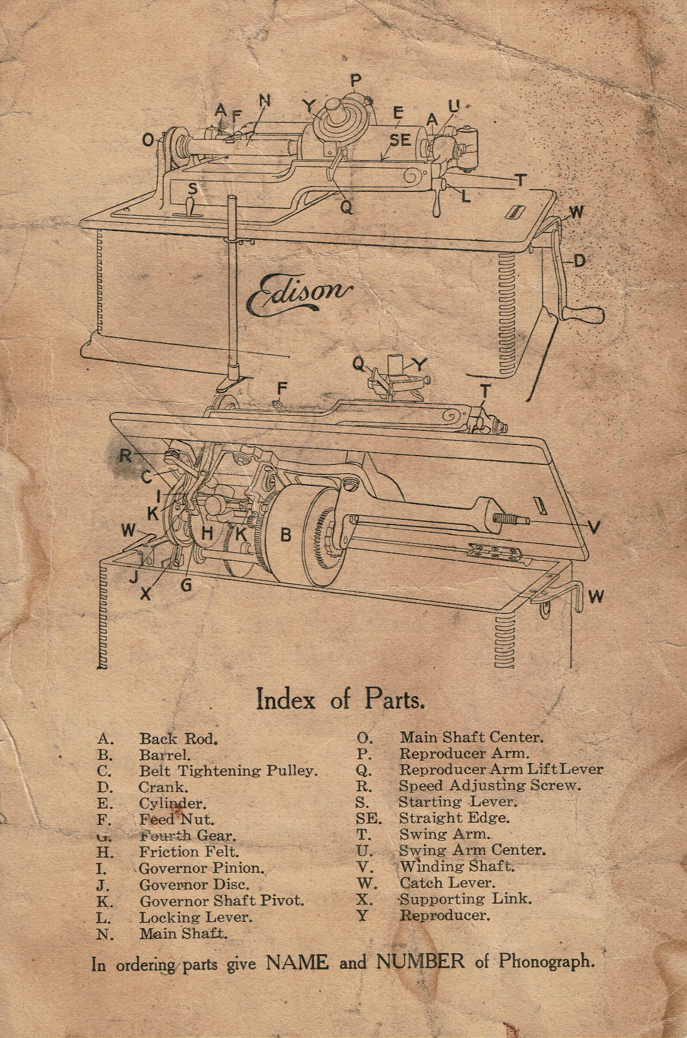

From Edison literature.
Shawn

Thank you both so much. This machine doesn't have any holes on the bottom or the slot cut on the top, most likely never had a crane on it. The guy I am getting this info for wants to put a crane and large horn on it. Your info fits the bill. That is much appreciated.

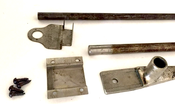

You'll want this kind of clip ...
Screen Shot 2022-03-09 at 9.42.47 PM.png (328.94 KiB) Viewed 760 times
James.
