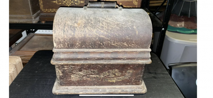

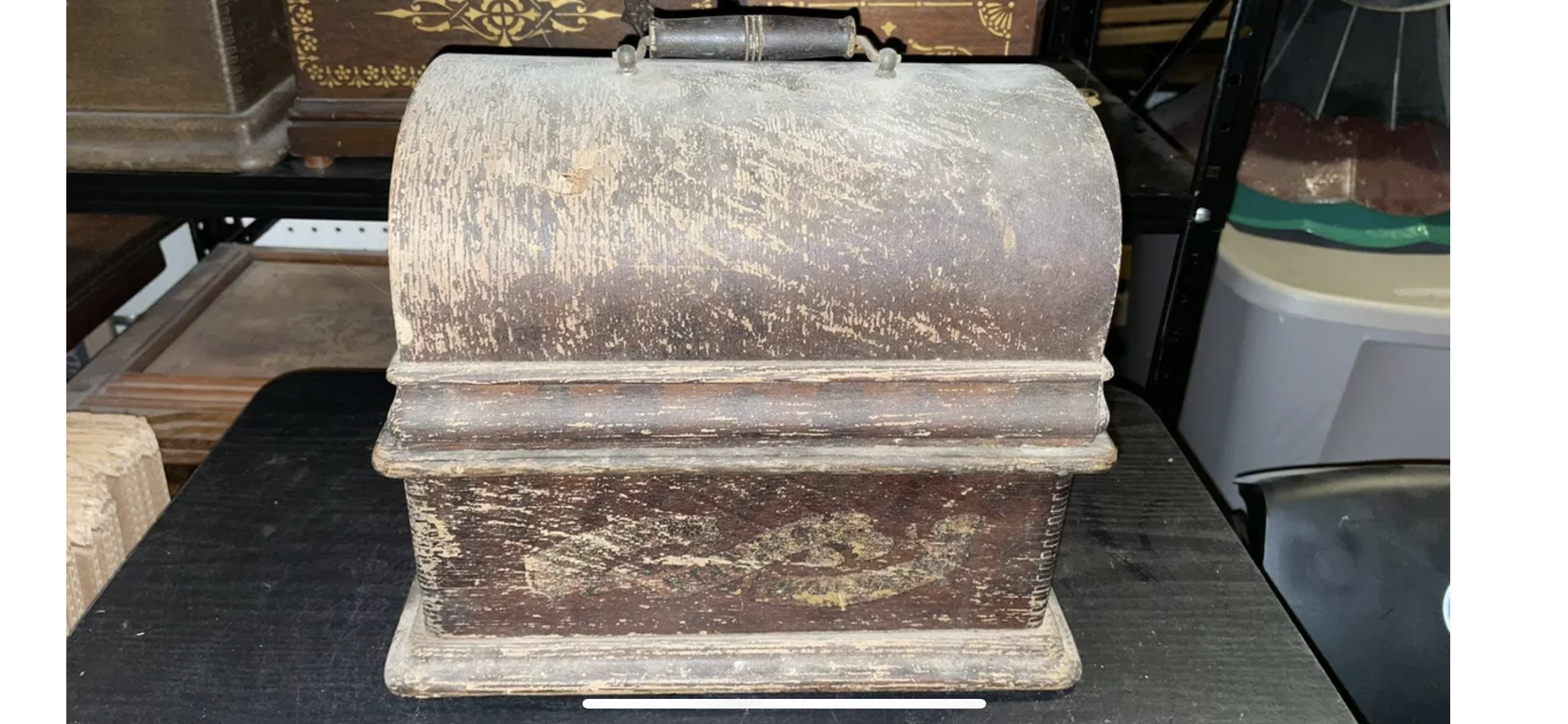

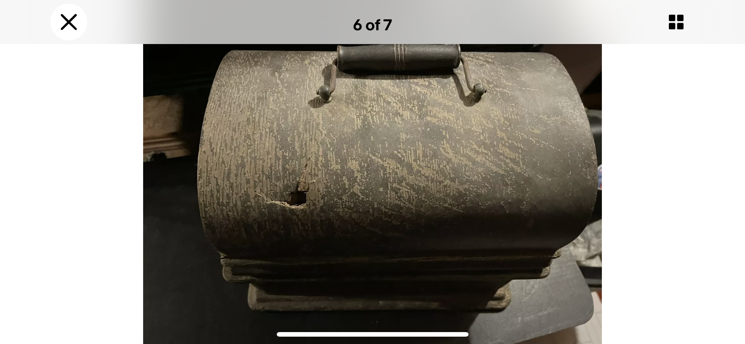

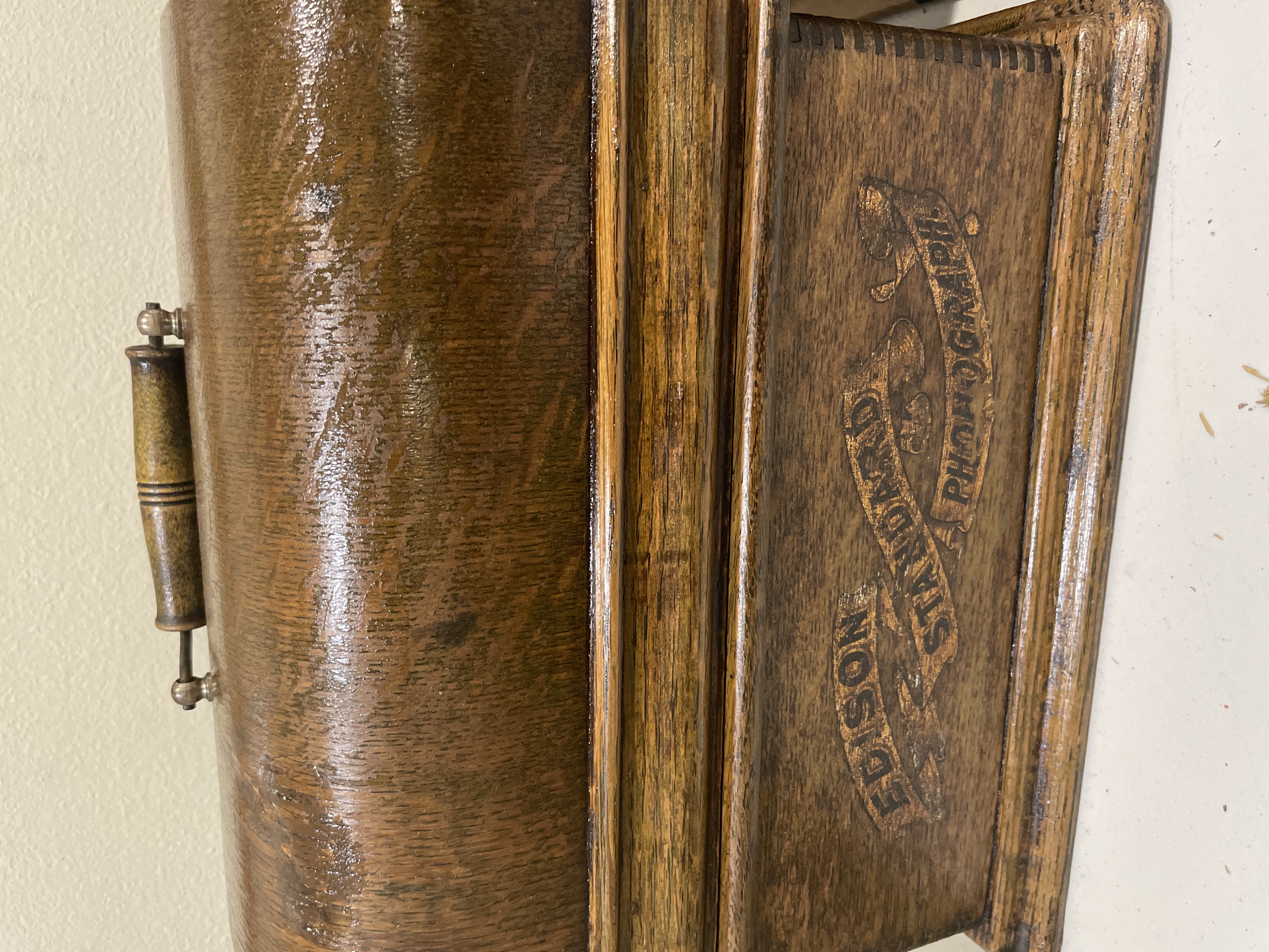

I got this case a while back and assumed it was probably a complete refinish job. But I went through first to clean first with denatured alcohol. What I found was original finish and a decent banner sticker.
I’m still working on the hole in the lid. But I’m amazed at the original finish is still there. And the front banner!

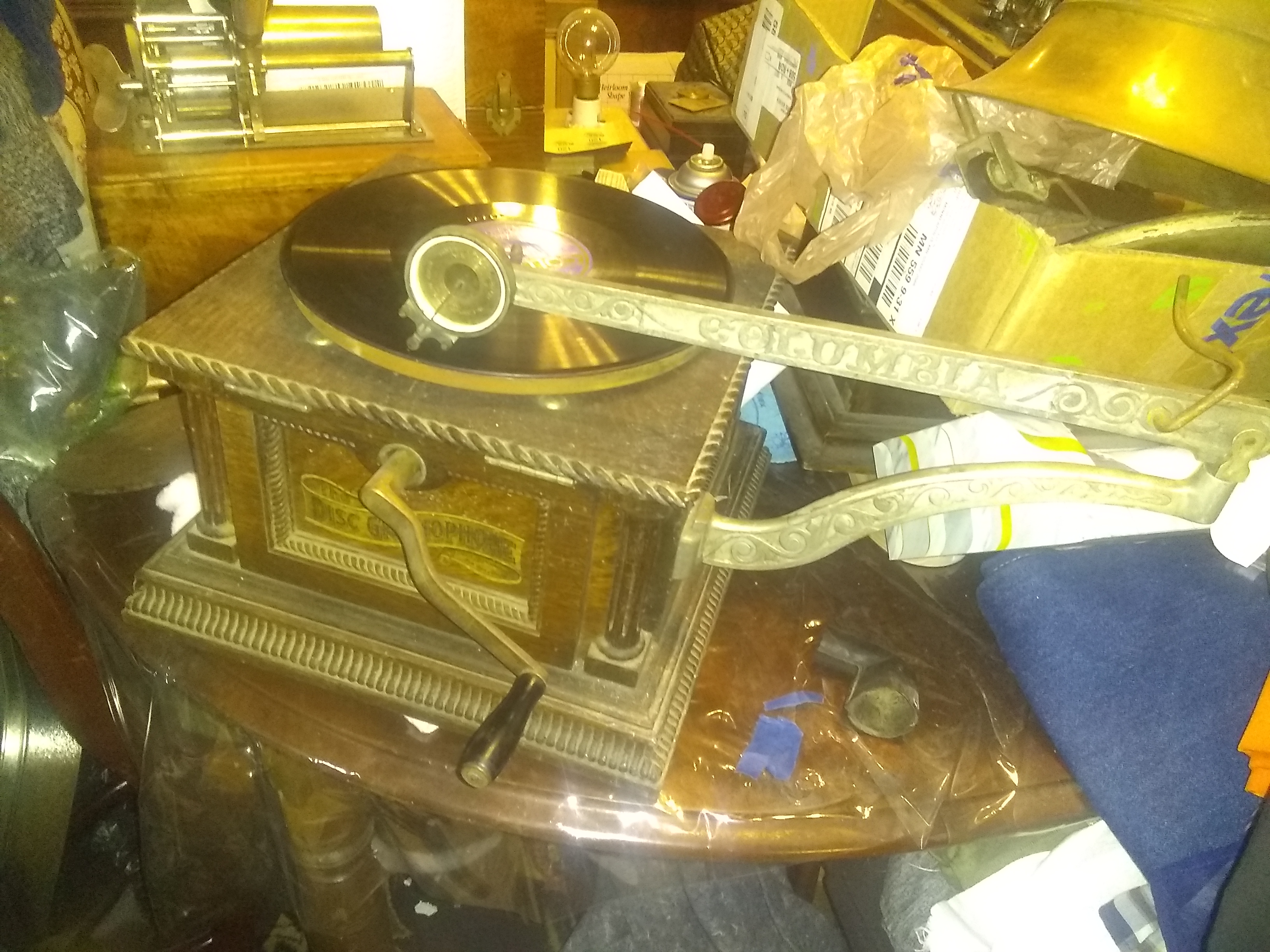

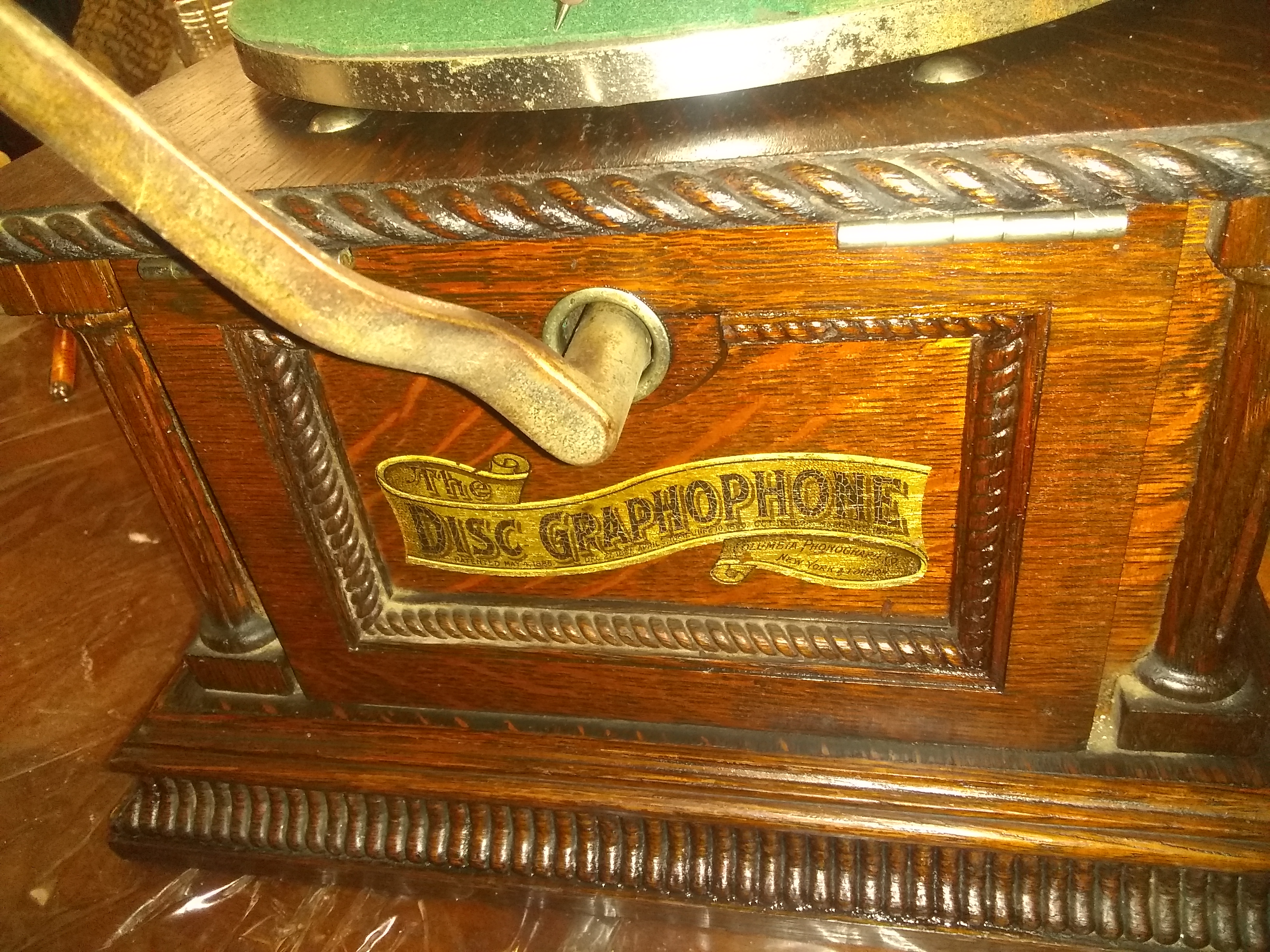

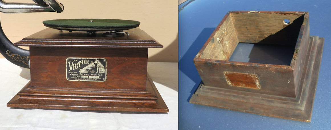

Agreed! Here's a recent project.

That turned out really well! The cabinet seems to have a lot of crevices.

Doesn't denatured alcohol act as a stripper for shellac?
bartongreg8238
Posts: 24
Joined: Sat Apr 17, 2021 1:35 pm
Personal Text: Music!
Re: Cleaning goes a long way…
Post by bartongreg8238 »
Yes. I believe shellac flakes are dissolved in alcohol, so it works to remove too. In my case, I kept pulling a red-ish shellac that had been applied over the original green oak stain. Also, I was very careful around the banner as the alcohol will pull that off too.
