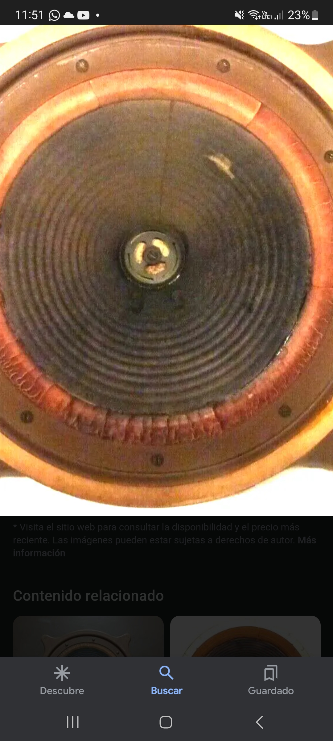

Does anyone have to sell an 8-inch cone from a speaker with a ¼ coil, it measures 12 Ohms to me

claudio luciani
Posts: 20
Joined: Mon Jul 04, 2022 8:31 pm
Location: Buenos Aires Argentina
Re: Speaker cone
Post by claudio luciani »
like this is the cone It is for a 12-15 E number 6060 that the coil was cut and the cone is in the last

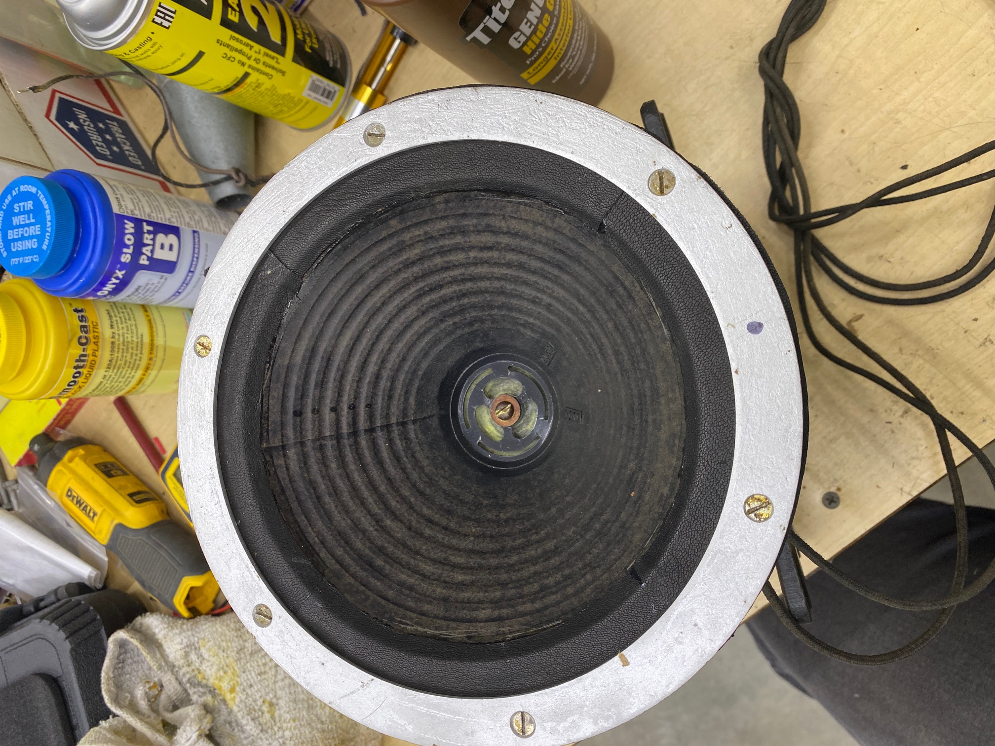

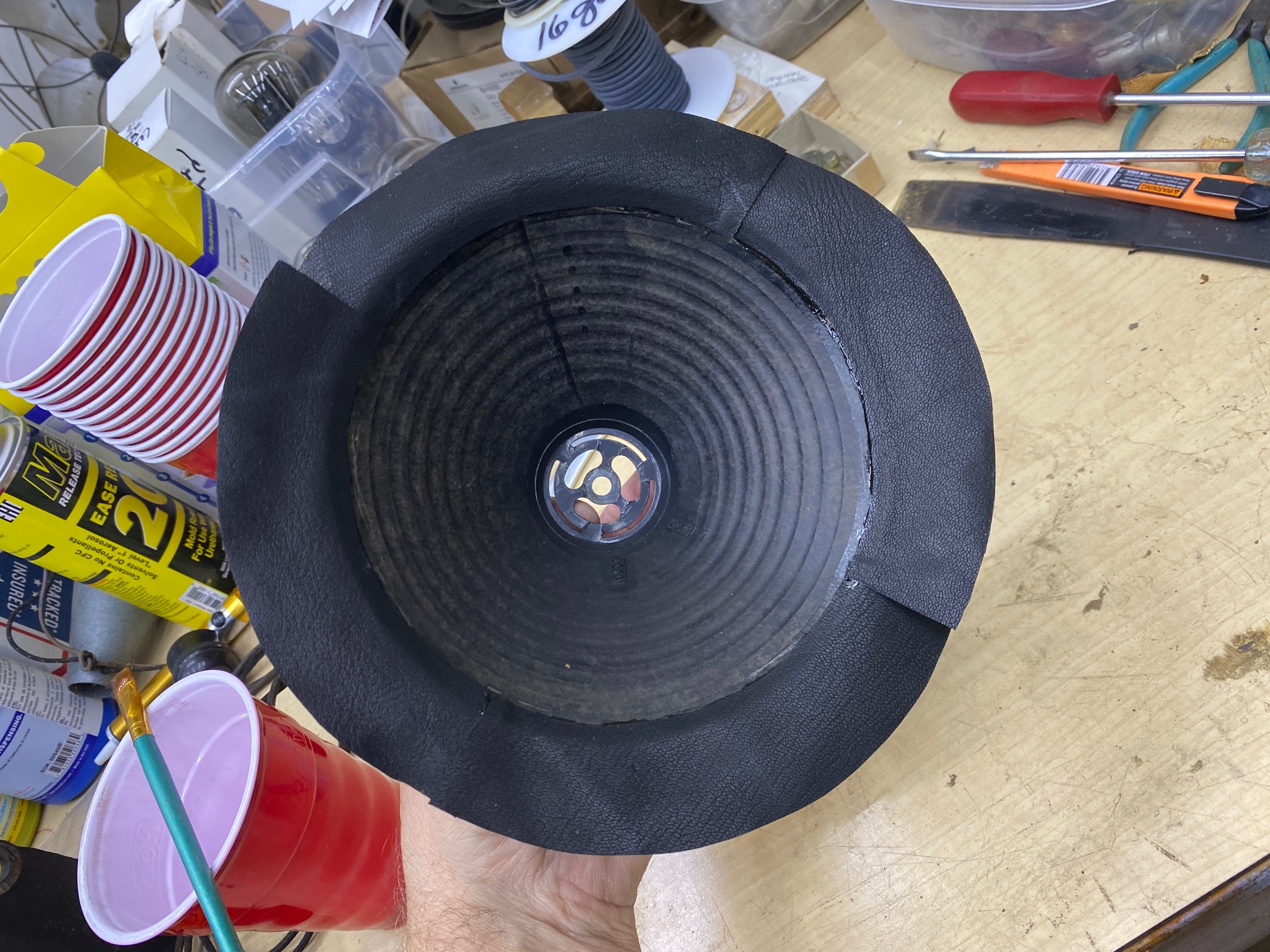

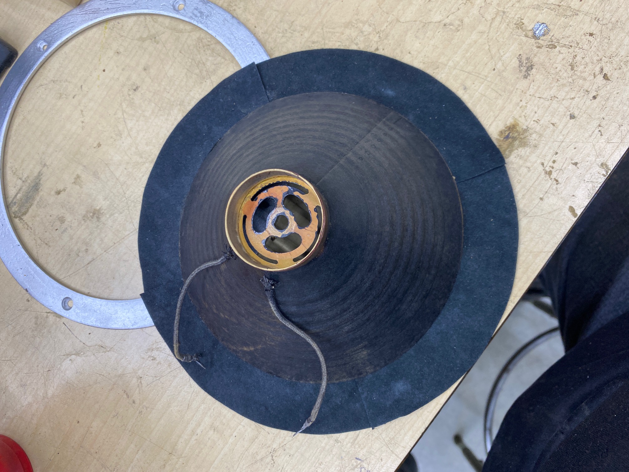

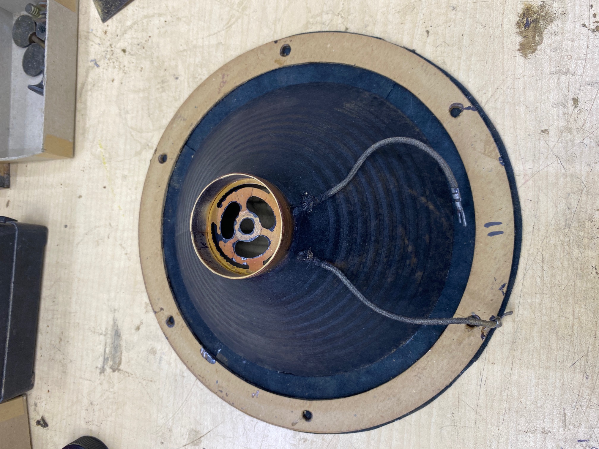

Claudio, You do not have to replace the speaker cone. You just replaced the leather suspension that is on it. I do this all the time. I will send images to you and Thiago in Facebook Messenger.
