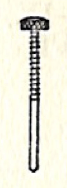

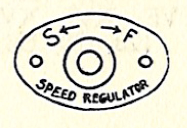

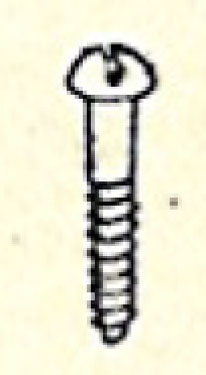

I have a Victor VV-IV A Table model Serial Number 399753. I've not had one before so I have to learn it. The speed regulator is missing and the turn table will not turn unless I manually lift the lever inside of the box. I cannot find a speed regulator for this specific model on line and I do not know how to install one if I do find one. Can anyone help me?

You need an escutcheon like the one shown, a long adjustment screw and two wood screws. George Vollema will have what you need http://www.victroladoctor.com/.
