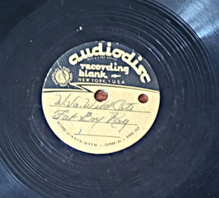

Hi, I'm new here! I recently purchased a Columbia BN machine and it came with 50
or so 78's. A couple of them have hand written labels. Some are in good shape, some are not.
As a newbie, I was wondering what tips anyone can give me as to the best labels, recording studios, who made the highest quality, etc.
Thanks in advance!
Hand written labels

Re: Hand written labels
The handwritten labels could be on test pressings, or they could be instant recording/home recording discs. As noted above, photos would help.

Do NOT play instant recording/home recording discs (possibly what you may have with handwritten labels). These had lacquer or like recording material laminated onto a metal or even glass base. They will not survive play with a reproducer like yours and steel needles.

Glad to help--at least, I hope I did! First off, your "handwritten" record is indeed a home recording disk, lacquer or the like on a metal base. It will not survive play with your machine.alienj wrote: Fri Nov 17, 2023 3:43 pm

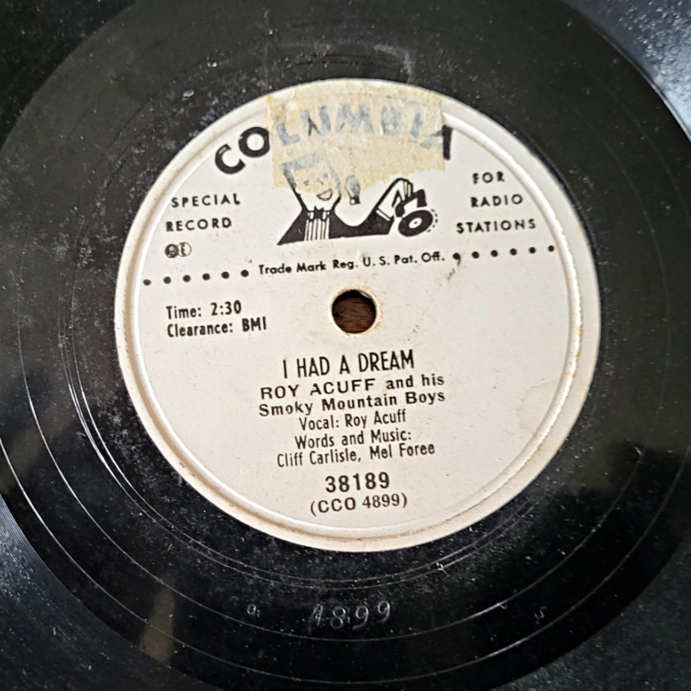

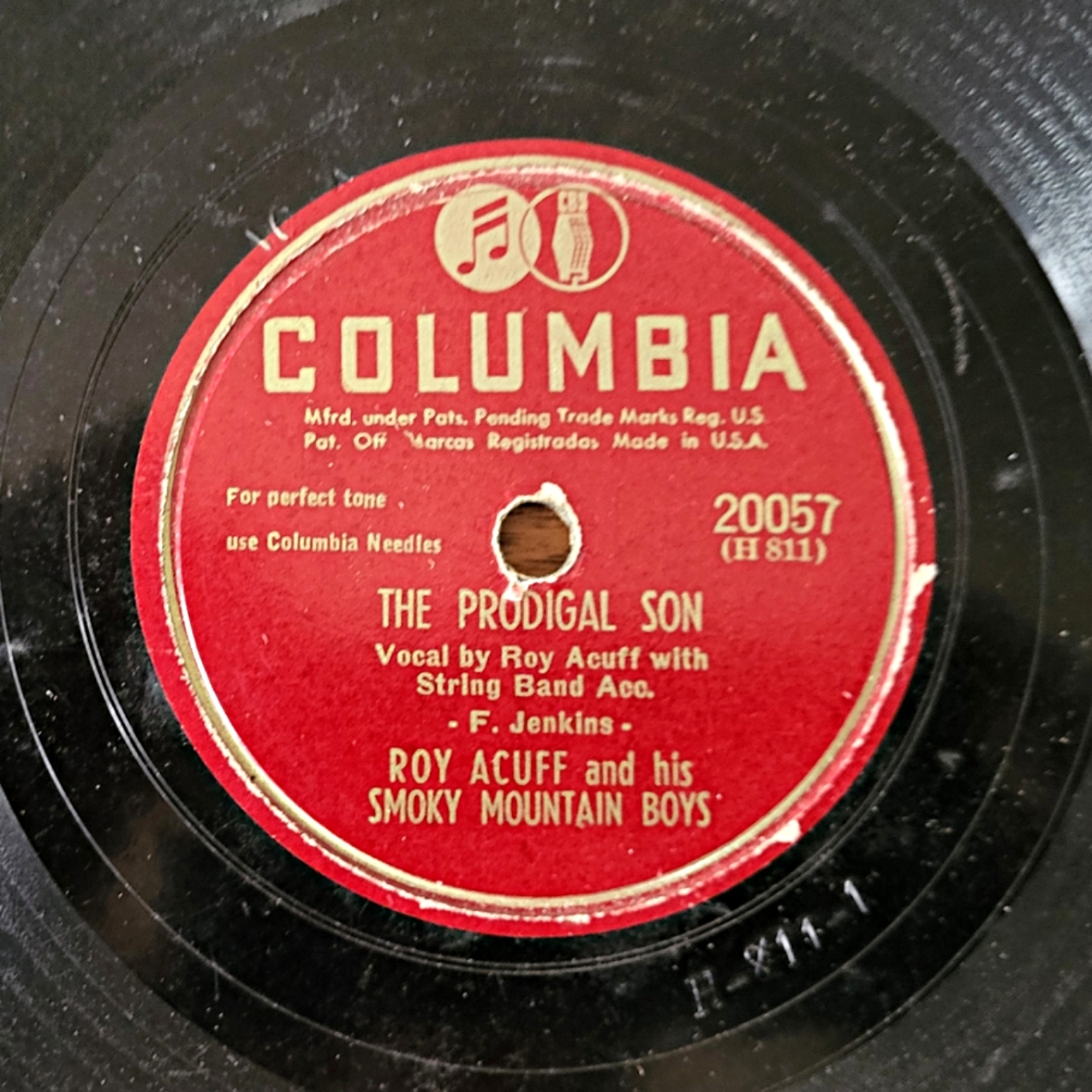

Columbia--They go all over the map. The ones you photographed are electrical, and I'd be careful with the white label one; as a DJ copy, it may (or may not) be a late vinyl pressing. In all events, much too late to be a good match for your machine. Red label Columbias like the one you photographed are '40s vintage electrical pressings, although the actual recordings can be earlier; a lot of jazz from the '20s and '30s got reissued on that label. Note the CBS logo, the "magic notes" in one circle intersecting a circle with a little microphone with "CBS" over it. When those are present, the record is always, or nearly always, electrical. Earlier Columbia labels with the words "viva tonal" are always electric. If the label has the notes in a big circle with "Columbia Grafonola" over them, it's always acoustic. If it refers to grand prizes at exhibitions, it's always acoustic. If it has what looks like bunting with the record data in a while rectangle, as in this eBay listing https://www.ebay.com/itm/155247240801, it's almost certainly acoustic. If it has a tricolor banner arcing across the label like in the article I linked above for Vocalion, it's always acoustic. One trick: as with Victor, look at the deadwax by the label. If you see a little W in a circle, it's an electric recording (made by the early Western Electric process, hence "W").
