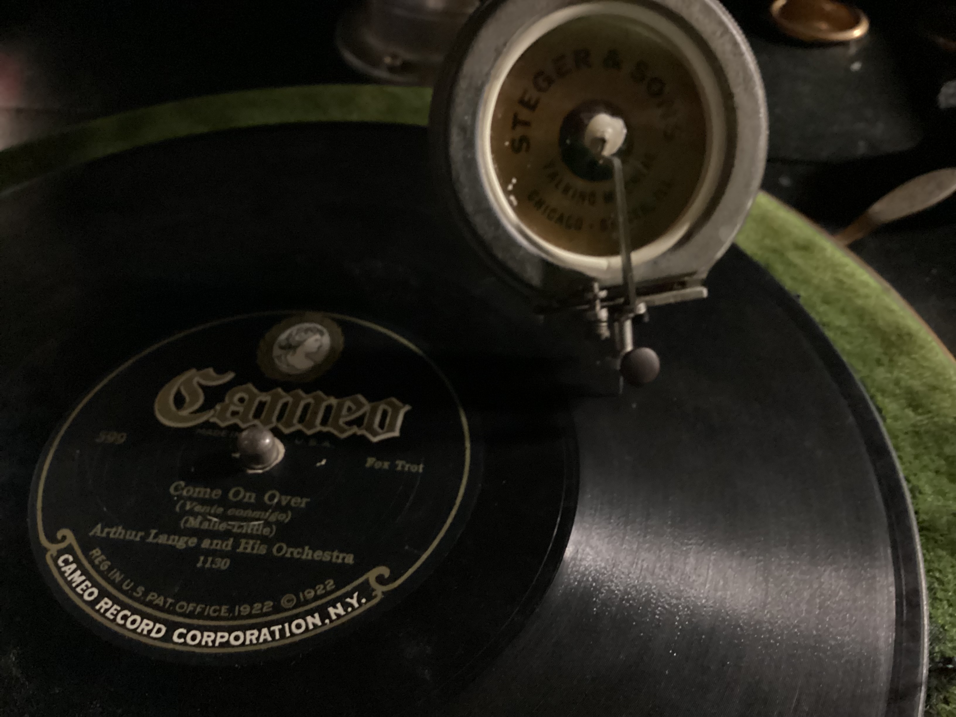

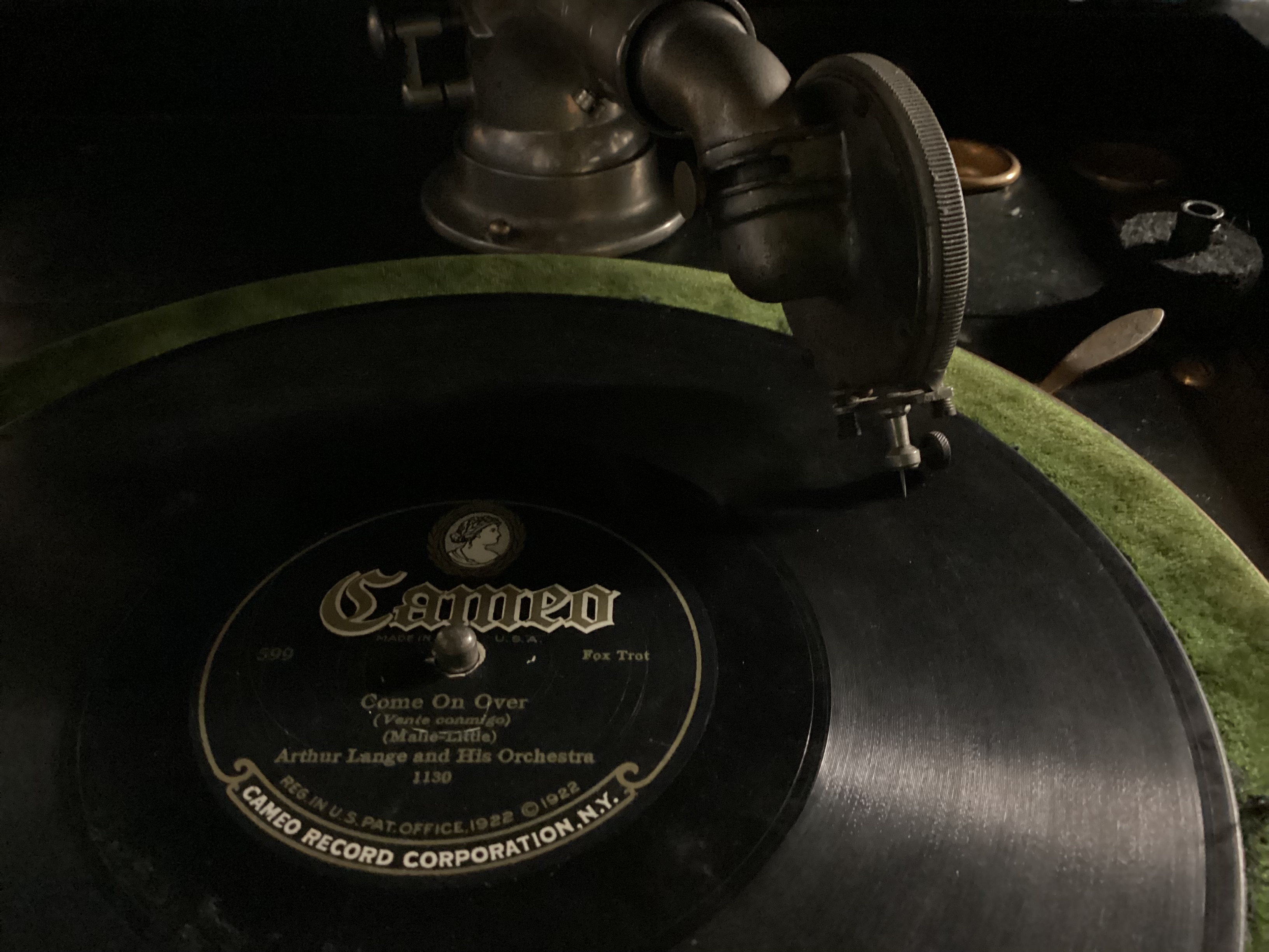

I have been having the question above for a while as Edison diamond discs have grooves the same size as basic 78s and the VitaNola has a twisting diaphragm to play both lateral and vertical records. :?:
Basic Lateral
Basic Lateral
Vertical (for a diamond disc)
