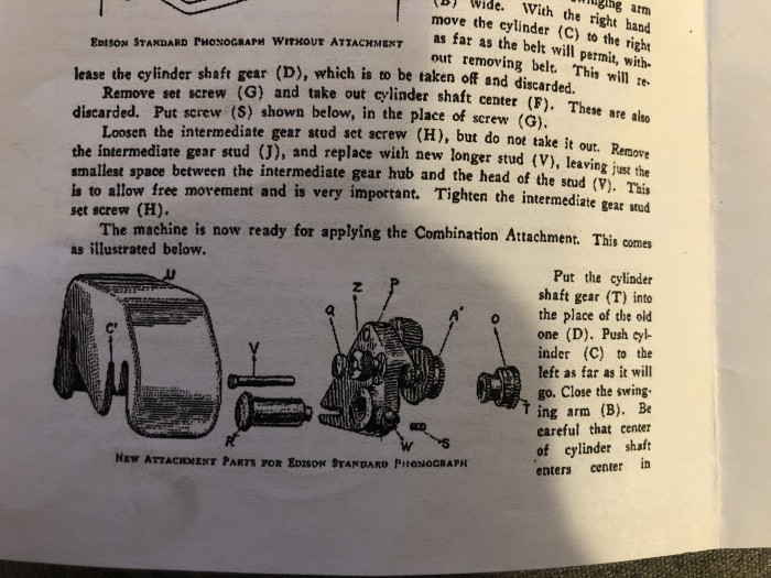

Can anyone tell me what the set screw (letter s on instruction sheet) looks like , it replaces the round head set screw on cylinder shaft? I didn’t get it with the kit I purchased ? Any idea where I can find one? Haven’t had much luck searching so far. Thanks

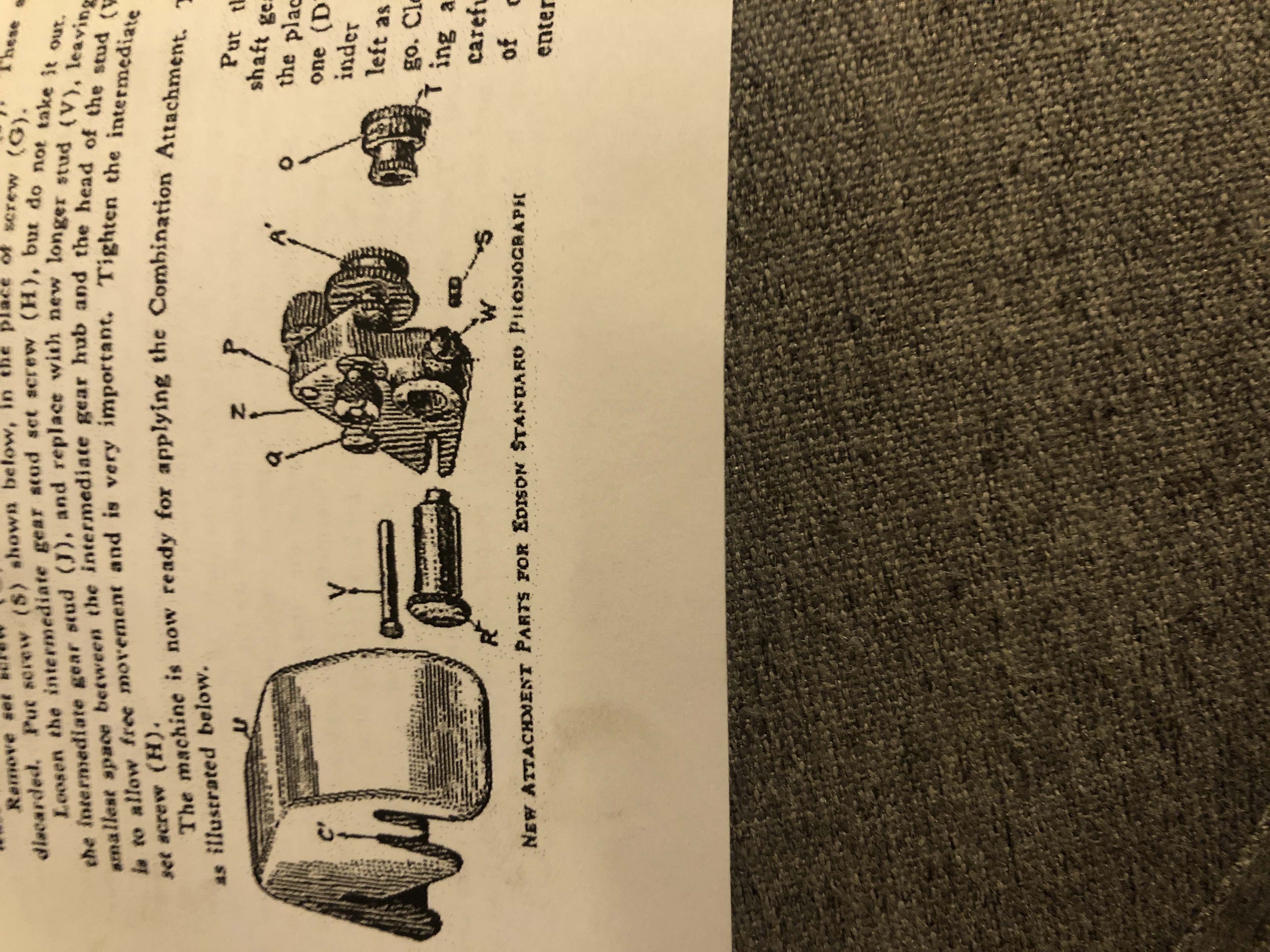

Ok here’s two photos , description and parts
In some pictures online it looks like a shorter flat screw ???

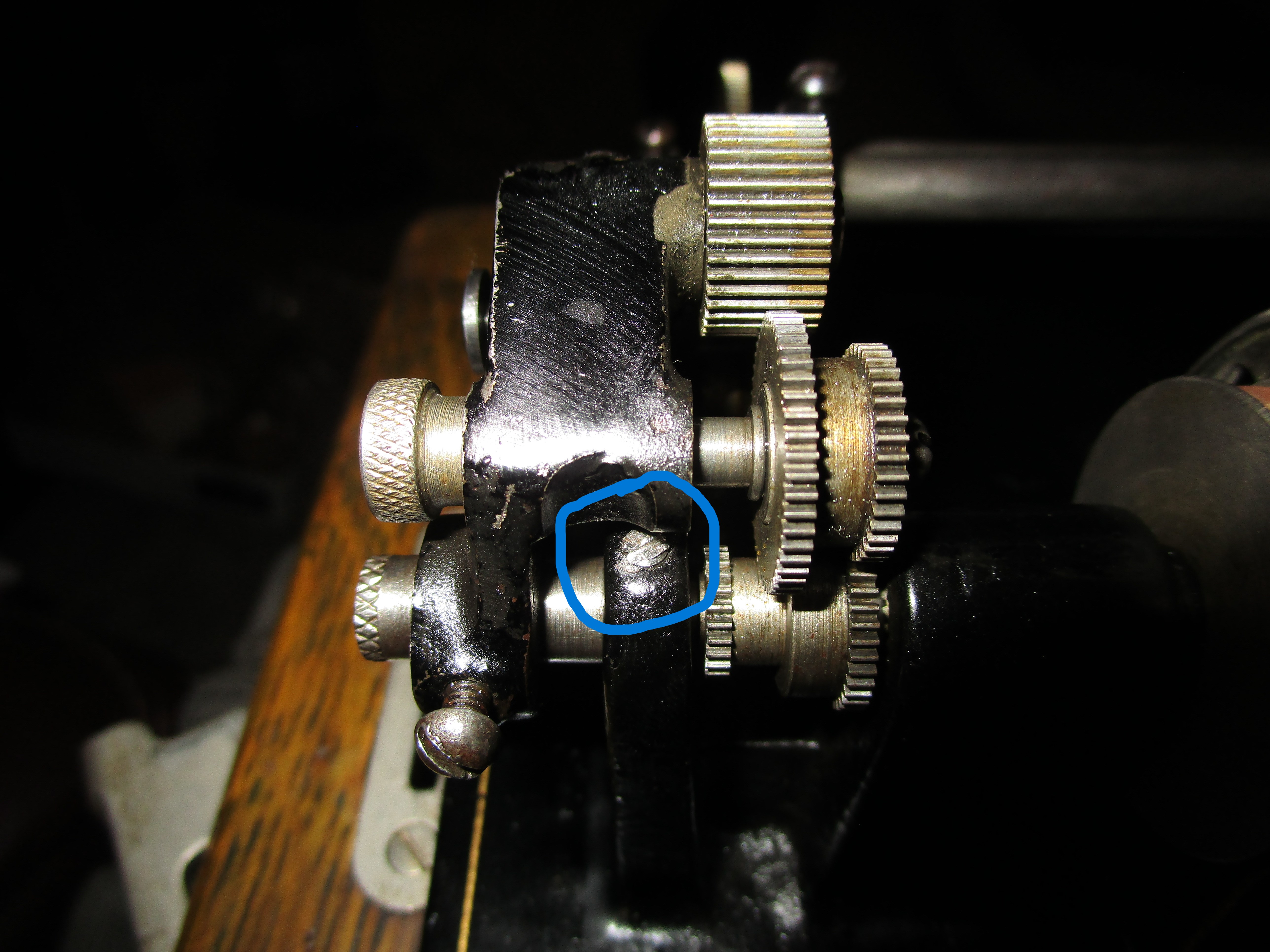

If you're referring to this set screw circled in the picture I provided it is a very vital screw that secures the "new" mandrel shaft bearing to the upper casting. Perhaps Parlier has one of these screws. The assembly won't function correctly without it.

Yep I found that out , it’s probably a standard size thread looks like 4-40 but I’m not sure of length or head style that will fit under the mechanism. I’ll check with Brian P thanks

The thread size is 5-40 but you won’t find that size in most hardware stores.
We have covered a similar topic previously.
viewtopic.php?f=2&t=53317&p=317098&hilit=Thread#p317098
If you can’t locate what you need elsewhere I can send a slotted 5-40 set screw, I bought a small quantity from Blacksmith Bolt and Rivet.

Mark That would be great , I’ll be able to get it working until, if and when I find an original screw . Let me know the cost and shipping. Thanks Dan

Thanks Mark, I received the screw and it works fine
