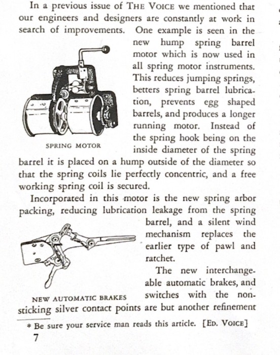

Here is an excerpt from a 1927 edition of The Voice of the Victor that some of you may find interesting regarding the redesigned spring barrel, grease seal and silent wind mechanism.

I've wondered about this design - - thanks for posting this excerpt, Mark!
Is there a repository for Voice of the Victor where they can be studied?

This later design of motors must be a bit rare, as I don't see it frequently on the motors for sale on eBay etc I wish I had one of these...

Thanks for posting Mark-- I've wondered about that hump-- Makes perfect sense.
Keep all your great tid-bits of info coming. You are a great resource-
