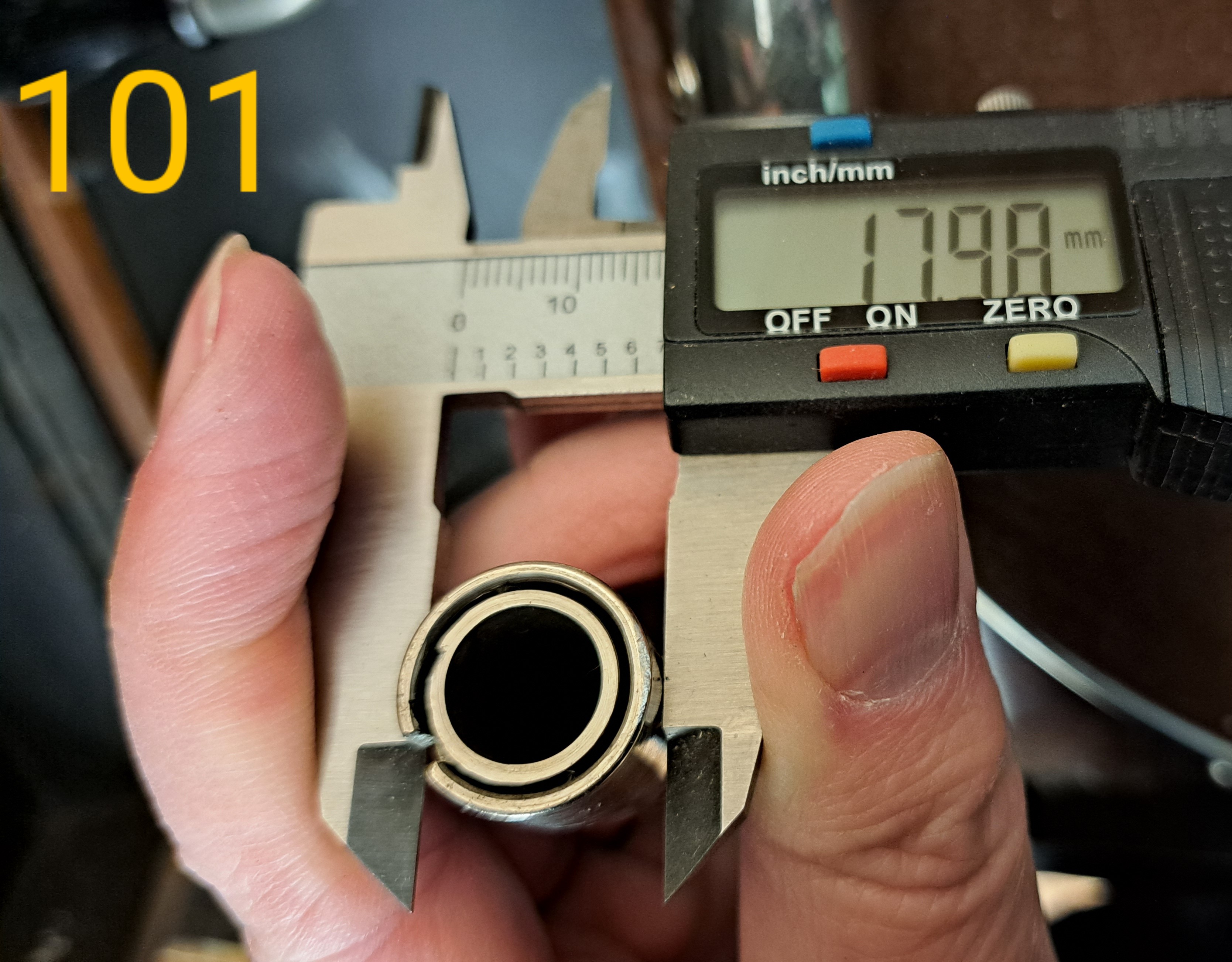

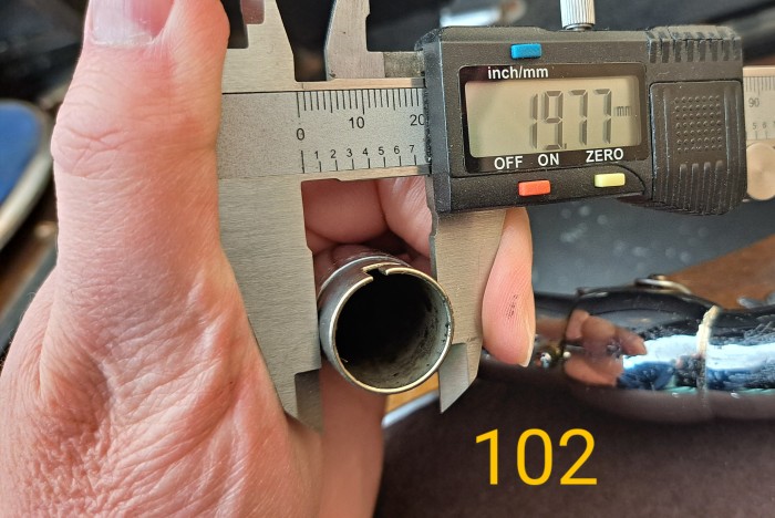

I have a question: Could somebody possibly help me with information about the diameter of the following tone arms: HMV 101, HMV 102, and HMV 145 (both on the sound box side and the horn side)?

Hi Tomasz, welcome to the group!
I only have some of the info, but I will post it here. Measurements will be approximate. I believe the 145 will have the same diameter at the soundbox end as the 102.
Hope that helps,
Hope that helps,
- Posts: 4672
Re: Tone arms - diameter MV 101, HMV 102, and HMV 145
All the reentrants from the 102 on, have the same tonearm diameter to receive the 5a/b and no16 soundbox: 102-104-130-145-152-153-158-163-193-194-202-203 and all other models from this era that take these soundboxes.
Indeed the difference is only in the 18mm/20mm tonearm end, but the rubber connectors are interchangeable, as they have the same outer diameter, that fits in the back neck of the no4/5a/5b/16 soundboxes.
