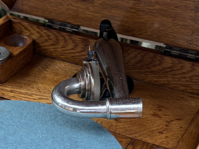

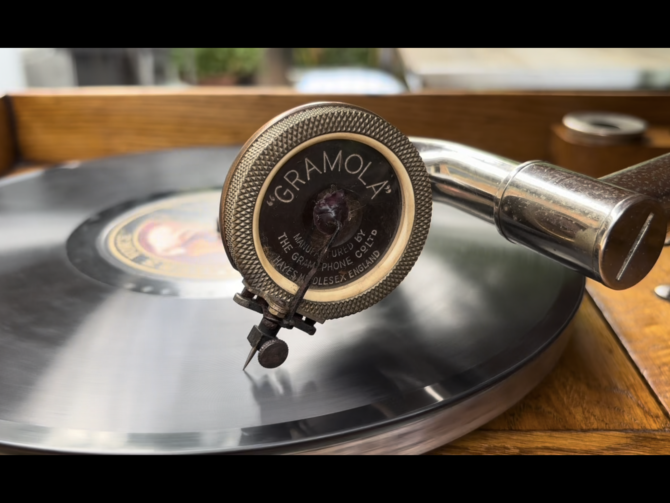

Greetings,
I recently picked up an Australian HMV machine (Zealand) which appears to be quite similar in style to the Victrola viii - it has a ‘Gramola’ soundbox which looks identical to the ‘Exhibition’ but without the rubber isolator - the back is solid brass, inc the connector which is part of the rear assembly. Is this normal not having a rubber isolator? I wonder if I can optimise the contact to the arm somehow..?

Gramola was a budget brand of The Gramophone Company and was built down to a price.
The all metal soundbox would have been cheaper to manufacture than the Exhibition.

Thanks to you both for points of clarification. Seems like the Gramola soundbox is a cheap knock-off the Exhibition, without the flexible rubber isolator - probably not great for records… Maybe I should concentrate on overhauling the motor as it struggles when I use fibre needles - they seem to last well on other machines however (when i harden them with wood hardener and the air dryer). Thanks again for your thoughts.

I do like the knurling on the face of the Gramola soundbox.

I suspect the differences between the Gramola and Exhibition sound boxes was as much to do with branding as cost saving. The absence of the rubber back would make only a small saving, and that lovely knurling would add a bit to the cost. There was also a slight difference in the diameter of the tone-arm and the corresponding socket on the sound box, presumably to ensure that the two brands were not interchangeable!
