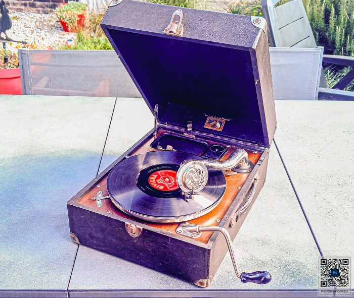

Hello,

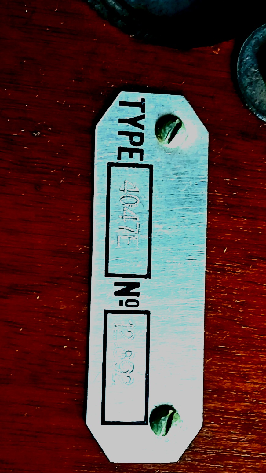

I am French and recently bought a gramophone from an lady (around 60 years old) who inherited it from her grandmother. The model is an HMV 4047E, with the serial number 12892. It’s a portable suitcase-style gramophone, with reinforced sides, covered in black leather and oiled wood. The platter is red, which seems unusual.
The soundbox doesn't resemble any of the typical HMV and she is unbred. However, the sound it produces is clean and clear, which suggests it’s in good working condition despite its age. I believe the machine is around 94 years old and has held up remarkably well, showing great durability.

It does not have its original soundbox. It should have an EMI Columbia derivative soundbox (also used on many 1930's period Pathé portables) with the embossed "dog and gramophone" in the centre of the fascia. I can't recall which number Columbia soundbox it is based on off hand but it is fairly commonly available. The red platter is correct. Obviously it is a French model 404 and not based on anything produced in the UK market at the time. It is closer to certain Pathé models - the case hardware and winding handle arrangement specifically - which is not surprising considering Pathé was also part of the EMI group monolith at the time.

By the way, the automatic stop cannot be disabled, and the serial said 12 892
