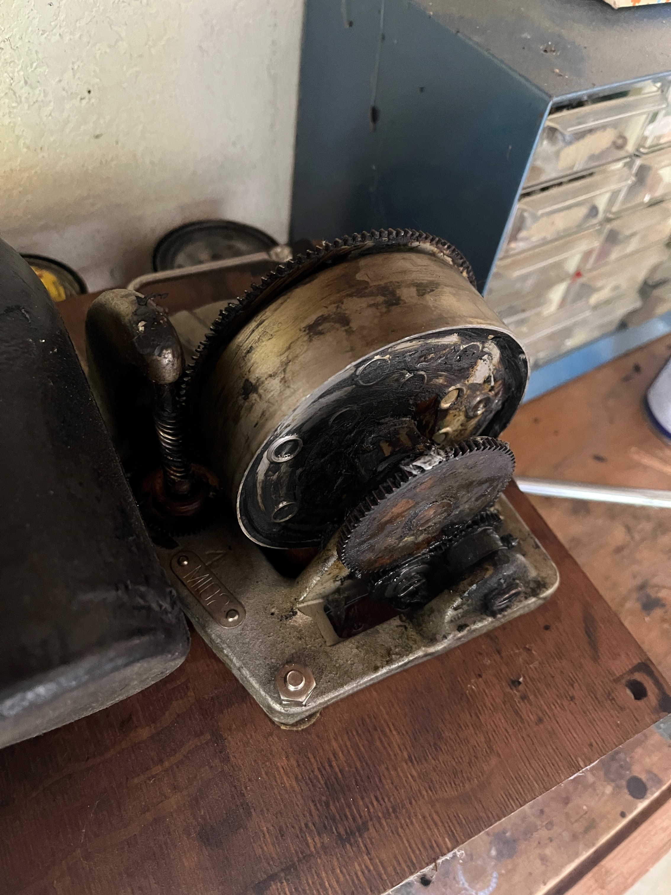

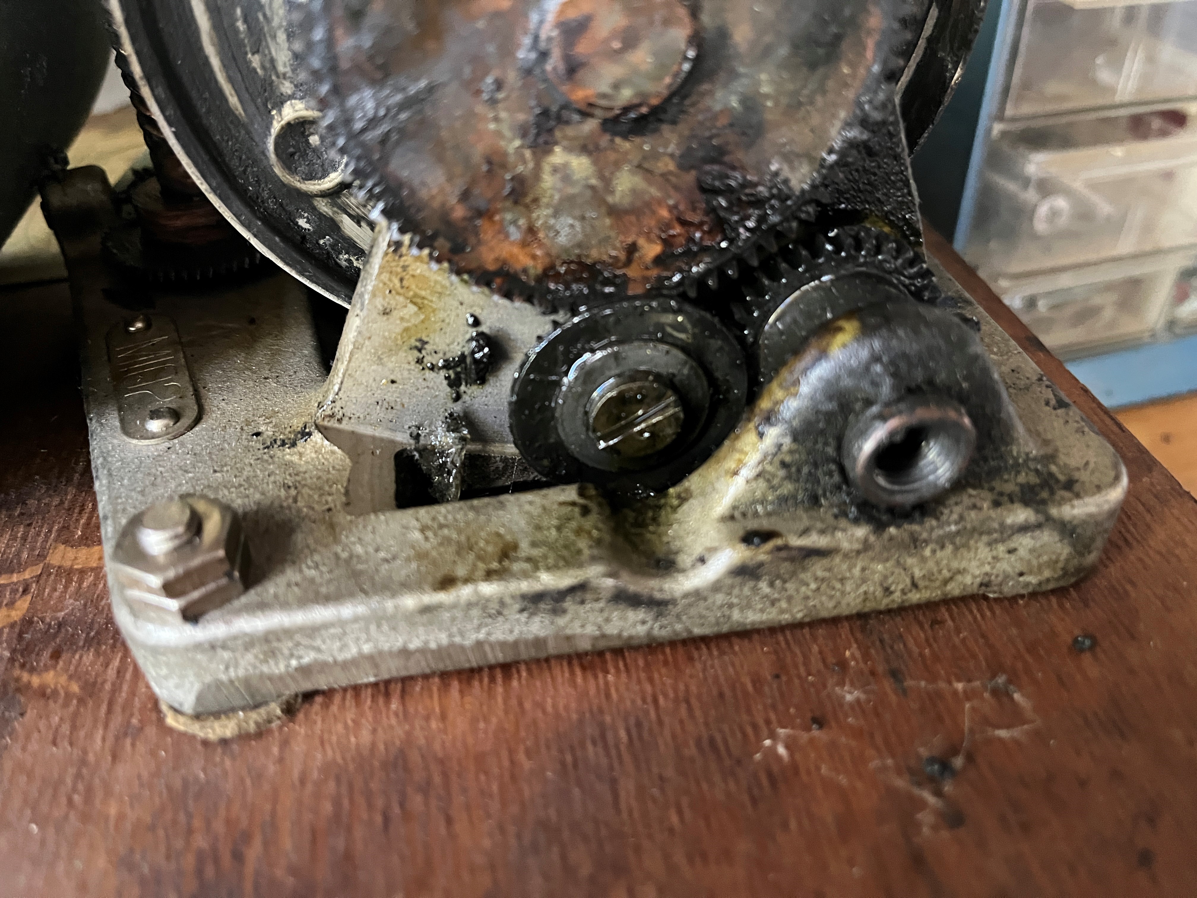

Can't seem to remove the screw to release the spring barrel. Has been soaked in WD-40 for several days. Anyone else have this issue when trying to repair this particular motor? Is there any chance it does not come un-screwed in the normal counter clockwise direction?
- Posts: 6831
Re: Portable Victrola 50 Motor Disassembly
I believe it's left hand thread, as you suspect.

Sure enough turning it clockwise let it be removed. I thought it might be that way as I consider that gear turns counter clockwise and over time would tend to loosen it.
