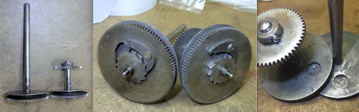

Does anyone know if the bad pawl from my Gem B part can be replaced for a good pawl from my Gem A part? (and who can get it done)
Thanks,
James.
Online
Posts: 6739
Re: WANTED: GEM B motor part
Can you post pictures of the A & B pawls?
Roaring20s
Posts: 2796
Location: Tucson, AZ
Post by Roaring20s »
Thanks for your response.
Here are more images.
The A has the long shaft for the key to wind it.

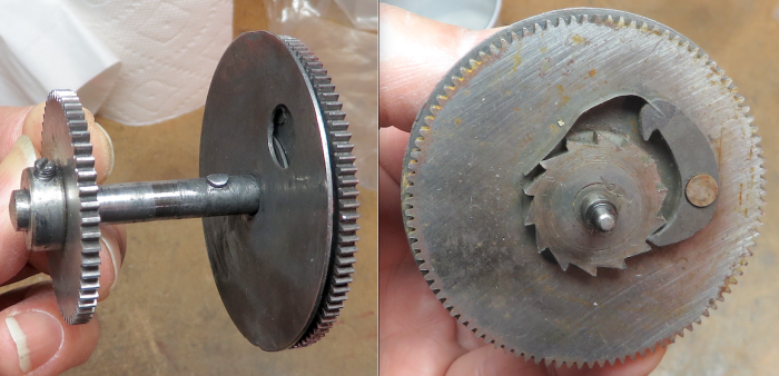

Hmm ... a simple solution may be ...
I measured the thicknesses of the shafts and they are the same.
It looks like I can shorten the A shaft and notch it for the set screw.
James.
And done ... a simple solution was in front of my eyes. :geek: :shock:
Thanks to Jerry for wanting to help and to see more pictures! :D
