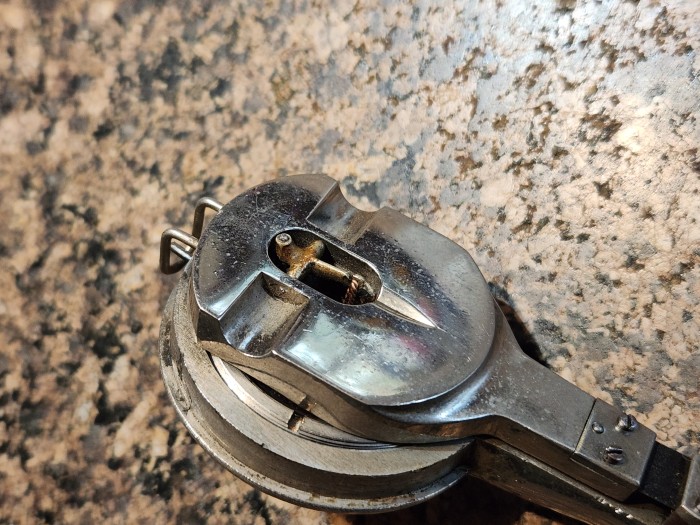

There was at least one "parts supplier" back in the 60s/70s who was using ball-point pen tips as replacement styli. A clear picture of your Reproducer's stylus might be helpful.

I don't know what material was used to replace the stylus; I've attached a photo but it provably isn't clear enough to tell.

The general appearance of the stylus seems okay. That doesn't mean it isn't worn, but at least it looks like an Edison stylus and not some odd substitute.

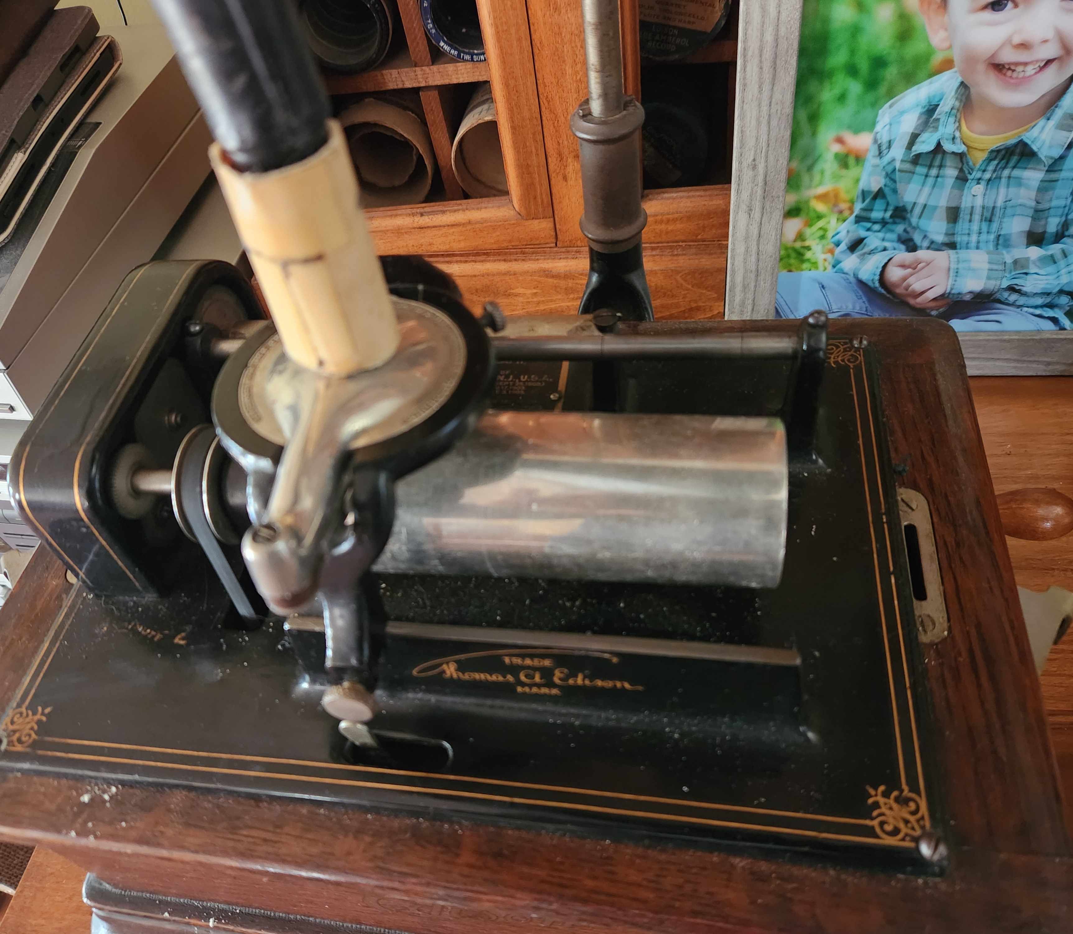

Maybe I should start another thread but, while I have your ear... What do you use to bridge between the cygnet horn and the reproducer? I'm currently using a roll of paper; till now it hasn't been a priority item but with the phonograph working well I'd like to get something more permanent in place.

I think they use a rubber tube... (I'm a profane on cylinders, but much interested in the forum and I follow every thread)
