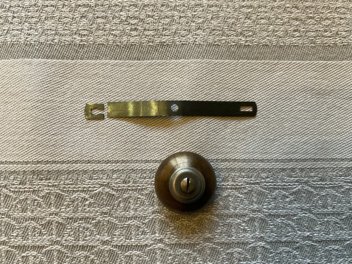

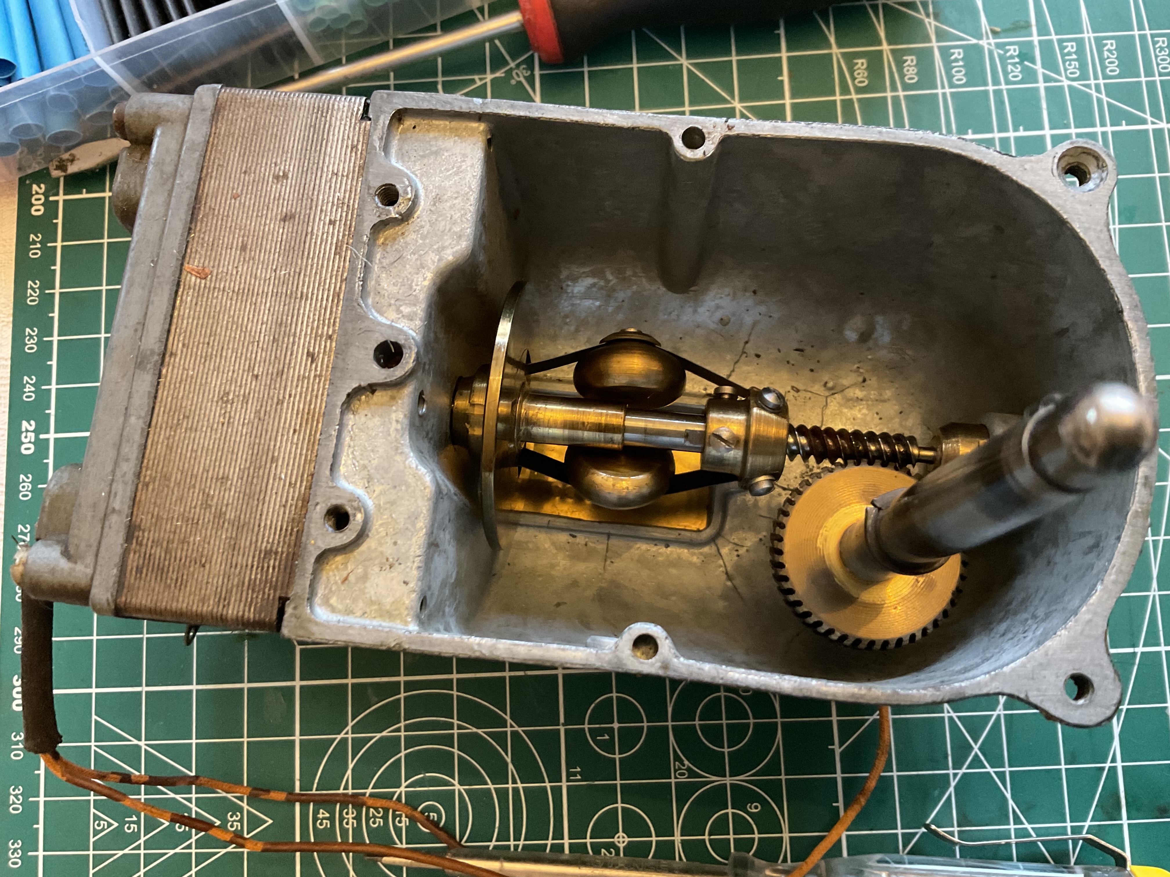

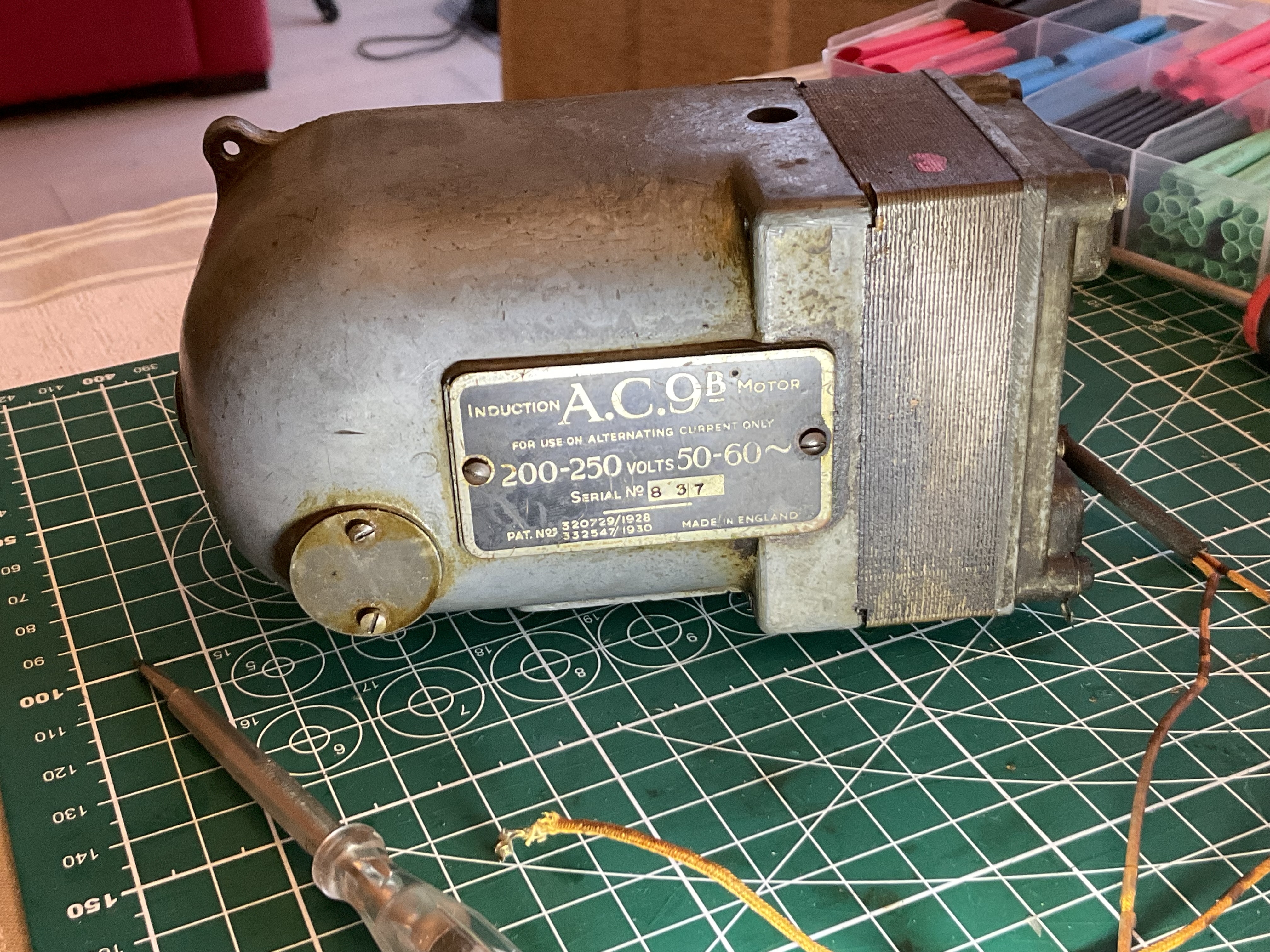

Can anyone help me, I need 3 governor springs for a Garrard AC9a gramophone motor. The motor is installed in a HMV495 radiogram. The springs are not standard, they are of the snap on type, one side without screws, the other side with screws. See photo.
Length =54mm, 4.75mm width and0.15mm thick.
Anyone out there with spares or who wants to sell me a replacement motor? I think it may have the same dimensions as the Garrard AC6, 7 and 8.
Springs from a Garrard 20 windup motor have two slots so might fit, so if anyone has those…?
Please help me repairing my HMV495…
Thanks for your help!

An update: zwarteschijf.nl has spare springs for this motor! they are not exactly the same, 2mm shorter. And have 2 slots on each end with a hole in the middle. They require a bit of adjustment of the screw holes, using a small round file that was super easy. The whole assembled unit is now 2mm shorter but seems to have little negative effect. The motor works again. :D
