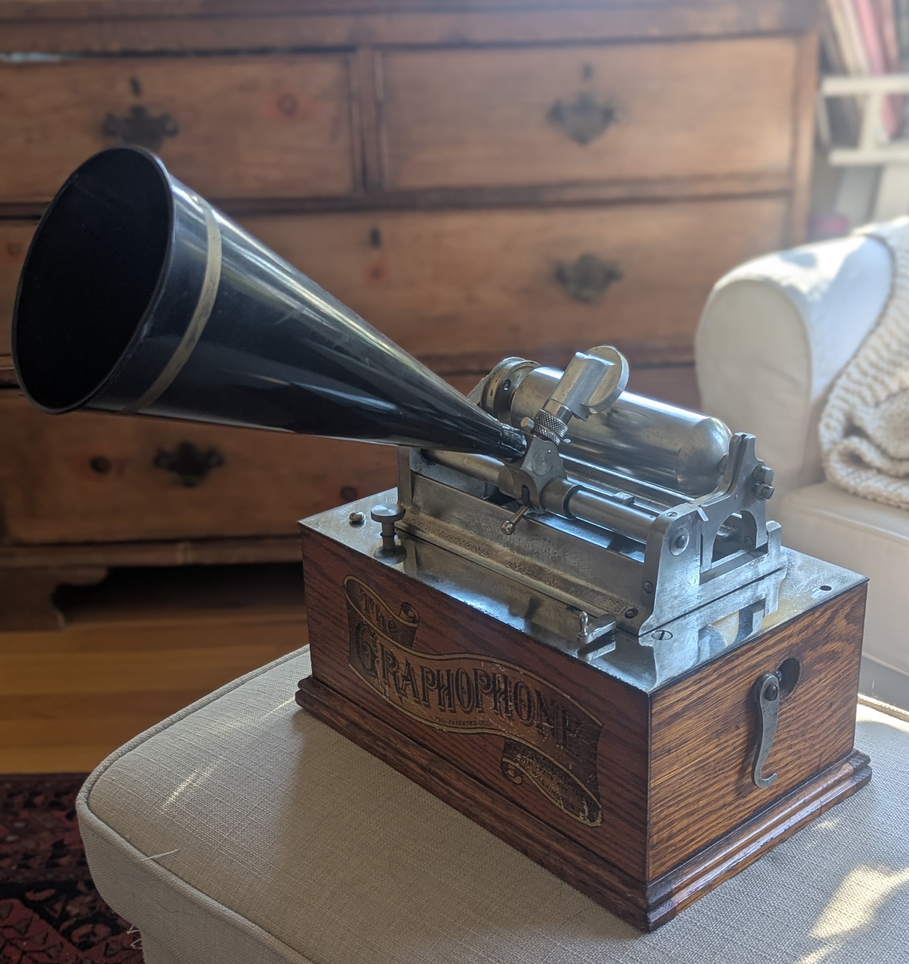

Here's an update on the Type N Graphophone my wife found last week for $55. It looked very rough when she bought it, but the price was right. I'm astonished by how well it cleaned up with Gojo and polish. It's just beautiful--very shiny nickel plate with only mild pitting, bright aluminum, and a beautiful finish. (I've attached the before and after pictures.)
It had clearly been neglected, but not abused, for decades. The crumbling remnants of an old belt were lying in pieces on top of the bed plate. What looked like rust and corrosion in the photos was actually just grime. The Columbia #4 reproducer is in great shape. I tested it on another machine, and it played loud and clear. I was considering selling it to defray any restoration expenses--including (eventually) a much more expensive gutta percha reproducer--but I'm guessing the Columbia 4 has been with the machine for many years,
I'm now focusing on returning this machine to playing condition. It runs on what appears to be a strong spring, but I'm sending the leather gear out for restoration. I have a serviceable (but woefully incorrect) crank, which will do until I find a truly authentic example.

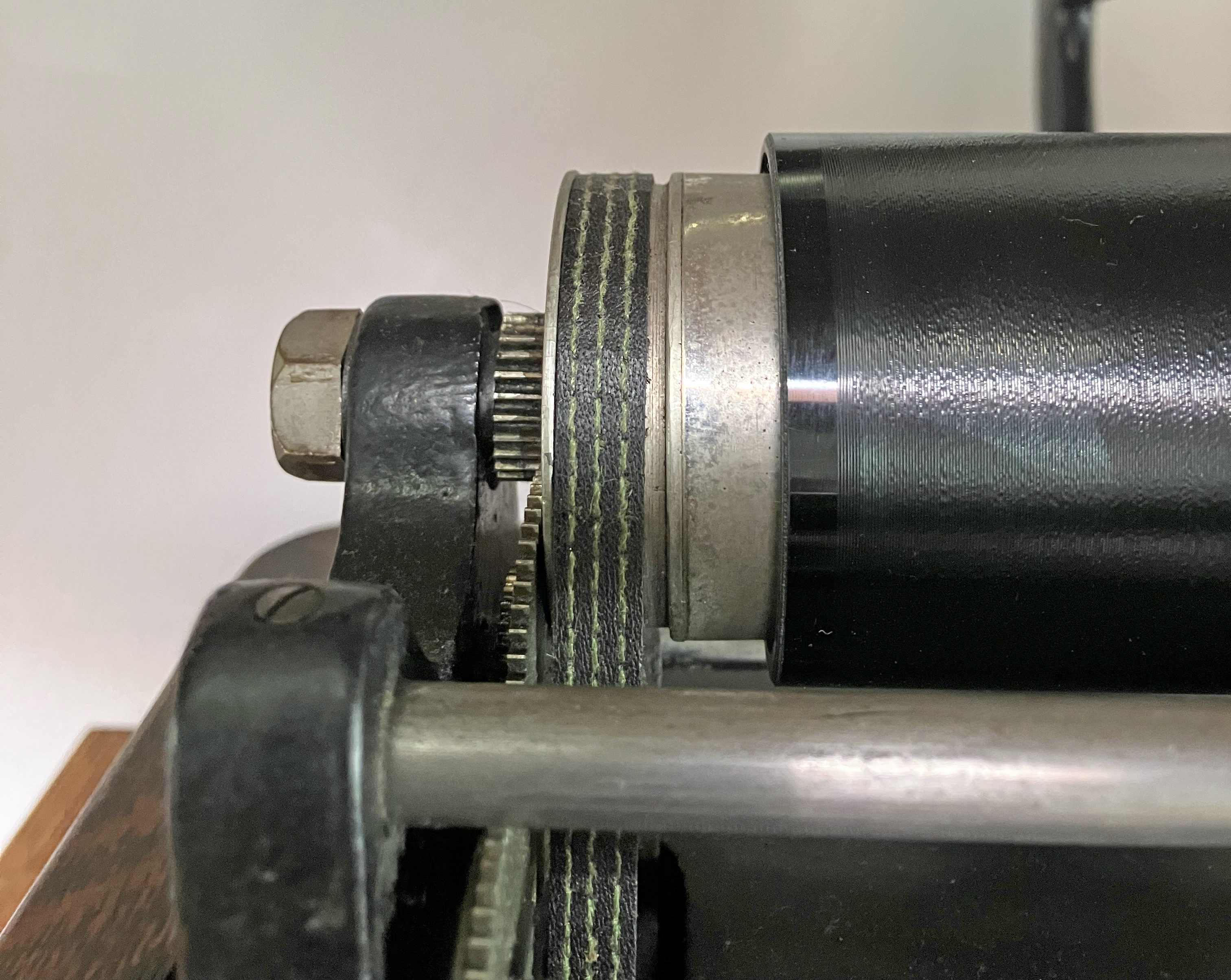

The stitched belting is expensive but it is the best looking and most historically accurate. I've used that on my Type G, N, and A Graphophones. For reference, below is a picture of an original belt on my BO. (I also have an AB with original stitched belt.)
A key difference between originals and the replica belting is that Columbia made an invisible splice prior to stitching, so it's perfectly consistent throughout. With the modern replica belt there is inevitably a visible splice, but when done carefully it's barely noticeable.

TinfoilPhono wrote: Sat Mar 01, 2025 3:14 pm That looks amazing!
Thank you! I'll go with the stitched belt and try to be as precise as possible with the splice.
