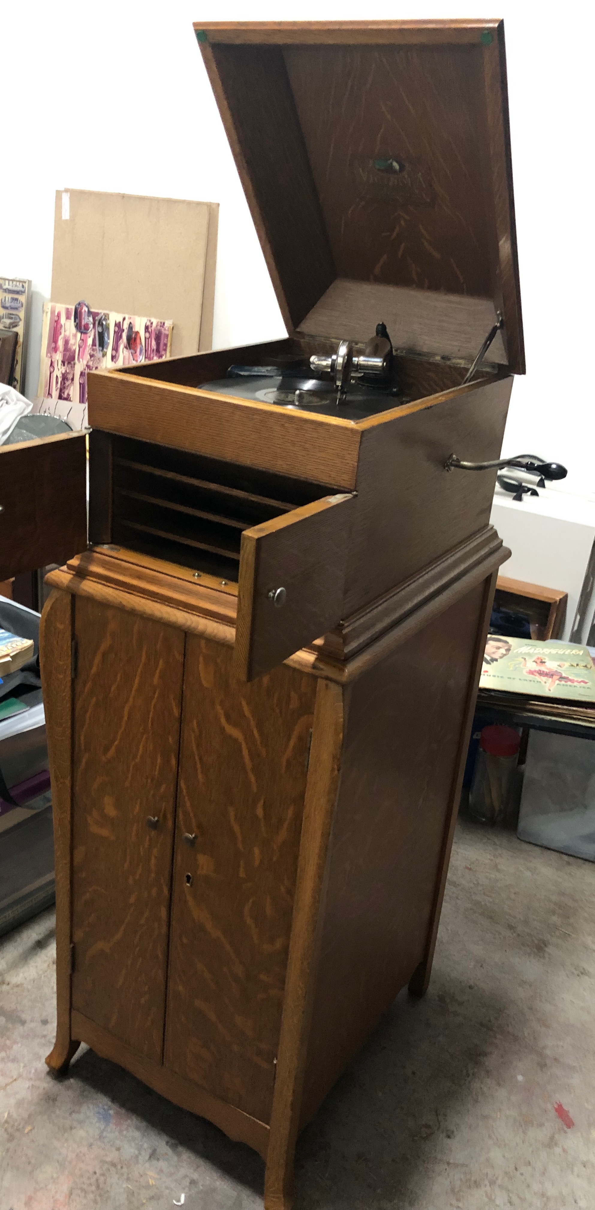

I have this VV-VIII with a perfectly matched oak record cabinet. It has a lock which fits a Victor key. I was wondering if Victor may have manufactured it, or if all these matching cabinets for table models were being made by outside companies.

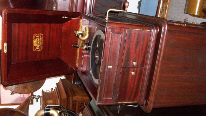

I have a matching cabinet for a VV-XII. I'm away from home at the moment and can't look but I'm quite sure it has a "Victrola" decal on the inside of the door. That would imply that, yes, Victor made some record cabinets. But I'm not so sure. I believe most matching cabinets were made by "The Cabinet That Matches" company. That company must have worked very closely with Victor. If Victor purchased complete but not finished cabinets it would be easy to apply a "Victrola" decal. So my official answer is yes, maybe, and I don't know.
