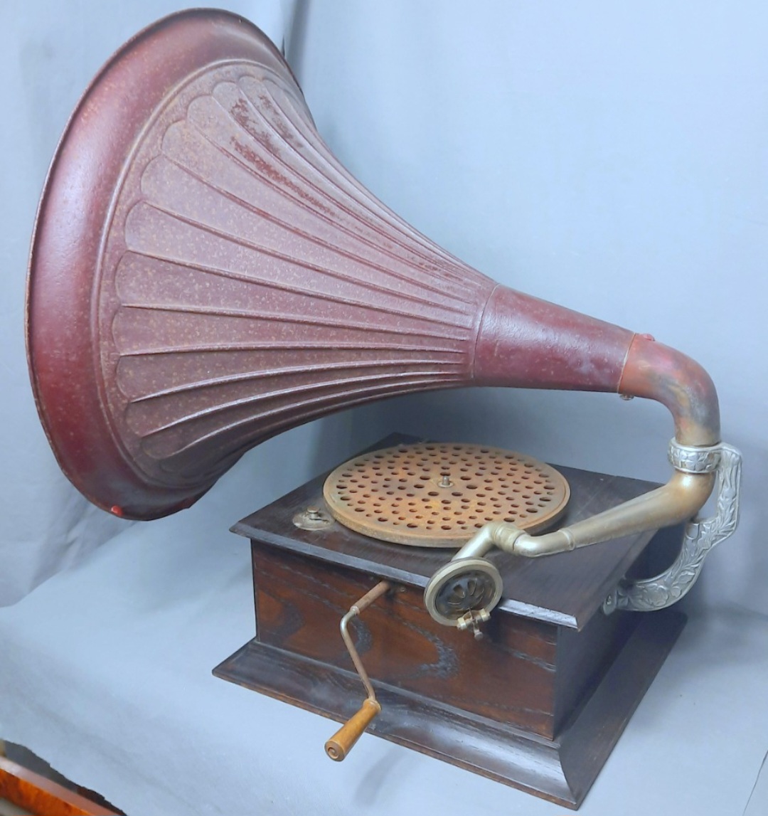

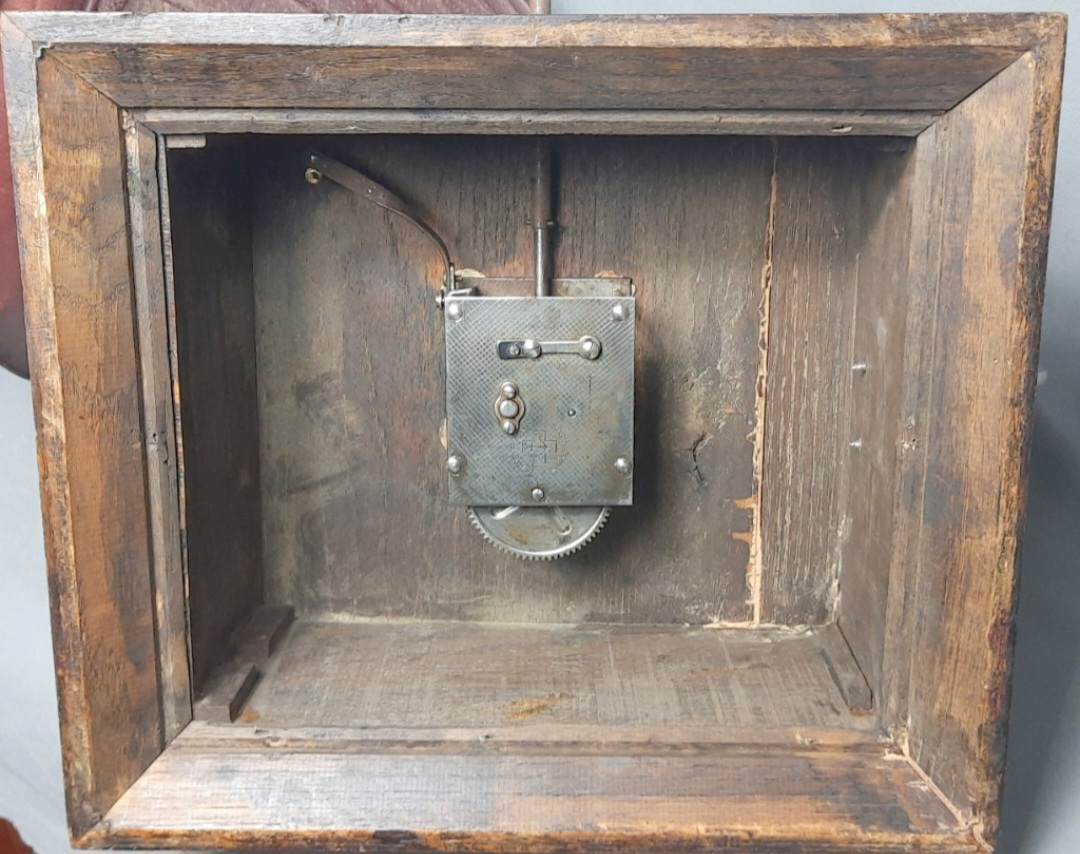

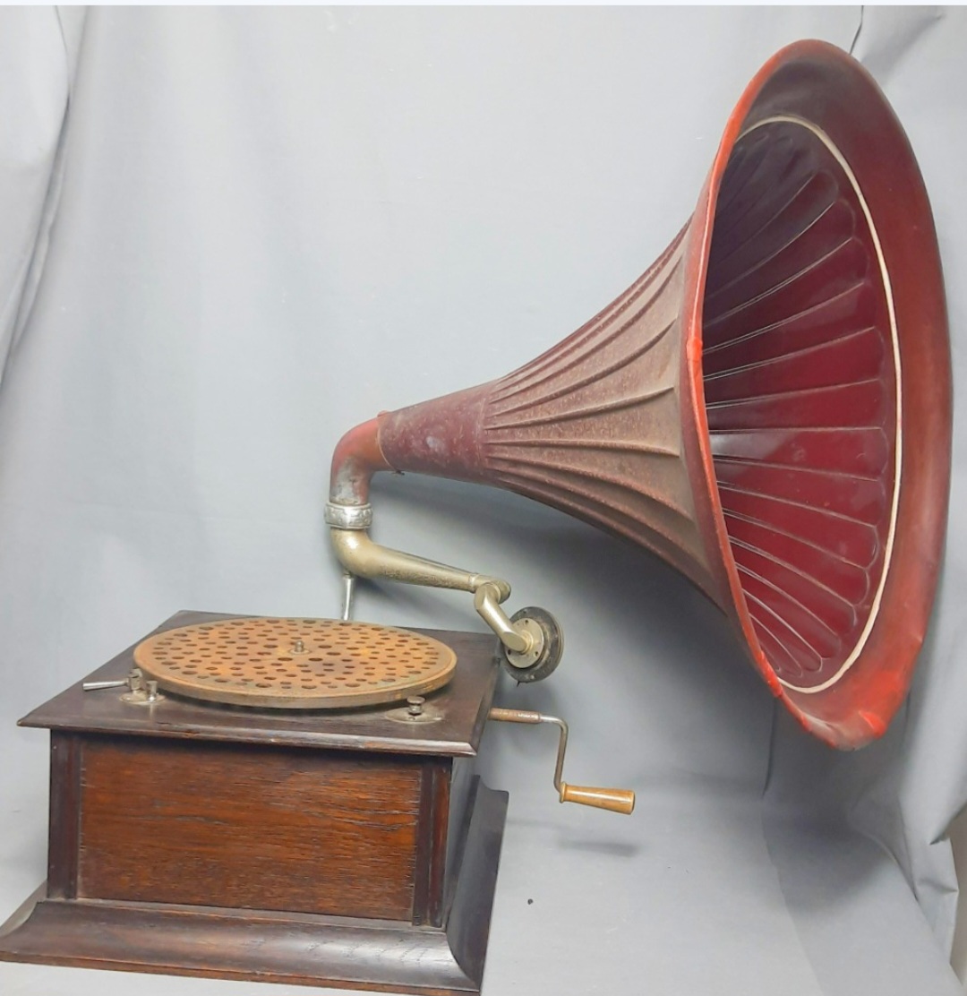

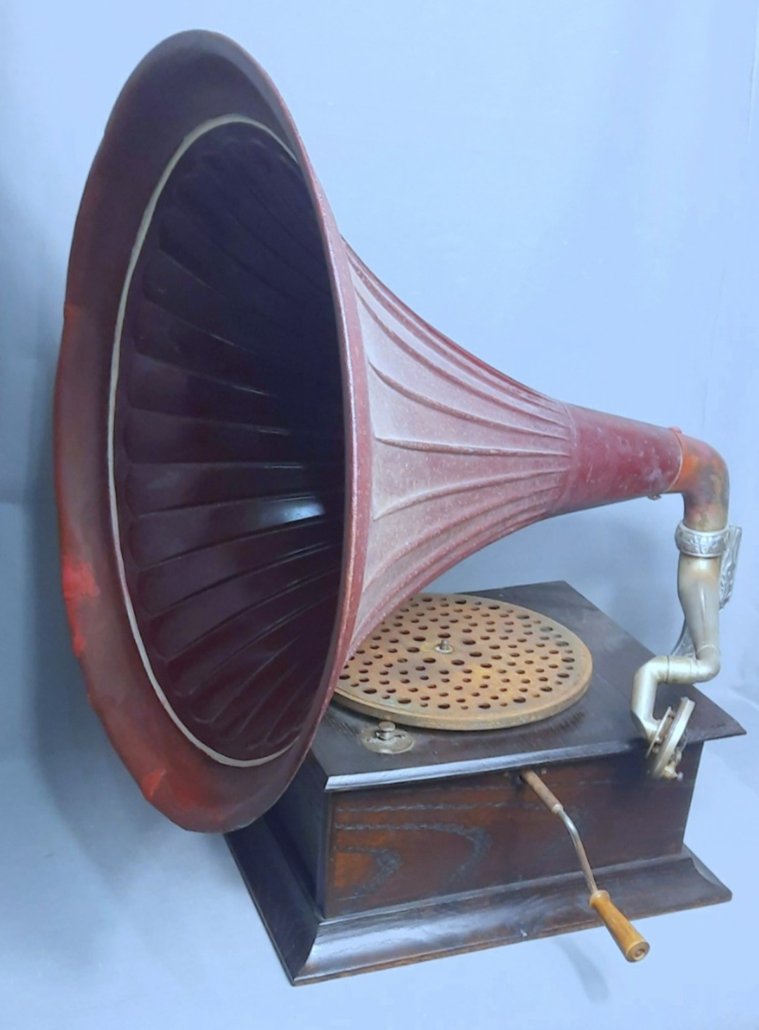

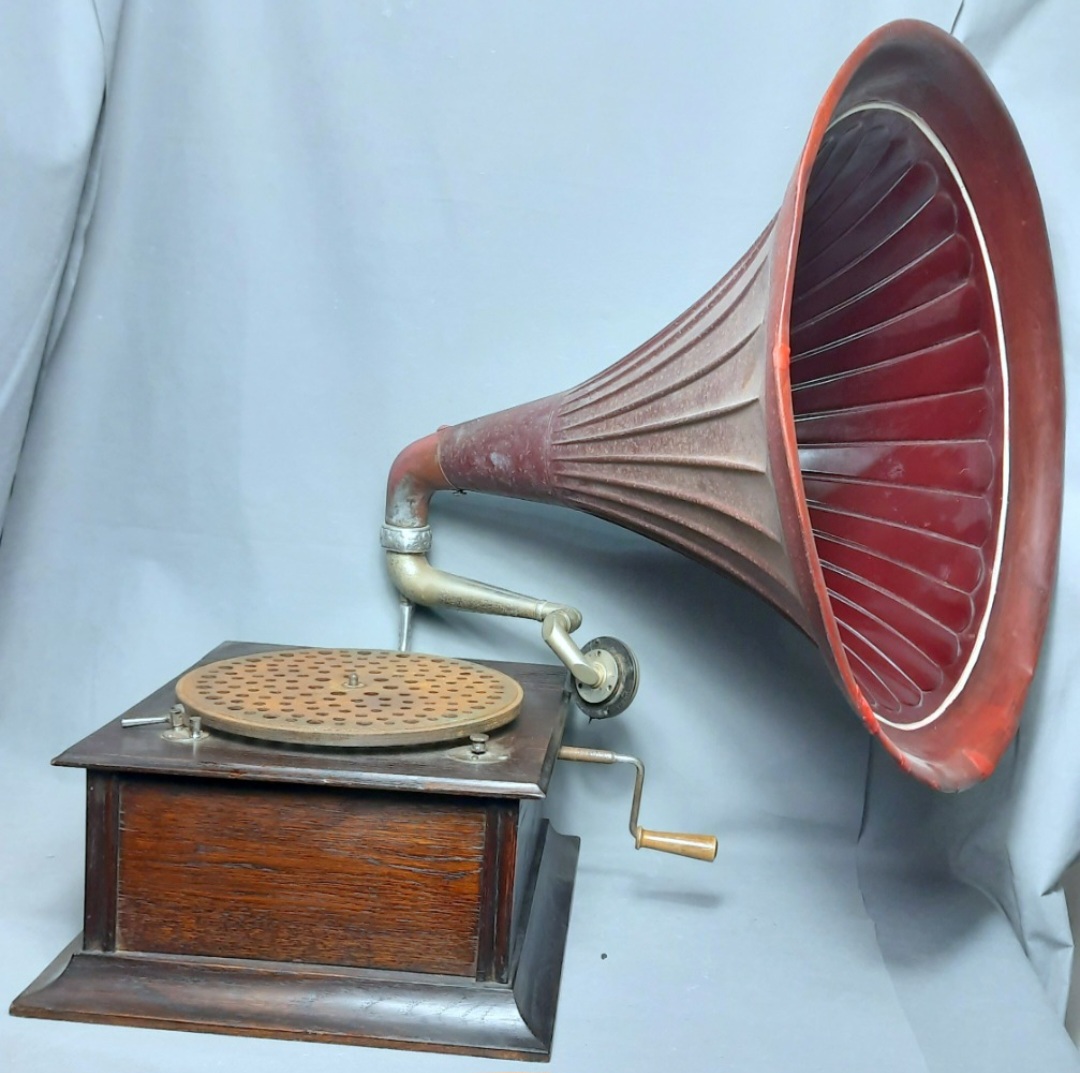

Hi, is this an original Thorens machine? Obviously the tone arm and soundbox arent from this, but what about the rest? I'm a bit suspicious of the back bracket, seems quite new. I checked some thorens catalogues, but found nothing quite identical. Thanks in advance

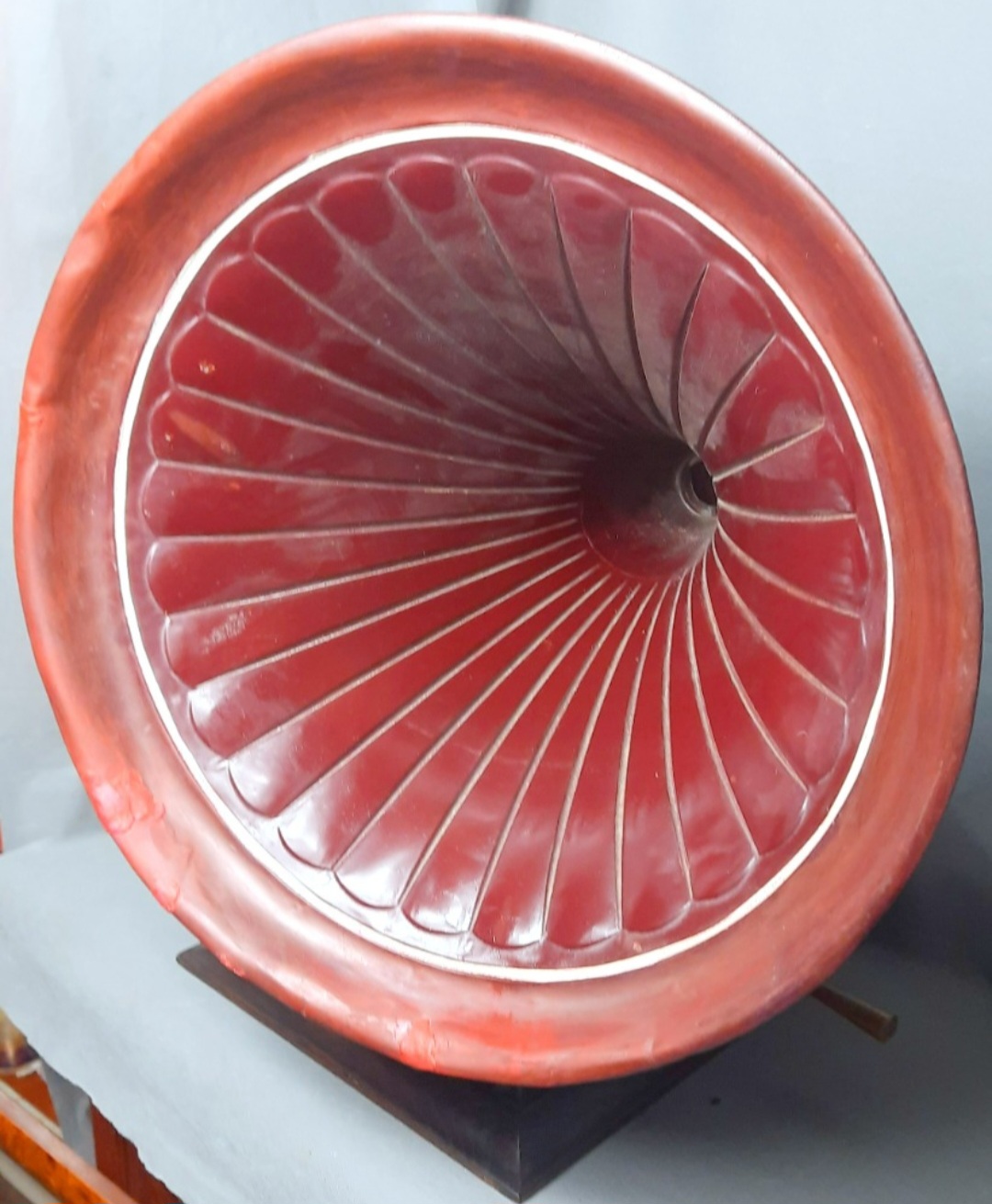

I don’t recognise the back bracket as a commonly reproduced pattern. That said it looks kind of new and the screws (rather than bolts) holding it to the case are not usual. Along with the Plano Reflex tonearm end and the 2 screws fixing the horn to the elbow this appears to be a frankenphone made up of old parts. The horn looks like it’s been filled round the edge, car body filler on rust damage? The front columns which do not go round the corners and are not found on the back suggest the base may have been a hornless model.

Machines like this show up somewhat often. In a lot of cases, they tend to defy explanation as to their origins. "Frankenphone", as Jamie suggests, is one possibility. Here in the USA, many collectors just use the word "European" when all other insight fails them. (Better than saying "I don't know", I suppose :lol: ) I sometimes tend to think that they were made in small, local shops, using vendor supplied components of various brands and quality. My belief is that this was done in the latter days of outside horn phonographs, or even well past that era, (maybe the 30's - 50's). Hence, your later era Thorens motor paired with other components of uncertain, unrelated origin. I guess that maybe defines the term frankenphone. That's not to suggest that it was made 5 or 10 years ago, or that it's the lowest of the low: a Crapophone. :)

However looking at the pictures I think your cabinet with motor is legit. The horn is stunningly nice. The back bracket is also not the usual Indian casting, and the tone arm seems to be correct up to the first bend. Does the needle in the soundbox meet the center of the Turntable? If not then the columbia addition is the piece that is wrong. If it does, then different original pieces have been wrongly built together.

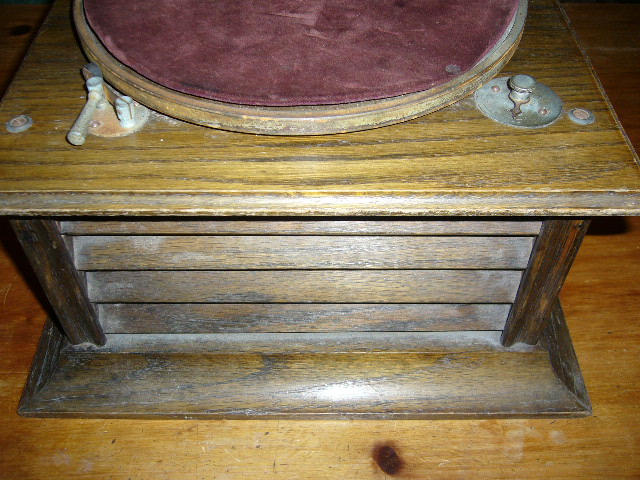

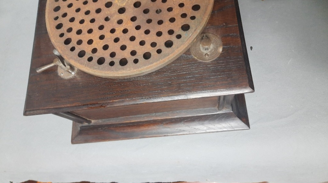

I looked closely at the photos, and noticed that the patina under the front panel didn't quite seem to match the other sides. Also, the glue blocks in front are different from those in back: this may indicate a conversion from a 'hornless' model.
I still favor the 'Frankenphone' verdict (not a 'crapophone', as there may be no modern mechanical parts, but a machine cobbled together out of parts original to other machines)...

The rectangular shape is also an indication of a hornless type machine where the tonearm is fixed toward the rear of the motor board rather than the Victor pattern where the tonearm projects from the back side panel.

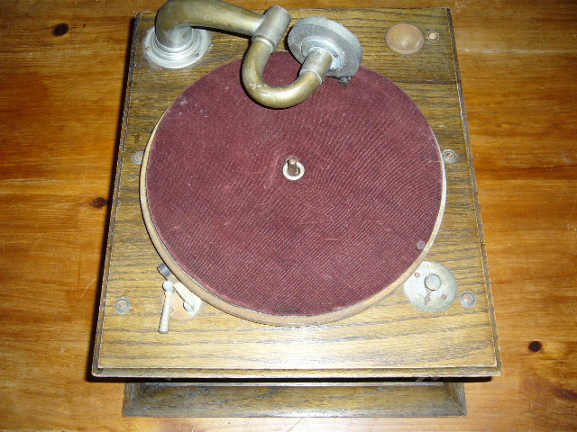

Originally I suspect it looked something like this, if not the same, with slats between the front beading:
Jamie

Thanks! It certainly does look that way
