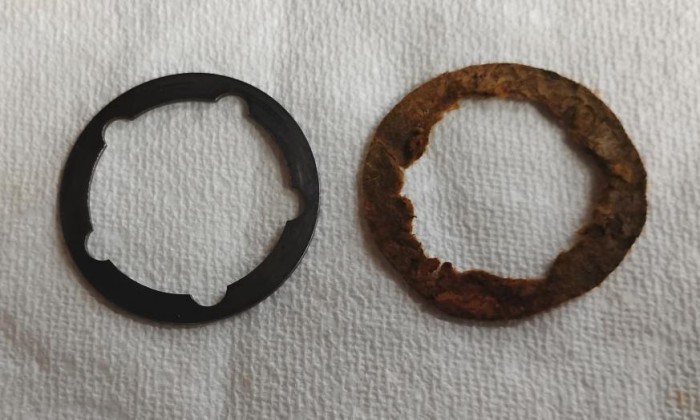

I apologize for this being a duplicate post of sorts. I am just trying to gather more thoughts/opinions about something I found while disassembling a VV2-55 tone arm, and a post focused on this single issue might be more effective as the original post wanders organically here and there as these things can often do.
Under the ball bearing spacer in the ball race cup, I found a thin felt washer. It was thoroughly impregnated with grease. My seemingly later VV2-55 did not appear to have this washer.
See image from other post: download/file.php?id=209989&t=1
It does not seem that the (broken) arm support bracket had ever before been separated from the ball race cup; there was no visible evidence of this anyway.
Does anyone know if the felt washer is original?
JerryVan is of the opinion that I should not put it back. It is a bit ragged. And perhaps it is not necessary as it appears to have been omitted in a later model (if indeed it is an original thing).
I will probably start to reassemble an arm in a few days (waiting for paint to cure), and it would be interesting to know if anyone else has ever encountered such a washer in a VV2-55 tone arm assembly.

Lah Ca
Posts: 1391
Re: VV2-55 Arm Question -- Felt Washer Under Ball Bearing Spacer
Post by Lah Ca »
JerryVan wrote: Sun Aug 03, 2025 8:04 am If it were mine, I'd omit the felt washer. It can only serve to impede the free rolling of the bearings.
JerryVan wrote: Thu Aug 07, 2025 11:54 am I'll revise my previous advice slightly to state that if the inside diameter of the felt ring does not lie within the path of the balls, and if the thickness of the felt is not so much that it causes drag on the base of the tone arm, then it probably does no harm and may even hold grease that acts as a joint sealant.
As you are, I'm also interested to see if others have found the same piece of felt in their machines.
I tried assembling the arm both with and without the felt washer.
The movement of the arm was definitely quieter with the washer in place, but then the arm was only ever noisy (without the washer) if I moved it back and forth at a much faster speed than playing a record would do. Moving the arm without the washer in place at about the same speed record play would do made no noise at all.
And in its present mangled condition, the washer could not be placed so that it did not interfere with the ball bearings, so in the end I left it out.
The machine from 1928 had a felt washer in it. The machine from 1929 did not. Was the washer original? Was it a repair person's or home user's modification? Perhaps we will never know.

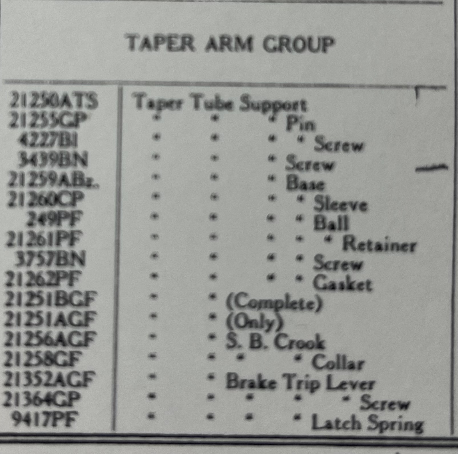

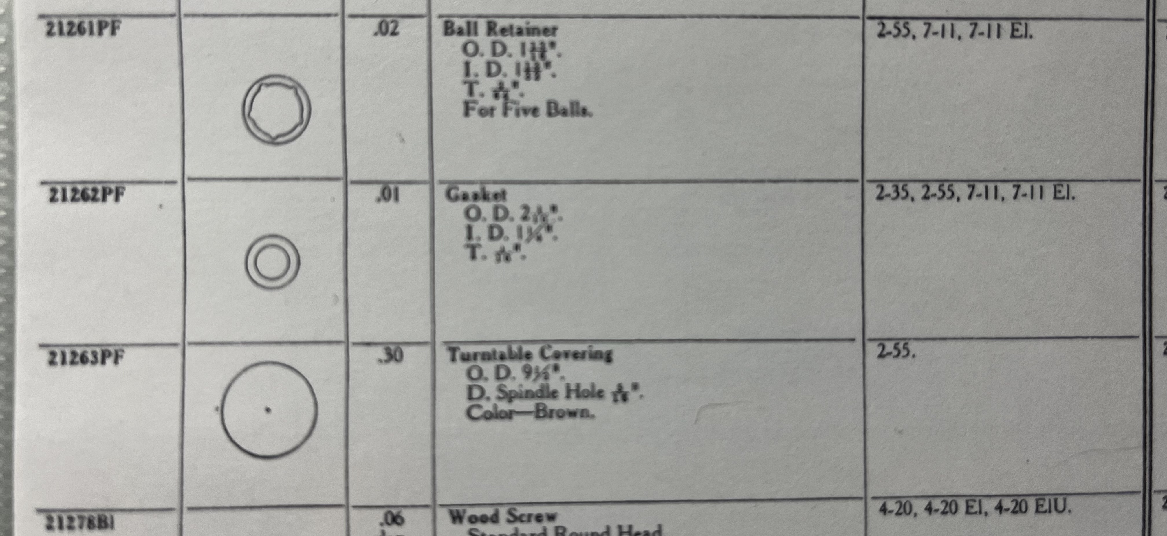

The felt gasket is an original part and when coated with grease it seals the area between the bottom of the Taper Tube assembly and the entrance to the horn. It is not in contact with the five bearings. Speaking of grease, I would recommend a much lighter coating on the balls as heavy grease will prevent the easy rotation of the Taper Tube in the support and this will lead to record wear, plus, the grease will stiffen with time and exacerbate the issue.
Below is the 2-55 part listing showing the felt gasket and also the specs for the felt gasket. If you had a penny and a Wayback machine you could go get a spare. 😁

Lah Ca
Posts: 1391
Post by Lah Ca »
MarkELynch wrote: Wed Aug 13, 2025 10:28 pm The felt gasket is an original part and when coated with grease it seals the area between the bottom of the Taper Tube assembly and the entrance to the horn. It is not in contact with the five bearings. Speaking of grease, I would recommend a much lighter coating on the balls as heavy grease will prevent the easy rotation of the Taper Tube in the support and this will lead to record wear, plus, the grease will stiffen with time and exacerbate the issue.
Mark
Thank you again.
There is also the composite cork gasket between the ball race cup and the motor board. But without reference to this actual item in hand, I would guess that this composite gasket's dimensions are larger than those given above for the felt one. So the ragged felt one in my machine is probably original then. There is probably a different part number for the composite gasket.

Lah Ca
Posts: 1391
Post by Lah Ca »
Hmmm....
I was wrong.
I dug out the composite cork gasket that I salvaged from my 1929 machine and measured it. Its measurements exactly match those of part number, 21262PF, the gasket listed above. This gasket forms the seal between the base of the arm assembly and the motor board.
The diameter of the felt washer/gasket found under the bearing spacer in my 1928 machine is closer in size to the spacer, much smaller than 21262PF.
So back to the questions:
