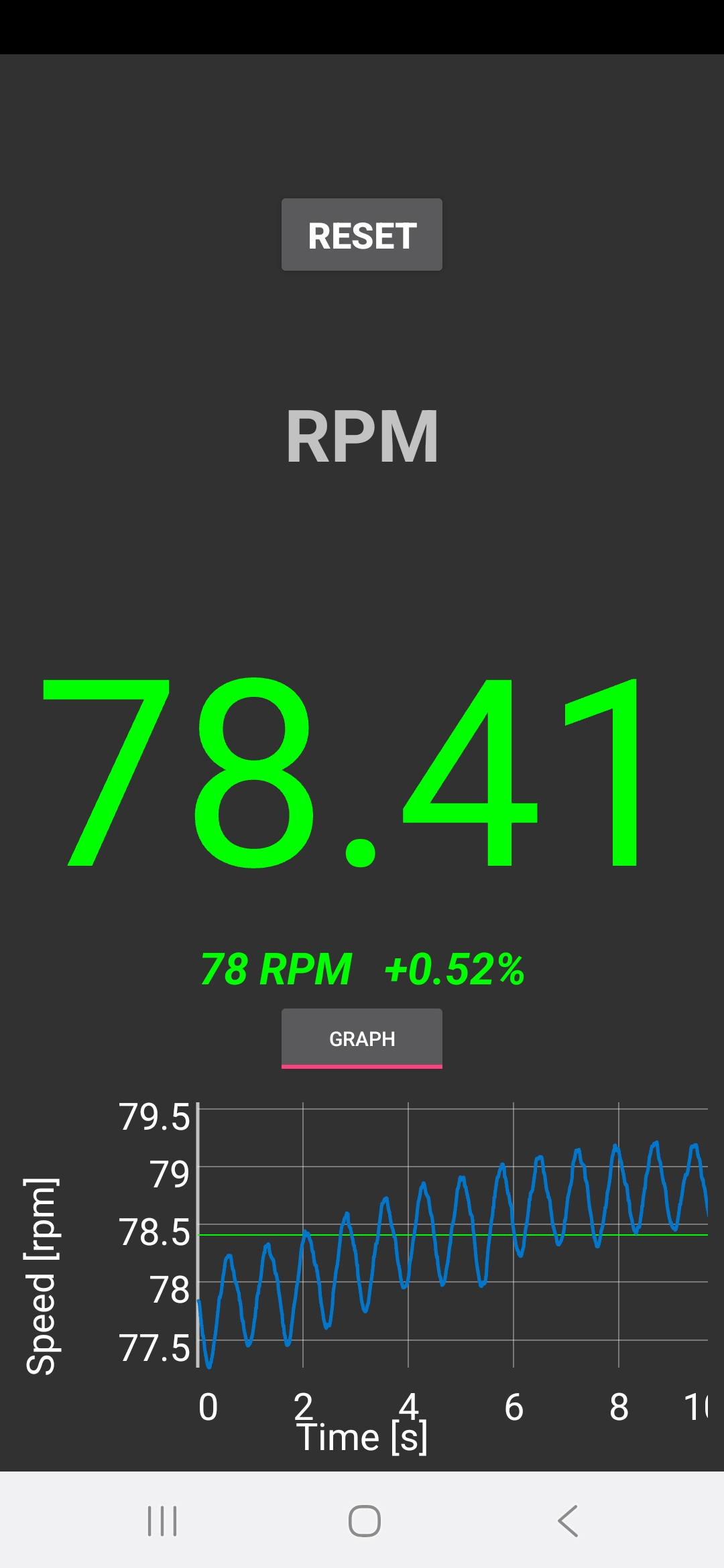

News? I don't know, but it was to me, until I watched a YT video from "Victrola Collector". I believe the iPhone has to be newer than the iPhone 14, but not certain of that. As an FYI, I have a Samsung Galaxy S22.

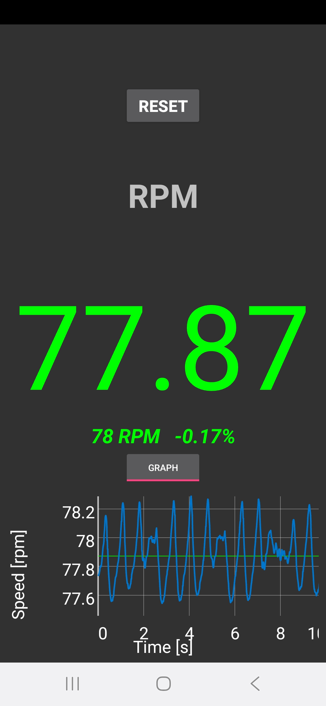

I was playing around with the app, and tried it on my VV-VI and my VV-XIV. Here are the results after my first try. I hope you find this interesting.

There are a couple. I got the Android app, "RPM SPEED AND WOW". There are others and they may be better - I only tried this one. As for the iPhone, I don't know if this particular app will work on Apple's OS, I understand that's an apples and oranges thing with Android, but I know from the YT video by Victrola Collector, he used an iPhone.PeterF wrote: Fri Aug 22, 2025 2:34 pm What’s the name of the app, and is it the same for both platforms?
