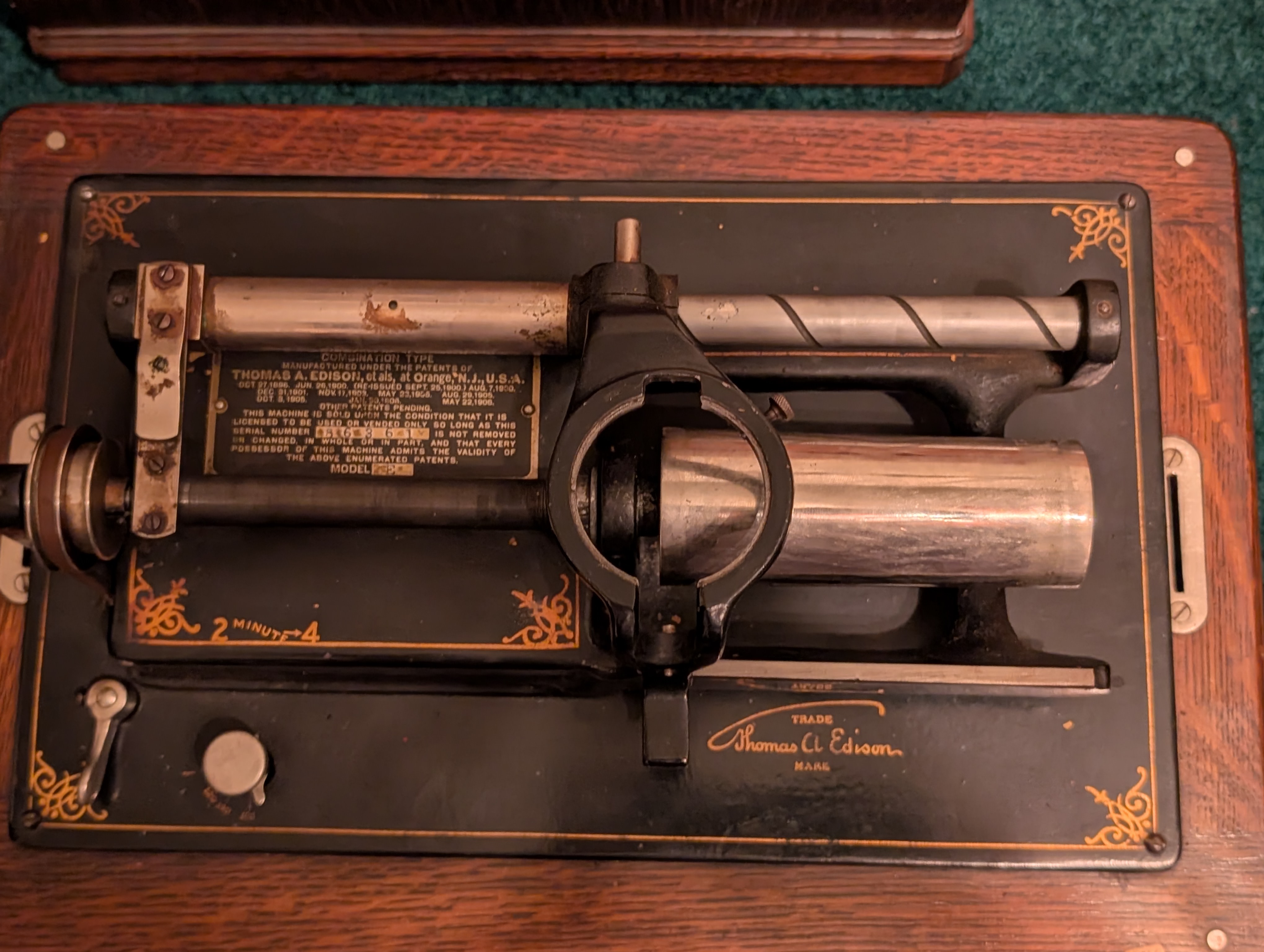

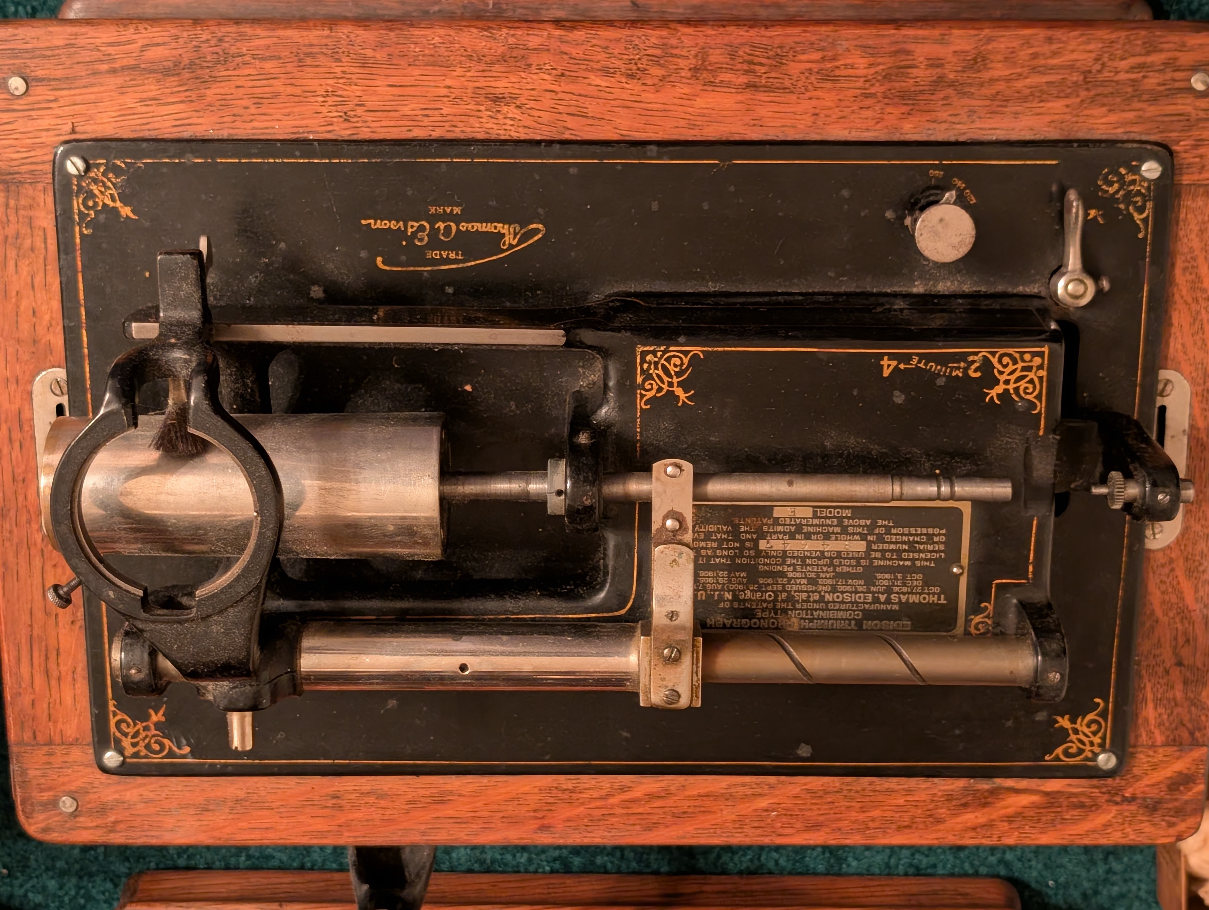

Dad had 6 Triumphs. In trying to figure out the models, I came up with the following:
Triumph A 30888
Triumph B 51197
Triumph B 60179
Triumph B 67608
Triumph F 84647
Triumph G 86361
My logic went that A was obvious, anything else with an end gate had to be B. F included model on the plate, and the last plate didn't have a spot for the model, so I guessed G. How sound is my logic? Does it make sense that B would span from serial 51197 to 67608?

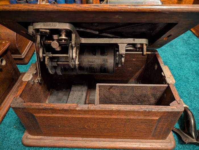

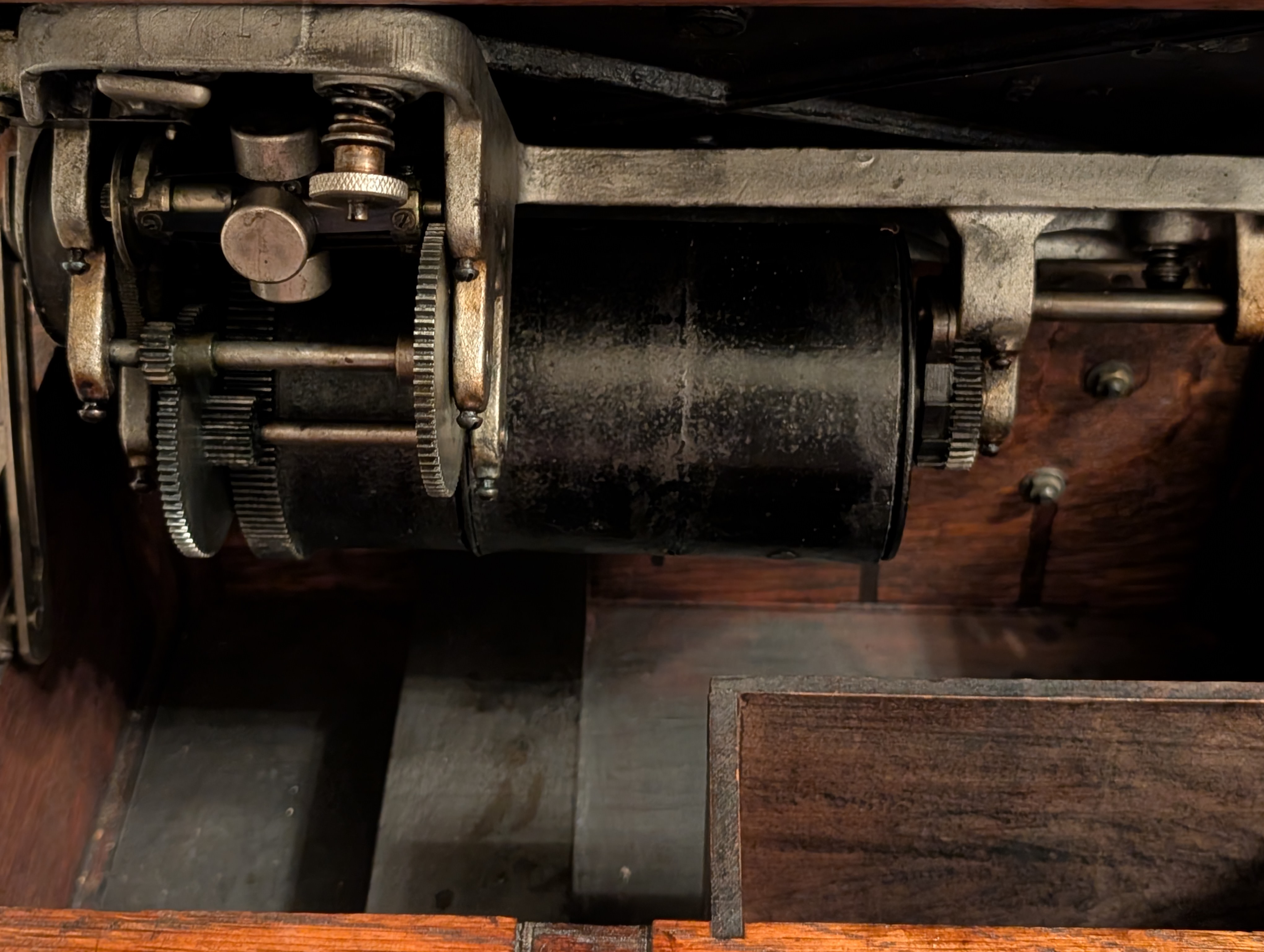

Thank you so much edisonplayer and Chuck. I think you solved my mystery! If they are both E, do these undersides make sense?edisonplayer wrote: Sat Nov 15, 2025 8:18 am The serial number on my Triumph E is 88440.edisonplayer.

Yes, they are both Triton motors.
All Triumphs from Model A through Model E and the earlier Spring Motor model used that motor.
