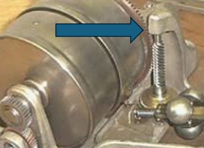

There's yet another problem-- we got the spring repaired and the motor runs just fine by itself. When I put any turntable on it (even if the turntable is not yet the correct one) the motor immediately goes dead. It doesn't want to turn at all. When I press on the spindle when it runs without a turntable, it doesn't take much force to stop it. It is wound as tight as I am comfortable winding and the motor is greased and oiled properly. The only thing I can think of is a weak spring or a gear rubbing somewhere. Any ideas?

- Couch Potato
- Posts: 159
- Joined: Fri Oct 02, 2009 4:36 pm
- Location: Fort Worth
Re: Questions on a Victor P1
There should be a ball bearing at the bottom of the hole for the spindle shaft to rest and spin upon. Make sure it is there...........many times if the motor has been taken apart it can go missing without one realizing it........or the old oil has become tar like............
- Attachments
- Ball Bearing.jpg (25.43 KiB) Viewed 3540 times
