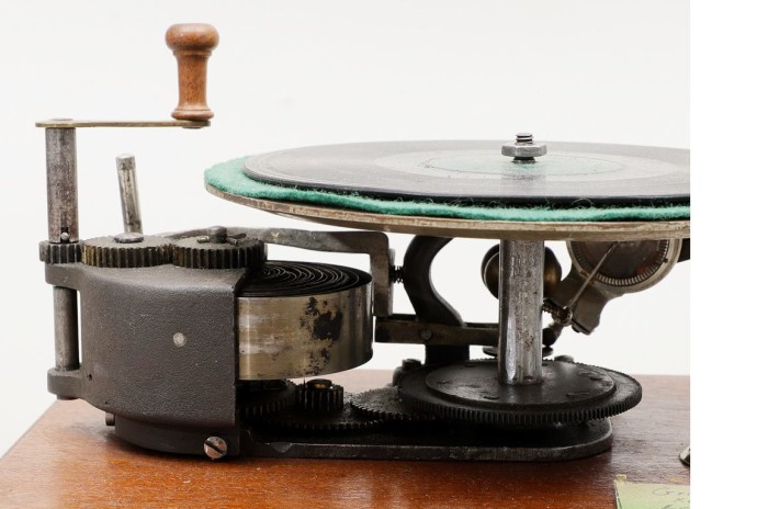

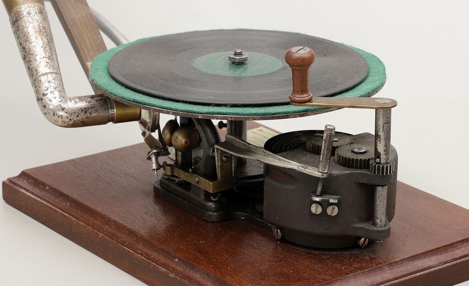

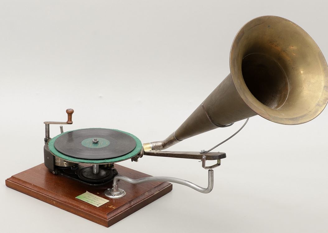

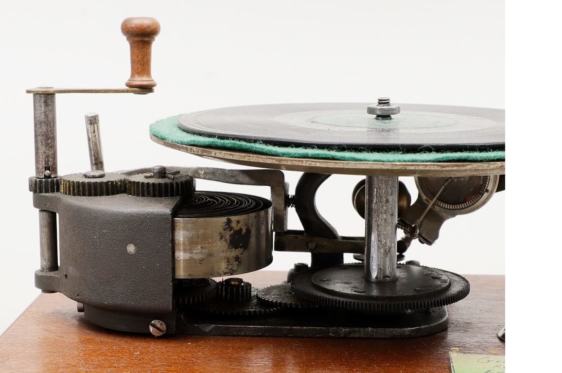

Here an interesting construct trying to fake it as a style 3 sold by Carl Below.
The motor is from a model 4
- brake though is modified
. horn from cylinder phono

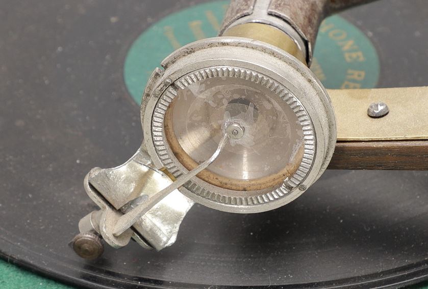

- reproducer :shock: edison c or h??
- other bits on the newer side
Carl Below was the founder of Mammut & did sell a style 3 for a short while with an Ivorine plaque that looked slightly like this. The Carl Below style 3 is undoubtedly the basis for this thing! I have one in mint condition & regret posting a pic a few years ago, if a copy / fakery like this is the consequence!

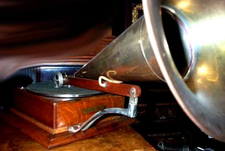

This is the model 4 - which has this style motor

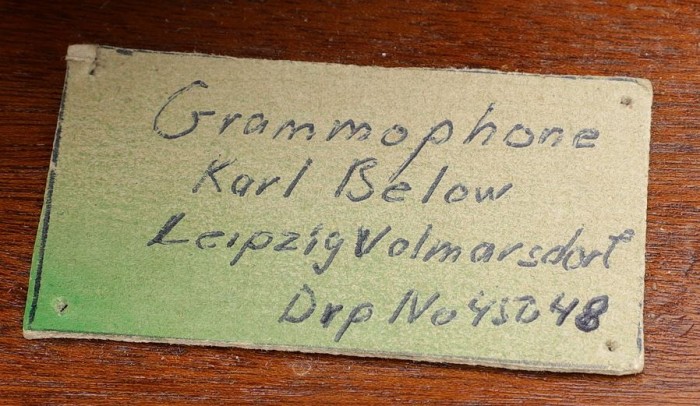

:D the adapted Edison reproducer is extraordinary. Are we supposed to think that the cardboard plaque is original? With its clumsy writing in ball point pen and ‘Karl’ misspelt.
Jamie
Posts: 3963
Re: Junior Monarch - Model 4 (HMV Gramophone) : hot mess frankenphone
Post by Steve »
jamiegramo wrote: Mon Mar 16, 2026 5:05 pm :D the adapted Edison reproducer is extraordinary. Are we supposed to think that the cardboard plaque is original? With its clumsy writing in ball point pen and ‘Karl’ misspelt.
What? That's the one part which looks totally authentic to me! :lol:
