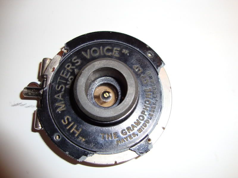

Yesterday I wanted to open an HMV No 4 soundbox with the intention of replacing the gaskets. Unfortunately I haven't been able to separate the front from the back. Since I believe it's a brass soundbox (there are no potmetal cracks present) I don't know why I can't do it. I put it in the freezer overnight to see if that would loosen things up, but when I tried to pry it open with a small screwdriver only pieces of the back snapped of. So I'm afraid I ruined it. I have another back laying round that belonged to a potmetal nr 4, so if I manage to get the back of this one without causing further damage I hope I will be able to get the other back on and save this soundbox.
Any ideas on how to proceed? The back is still stuck!

Bart, save yourself a lot of time and wasted energy and simply buy a brass No.4. That is an all pot-metal soundbox you have there and you'll never separate them successfully. The 'other' back will also be distorted and will never sit right into the 'first soundbox' front bezzel. I say go brass all the way. They're cheap enough to buy on Ebay and very common too, which is a good thing.
The only snag is that the pot-metal ones are chrome plated whilst the brass ones are nickel. Presuming the machine has chrome fittings, will mean that you will have to get the nickeled brass bezzel chrome-plated somewhere?

I suspect the rubber gaskets have stuck to the metal and glued the pieces together. Since this reproducer is now largely ruined it won't hurt to experiment. Soak the whole thing in a solvent like lacquer thinner and see if it loosens up. It will probably strip what is left of the paint.

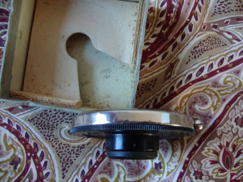

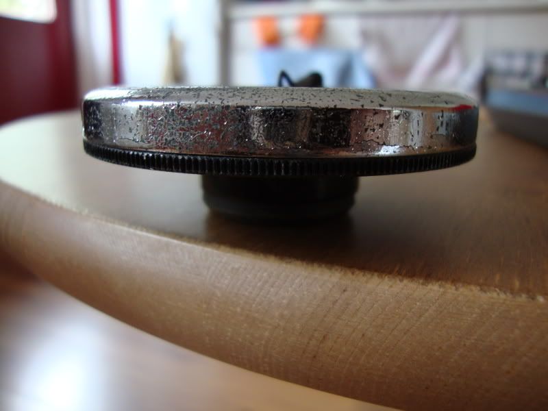

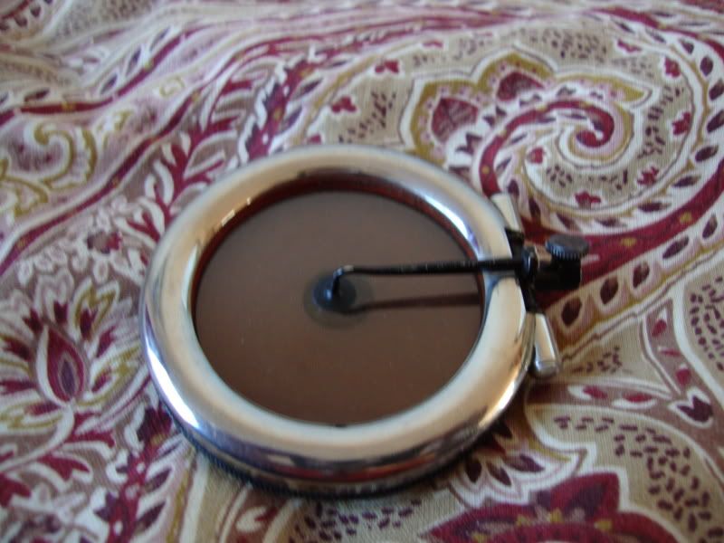

Which brings me to my next point. How to tell the difference between a brass and a potmetal reproducer? I always thought potmetal reproducers looked like this:
But what about this reproducer I bought on Ebay last year. It came with it's original box!
Is looks to be in pristine condition, and it sounds pretty decent too. But is it potmetal or brass?

The one in your last post is pot metal.

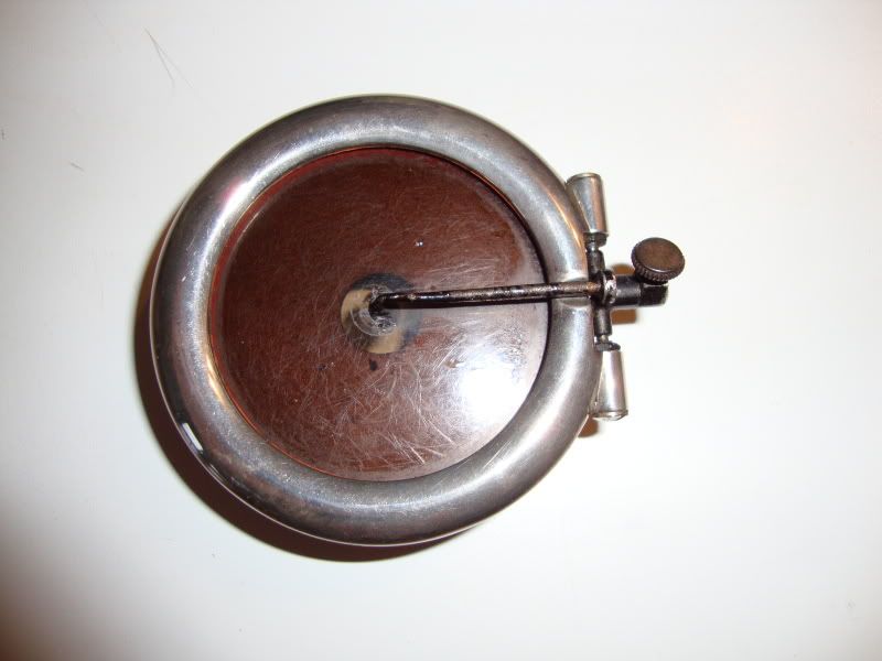

The easiest way to tell is by looking at the rubber flange gasket at the back. On the one above, the rubber extends "past" the metal tube that the rubber grommet is mounted in, but all brass No.4's will have that rubber grommet flush with the metal casing, as pictured below on the left.
To be really sure, you can always get the earliest version where the soundbox information is visible through the mica diaphragm, as pictured below on the right. The ones with writing behind the mica were never made in pot metal, so you'll know it's definately brass if that is the case.
