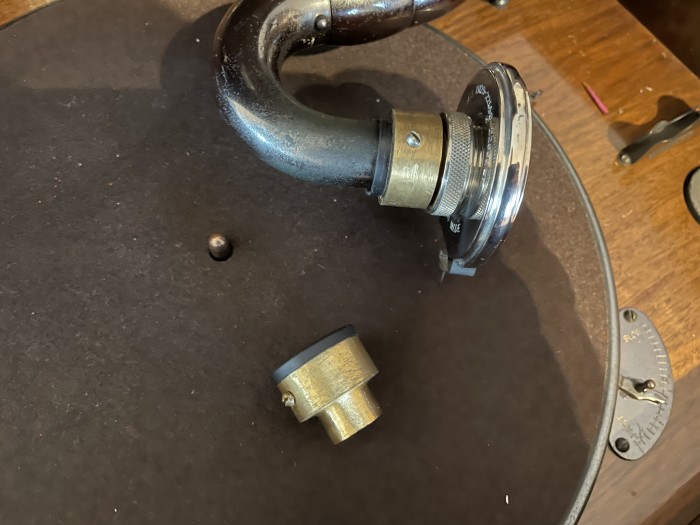

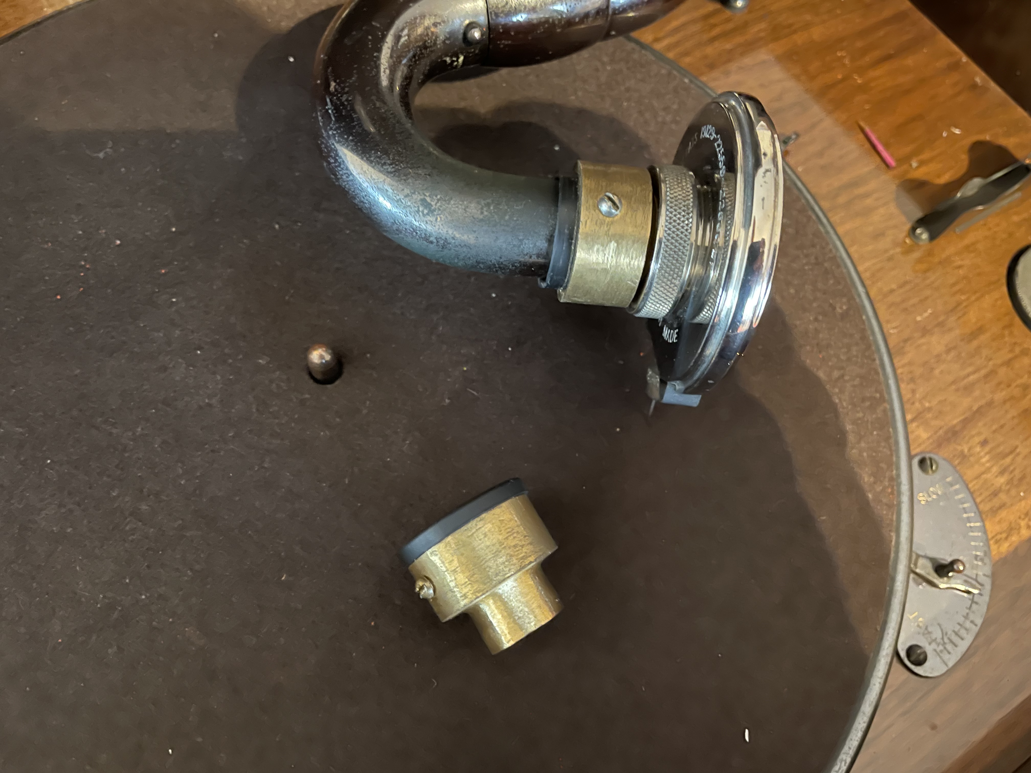

Menophanes wrote: Thu Aug 12, 2021 3:39 am
Thank you for the suggestion. I tried it yesterday, only to find that the box would not fit onto the end of the tone-arm even with the compression-ring completely unscrewed; the red rubber isolator was merely being squeezed down into the body of the box, and I felt there was danger of serious damage if I persisted. And yet you have clearly been able to do this. Obviously I am missing some point, but what can it be? Is it possible that the Meltropes were manufactured with different isolators for different gauges of tone-arm, and that mine happens to have been tailored for the narrower 1925–1929 type?
Oliver Mundy.
yes, Oliver, there are two gauges of rubber isolators, one for the thinner arms and another for the HMVs. Your sondbox certainly has the thin one. These isolators are normally advertised on EBay.
