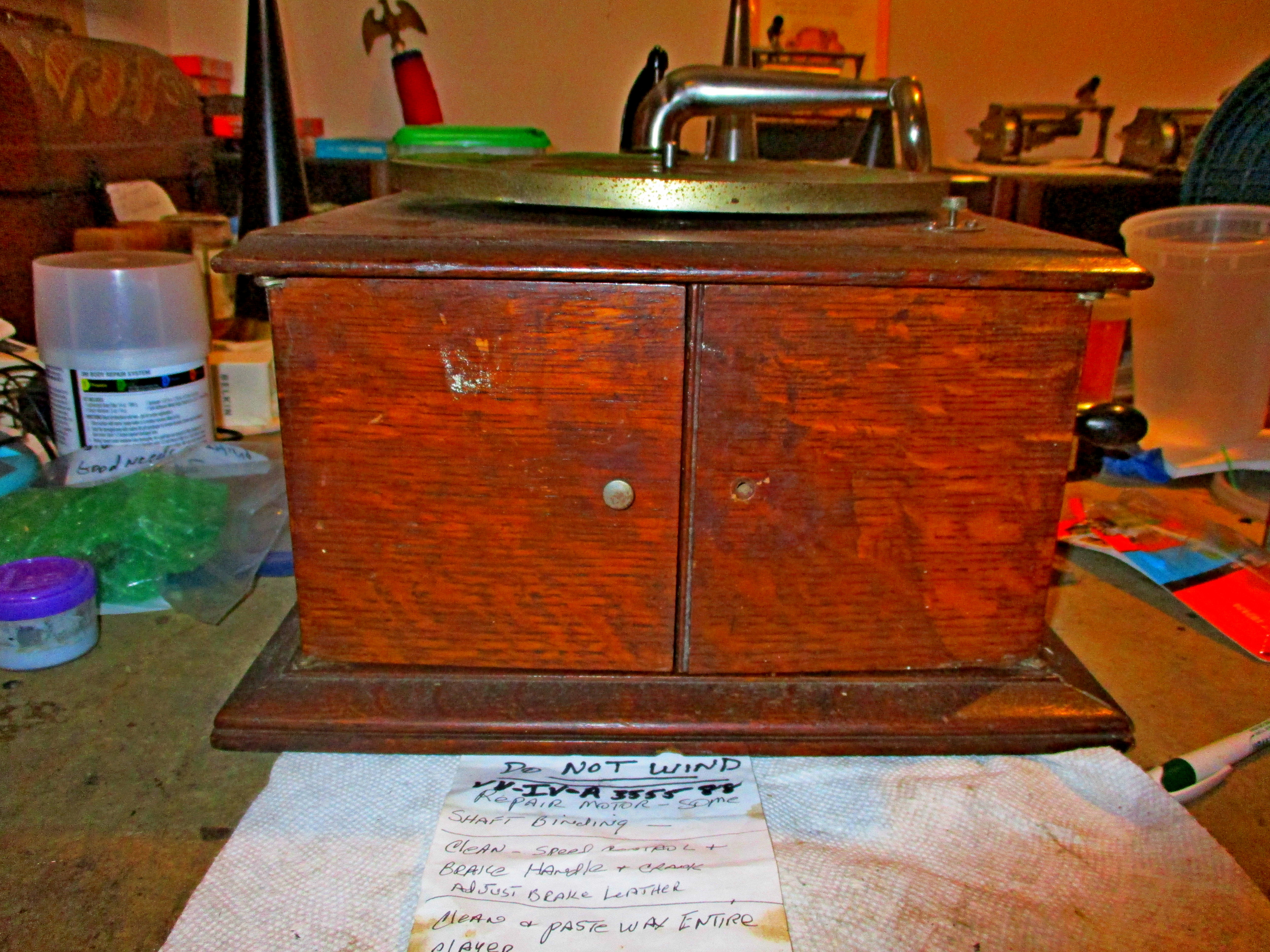

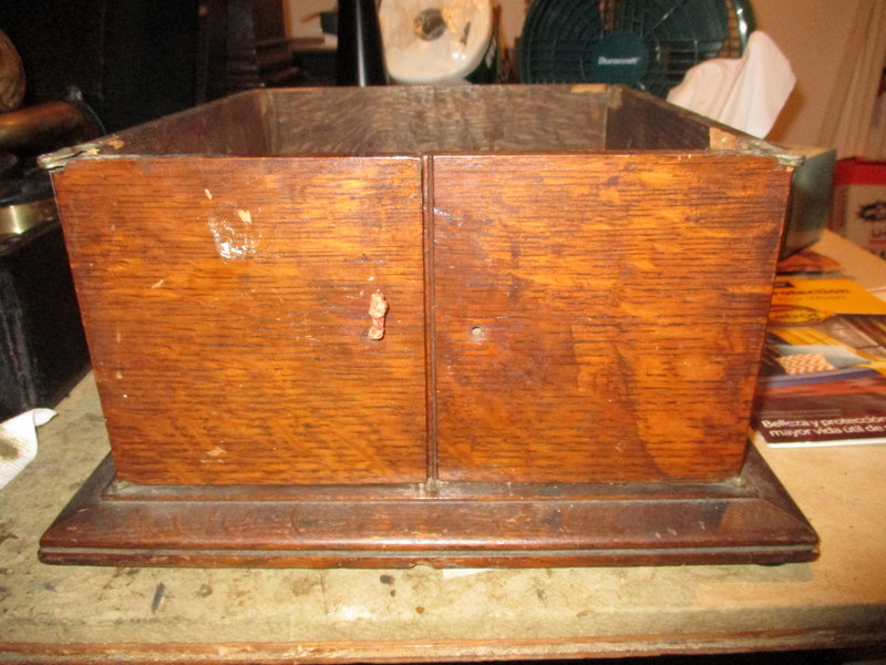

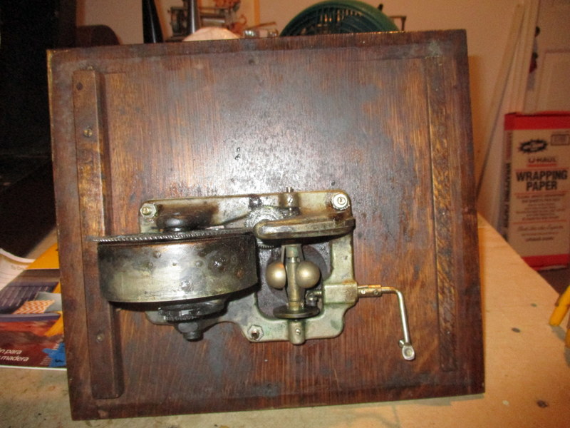

Thanks to everyone for their replies and advice. I was trying to clean up old grease using wd 40 not intending to use it as a replacement for grease. I will post some pictures here but you need to understand this machine was mostly a total wreck when I started work on it. I am just trying to salvage what I can of it to be saved for future generations and to learn some stuff along the way if possible. This battle is far from over at this point but I will follow all advice on here when I get back to working on it, this is a 1917 machine-made without sound deflector slats. As someone suggested there may be some bent shafts involved in my problems, I could just look for another motor but that would be too easy, wouldn't it? LOL. Thanks again, guys.

The way I find to get an idea whether my mainsprings are good still is to take the spring out of the barrel. You will have to run the motor all the way down, remove the governor, remove the spring-barrel from the frame, and get that spring out of there. Everyone has different ways they prefer to work on this, with some folks liking to let the spring unwind into a gunnysack and others preferring to put the barrel in a vise, face up, and work the spring out that way round and round until it's out.
When the spring is out of the barrel, remove the arbor from the center coil so you don't lose it, and lay the spring flat on a tabletop or a smooth cement floor. You should be able to tell if it's powerful or not; a spring with enough power in it should be laying in wider coils on the ground, while a weak spring will lie flat in a tighter coil not expanding as far as a nice fresh one. Victrola springs are thin, making them very easy to wind up. This is great, but a lot of them will crack or break. I had to troubleshoot my first Victrola and found one of its mainsprings had a big crack in it, only half way through, where a chunk of hard graphite grease had fallen between the coils. Cranking the motor had crushed the coil down on top that big quid of grease and split the second spring. I wouldn't have noticed that unless I got in & worked on everything--replacing the cracked spring with a good quality used spring made the whole thing work. Had I not been a broke high schooler I'd have put in 3 fresh ones, new production. Oh well, it's about due for an oil change and I may have to get some springs anyway just to boost performance.
This will let you visualize how potent your spring is. If it's in good shape, clean it up completely & put it back in with fresh grease and go from there. If not, try for a fresh spring.
